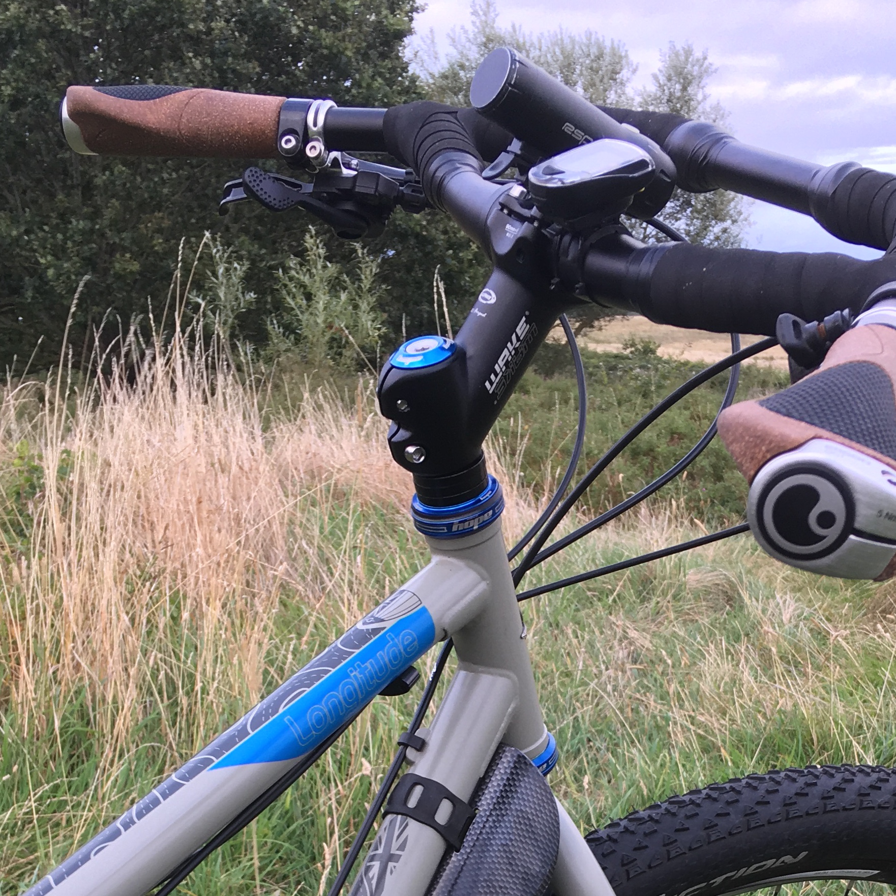

Posts: 3642
Before I went back to a sensible 90mm I tried this ‘Wake’ monster
Cheep and cheerful. Made me feel Dutch.
Christ it’s a shocker. And that light pointing down, what the heuh!
