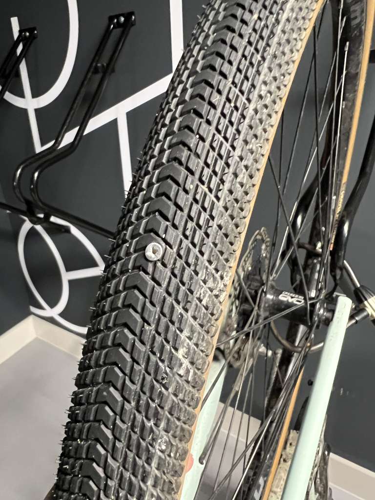

IMG_2088Not sure what is keeping this inflated, sheer willpower from the rider I think
Posted : 10/01/2024 7:28 am
