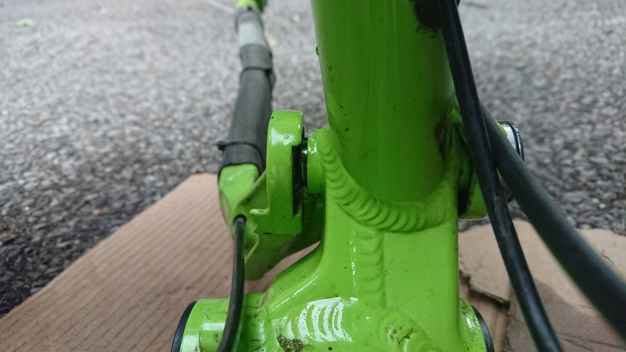

Here's the drive side, with the bolt partially inserted:

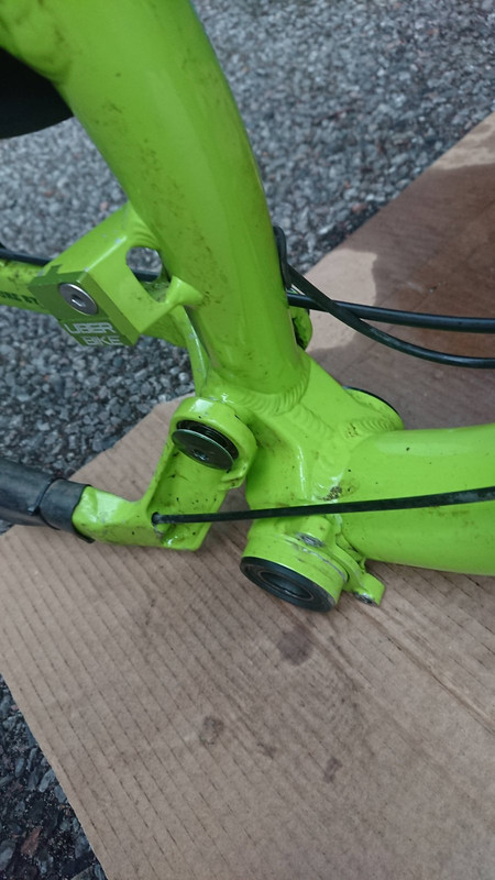

After a lot of effort I've got the pin partway out. Notably the bearing has come out with it. The bearing can also now rotate around the pin:

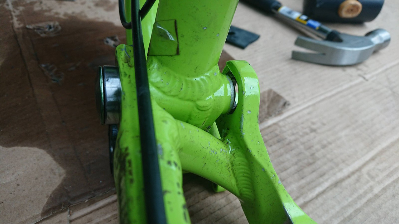

And this shows the pin still protruding slightly out the drive side:

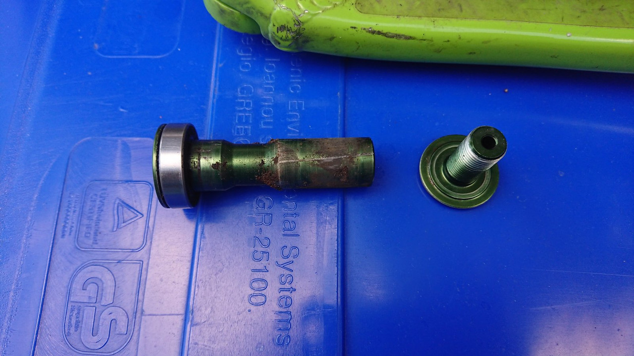

Finally got it! I think loosening the other pivots helped in the end actually. As did buying a slightly longer threaded rod.
Clearly there's some corrosion (and a bearing still stuck to it) but most surprisingly lumps of dirt too. What looks to have exacerbated the problem is that my dropper post grommet has partly split, so no longer creates a proper seal. Anything that gets in there falls down the seat tube right on to this pin. And there's no holes below it, so nowhere for it to go.
