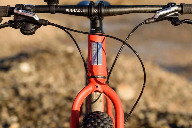

I need to order either a set of new bearings or, if not too expensive , a new headset for my bros bike but it's 50 miles away and I forget the details . I've googled and although I have some idea of the type/size , I'm not certain so wondered if anyone could advise? The current headset has little info except FSA ZS3 but Google comes up with several different models . Also I can't remember if the fork has a straight or tapered steerer . If anyone can help with the info I require it would be much appreciated Headtube

Posts: 9306
Straight steerer with 44mm ID head tube so any Zero Stack headset for 1 1/8" steerer will fit
eg FSA no11 here - https://www.fullspeedahead.com/en/support/library/documentation?category=139 - can download pdf diagram for bearing spec
but I can't remember if it had semi-cartridge or full sealed bearings now

Posts: 497
Thanks Jameso... May I just  query whether the bottom of the headtube definitely has 44mm ID as it appears flared and wider at the bottom .. at least externally  ( tapered headtube? ) I'm not up to date on headtubes / headsets  as most off my bikes have been steel with standard external cups etc.

Posts: 9306
That's just external wall thickness taper, a visual trick to help it work with an external ZX44 lower cup if a tapered sus fork was fitted. It's defo 44mm ID top and bottom. Kept it simple.

Posts: 497
excellent .. thanks for explaining and clarifying .. much appreciated..

Posts: 9306
NP...
Oops sorry, XX44 external lower cup, not ZX44. There is no ZX44.
