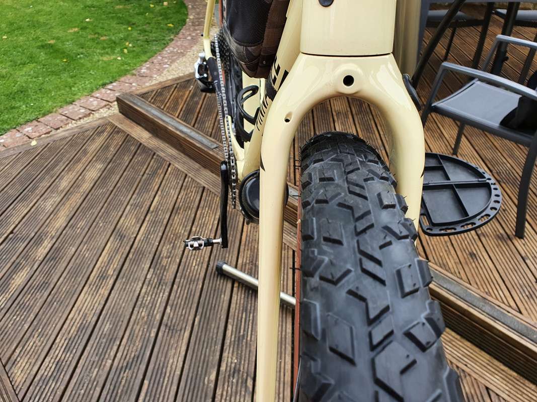

Posts: 517
This my 2019 Arkose X with 50mm 650b Pirelli cinturato's on i25 WTB rims. Come up as 52mm. Decent clearance.

Posts: 9824
luv2ride yes that's the new wider fork with slightly green eyes. Which kind of shows the limitations of the older one

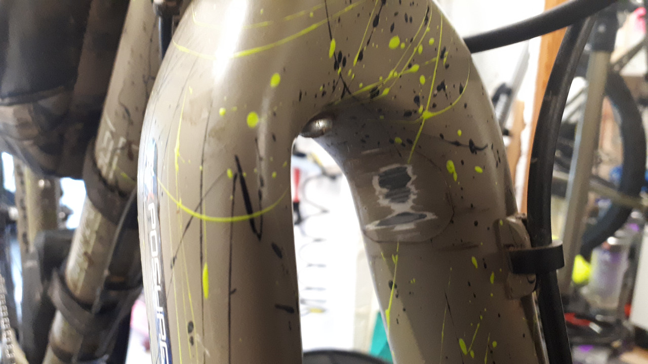

Posts: 517
This was the result of running 40mm tubeless Nanos on my 2015 Arkose fork, hence why I went to the 2019 X
The older bike now runs tubeless Gravel King SKs 700 x 38mm with no rub...

Posts: 9824
That is so useful to know. I have 38c gravel king 3k on mine. I wondered about whether raptors would fit. Now I know. Although I think the 1x model was sold with them
Posted : 25/09/2020 6:04 pm
Posts: 4062
I think I'd happily give up 2mm for that rad splatter paint job!

I'm thinking of swapping the fork on my Arkose 2016 to one with more clearance.
Probably this one https://www.kinesisbikes.co.uk/Catalogue/Forks/Adventure/TRIPSTER-DISC-TA
The aim being to be able to run bigger tyres. So am I thinking that I would be able to run up to 50mm on 650b and 45mm 700c?
Is 50mm 650b a big step up in "suspension"? I'm currently running 40mm 700c?
This has been prompted by a mate suggesting we try Oxduro this year (but with the reality we might have to cut our losses and head for home or cut a corner). Too far on the road for an MTB but enough off road to want a bike that is happy on Chilterns single track and the Ridgeway etc.
Any thoughts appreciated
I'm running Hope five20 and have end caps so no problem there. I think I'd have to but a new front brake which is no problem
