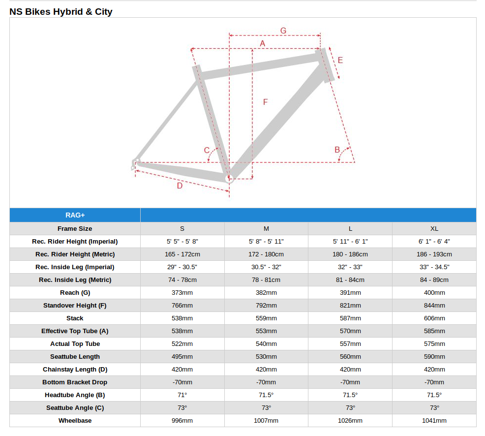

I know nothing beats throwing your actual leg, over an actual bike. But if you can't do that, how do you ensure you pick the right size frame...? So I'm going to buy a NS Bikes RAG frameset off CRC, as it's £510 quid, but don't know if I should get the small or medium.

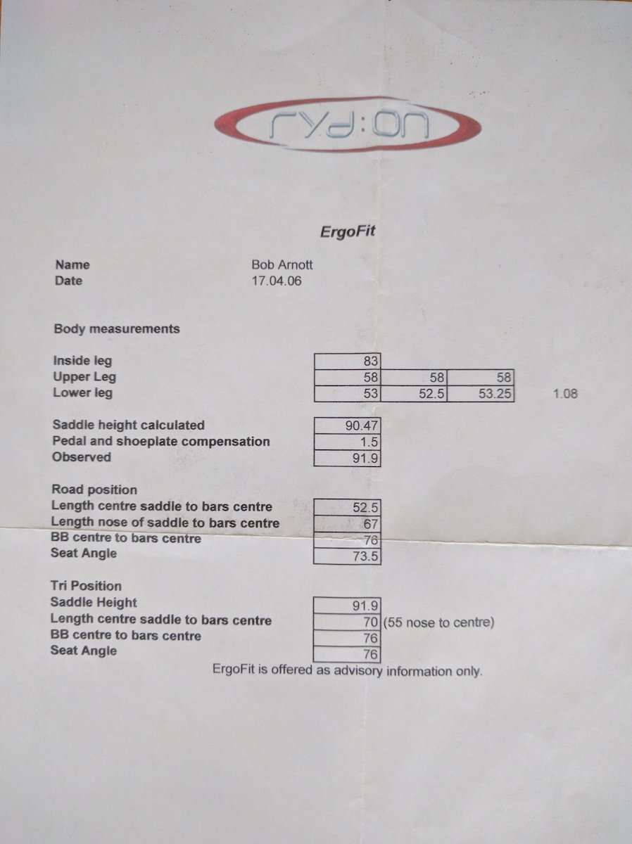

I had a bike fit for my old tri bike many years ago, and have these details:
ErgoFit details
Looking at the size chart on the CRC website, my inside leg measurement puts me on a large, but I'm barely only about 173cm tall, so either a small or medium.
NS Bike Rag size chart

You have long legs for 173 cm. saddle height is 0.883x inside leg plus crank length which gives the 90 cm in your fit. Long legs and shorter body says size down. Looking a the effective top tube on that site, you are on the border of S/M. In such circumstances I like to size down and fit with a longer stem.
Either will fit but smaller frame with longer stem will handle better. There is no headtube length listed, but you might think about bar height. Small frames might need a flipped stem.
Those frames look quite large. Medium has a 55.5 effective top tube with slacker head angle (which makes the ETT smaller). Based on that, I’d go small.
Posted : 05/10/2019 11:27 am
You appear to have long legs for your height, so you probably could make medium or large work. That bike seems very compact, but I'm used to seeing numbers for modern trail full Sussers, which are far longer, but with much shorter seat posts. If you have long arms (Google ape index) then go large. Otherwise medium.

It kind of looks like you are in the medium range for reach.
