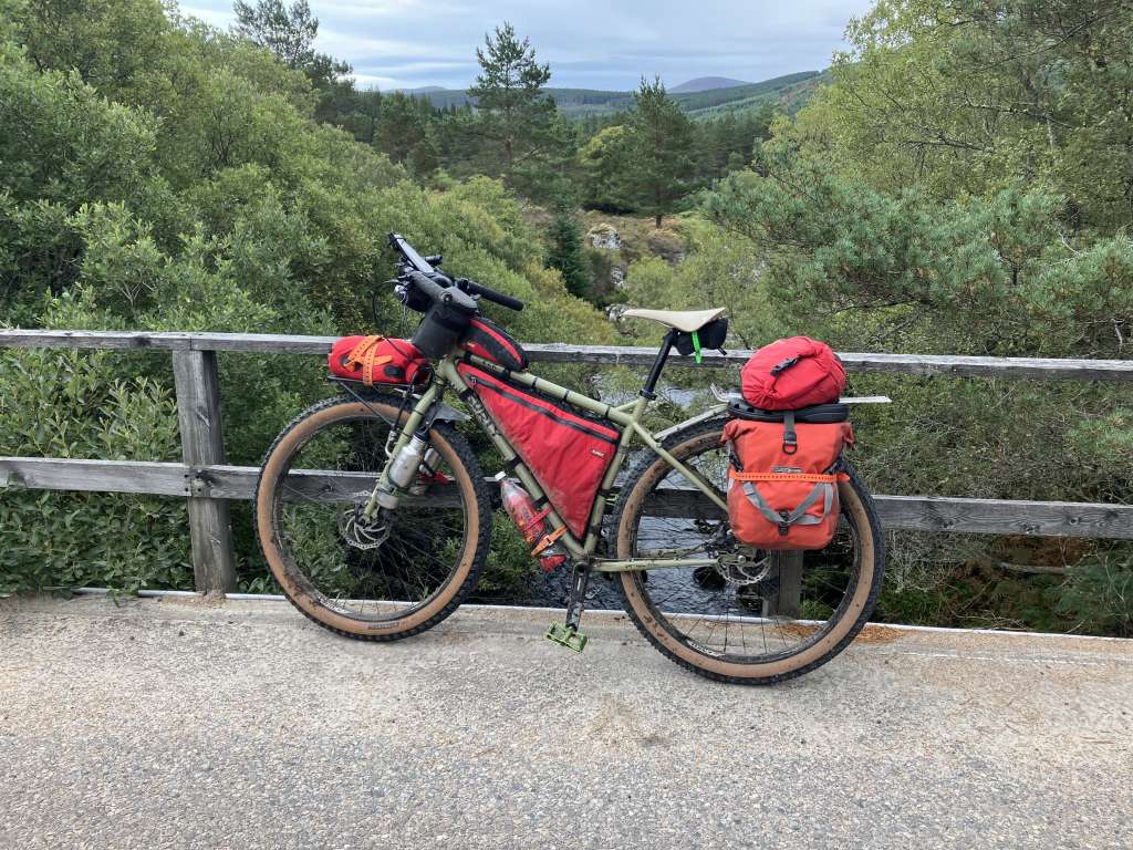

Posts: 712
IMG_1045No.  But with a rack you I just put a layer of something (I use for sale sign plastic) on the rack and that acts at your mudguard.  I have put some between the rack stays too and have a loose bit that I can slide out the back wedged under the tent bag or held on with a voile strap.
Edited to add a photo.  Yes I know I have a lot of stuff.

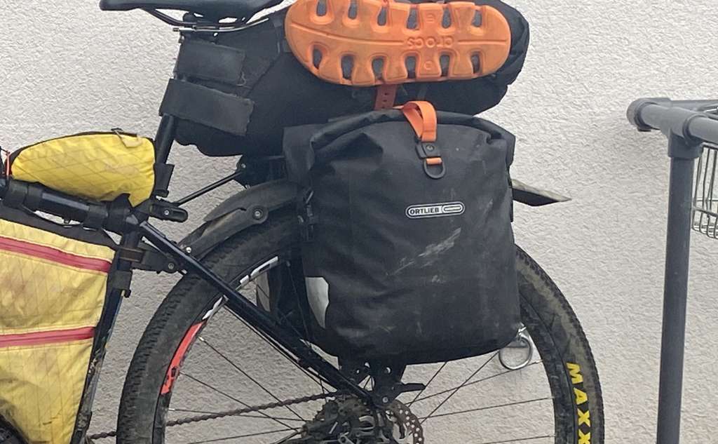

Posts: 1513
I use a SKS Speedrocker that fits under a rack. It’s a very flexible design that can be positioned in lots of different ways.
IMG_6299
