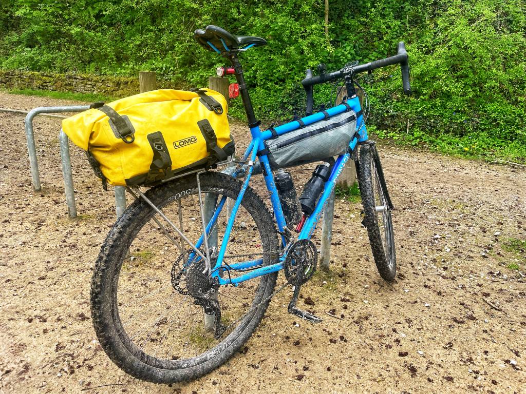

Can anyone recommend a rack with a wide top platform?
I have a LOMO tailbag  https://www.lomo.co.uk/products/15l-dry-bike-motorbike-tail-bag/
When I fit it in-line on my narrower rack it moves alot bikepacking on rough trails, I have to mount it 'sideways' like a caradice bag and strap tightly to the saddle rails and bike frame.

I have that bag. Its fine on a narrow rack if you really anchor the Velcro bits. Loop them round the uprights and tie in place longitudinally. Or I’ve heard of people zip tying the Velcro to the rack
