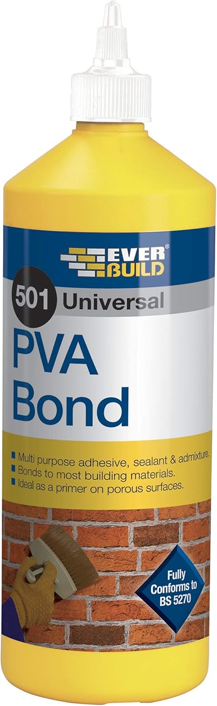

Little correction, it was actually Universal 501 PVA bond:
Still similar to craft glue, that is PVA glue...

Funny ..they were Conti's that were the worst offenders. I've plenty of PVA etc so may try that or just scrub some sealant in beforehand ..looks a good idea anyhow.

I did my conti winter tires with pva . Worked well
Posted : 28/01/2021 12:49 pm
I was going to recommend PVA but I didn't want to sound mental. I did it years ago in the early days of tubeless when tyres and rims were useless and I was also skint.
Just mix it with water and brush it around the whole carcass and leave to dry.

I found latex separated from the tyre. Maybe I didn't sand the surface enough. PVA sounds better.
