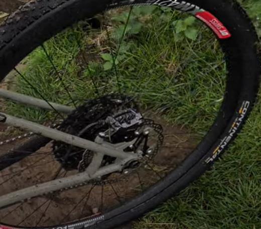

I've got what appears to be the same brake mount on my custom Marino frame.
It's welded on in a far more sensible looking way over a larger area to transfer all the forces over a bigger area of the seat stay.
It runs a 180 rotor with no adaptor but currently got it running a 203 with adaptor.
I live and ride in the Tweed Valley so steep is normal.
No vibrations of any kind with several different brakes on it.
To me I know which one looks like the better way of attaching the mount...
Spread the load and put a brace in the right place to spread it further on to the chainstay.
https://www.flickr.com/photos/stu-b/53532648891/in/dateposted/

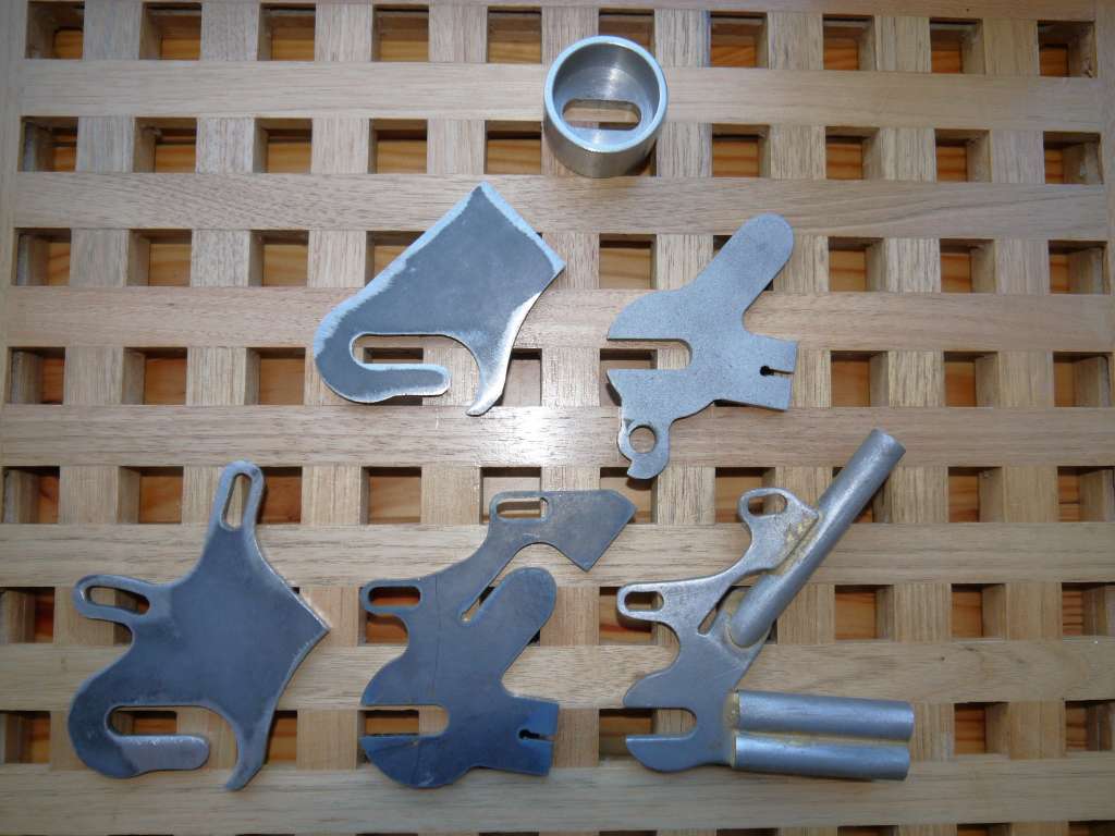

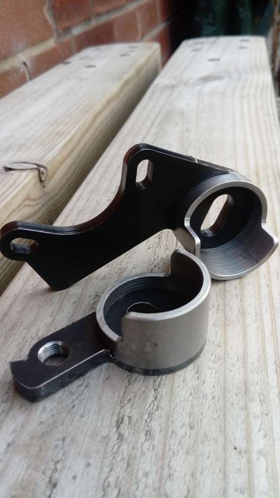

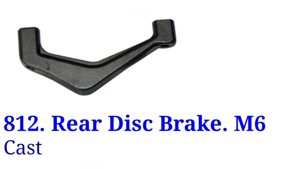

The mount looks to be available at Ceeway so will be used by plenty of people. If there is an issue then it is the attachment method - unfortunately not easily changed if you already have a batch of painted frames.
Screenshot_20250118-201423 (1)
If it was a car manufacturer they'd first look at FEA, but it could also be practically investigated by an accelerometer and impact hammer to determine the natural frequency. Then fit a number of tri-ax accelerometers, log some data during the event and perform a modal analysis / make some nice animations to show what is happening. All of this is a bit out of budget for a small UK frame seller.
ISO is easy - it is basically three radial dimensions and all the rotor size adjustment is sorted by the brake manufacturer. I make so few frames, dropouts are just designed for each one (particularly to suit the seatstay angle) and then zapped out. It is one piece including the disc mount so can never be fitted out of position.
P1000867DSC_0474

My Marino uses the same mount, but look how it's attached - this is with a 220mm rotor. Just left of shot, there's a bracing tube between the stays too, to provide additional support:

Got to say, that just instantly looks like something that's going to resonate and flex (and eventually crack) with the cantilevered mounting just attached with a relatively short weld in the middle.  If someone presented me with something like that in my line of work, I'd need a LOT of real-world instrumented measurements of stresses, and a good hard look at the quality  + QA of welding especially where it starts and ends, before I'd agree to it !

@snotrag Same as the OP's

I love the fact that someone who suggests the spacers on the caliper are in the wrong place when they're not uses the phrase keyboard engineers as an insult. 😀
