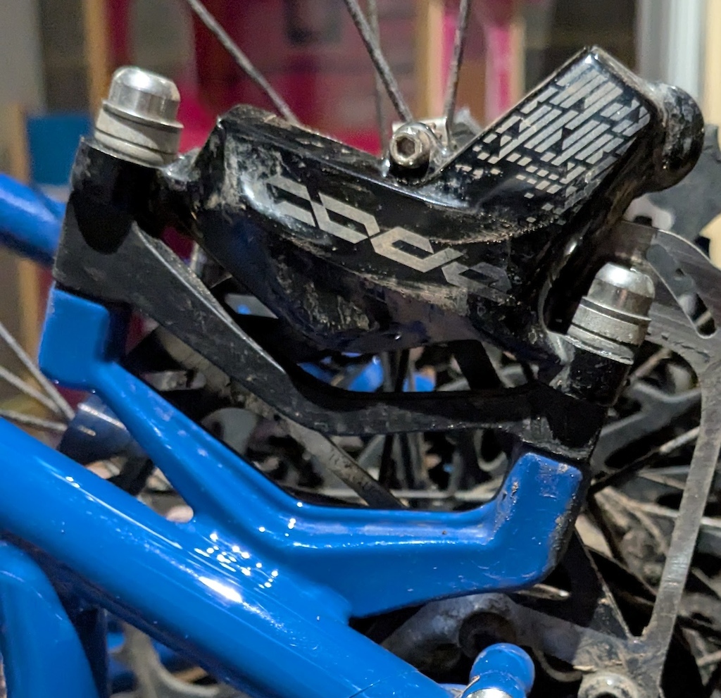

In wet conditions and on steep terrain where the rear brake is under high load, I kept getting the most horrendous resonance through the frame into the pedals.
I cleaned the pads and rotor- same issue
I swapped out the pads - same issue
I swapped the rotor - same issue
I tried a different mount and bolts - same issue
I tried a completely different brake - same issue.
Noting that I'd never felt this on the Squatch, the other thing that had changed was the frame.
I contacted Sophie at Pace to advise on the issue I was having and that I believed the issue was down to the post mount caliper design and believed that under heavy loading, the mount was deflecting and twisting causing my issue. It is my opinion that the mount just doesn't have enough support under the front or rear edge to stop it twisting. I'm no frame designer, but I've been working on bikes for close to 30 years, so have a pretty good eye for these things.
After confirming everything I had tested, Pace agreed to collected the frame and undertake their own review.
Upon receipt, Pace checked everything over and confirmed everything was good and that the issue was with my brake set up and not the frame. I didn't agree.
Pace kindly agreed to send me out a replacement frame, but I declined this as I truly believe the rear mount is flawed. After plenty of back and forth between myself and Pace it was agreed best for all parties that my money be refunded.

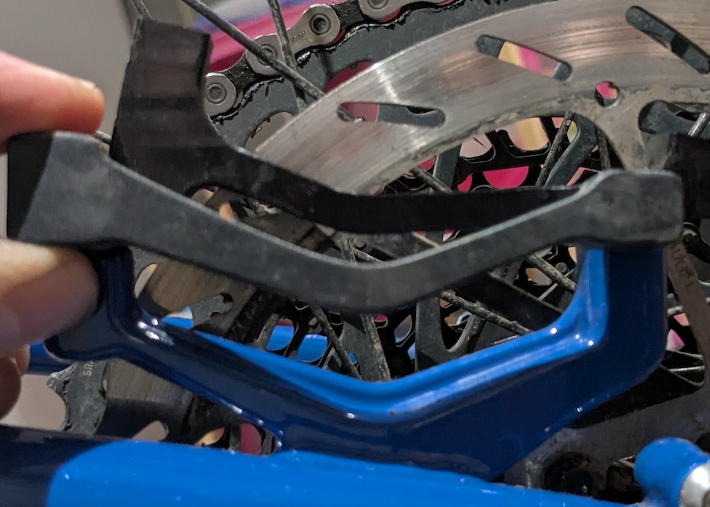

The mount is a little hard to see on the website....but here it is with my 180mm rotor and Code RSC caliper. Using all genuine SRAM parts.
My set-up...
And the same mount used by another frame builder...
I'm not here to slag off Pace, nor am I here to debate this with them on an open forum if they see this. We've both done enough of that via emails. They are of course entitled to stand behind their design and I truly hope I am the only one that finds this an issue.

That mount looks like it is on the wonk - under heavy braking the frame & the brace looks to give no support. I wonder if the demo might've been a pre-production model or something?
Posted : 16/01/2025 3:46 pm
Posts: 33
Not the case - full production model and set-up as other shown in online photos.
Posted : 16/01/2025 4:00 pm

Does look little under supported, but hard today from a photo.
Did you try a different (smaller diameter) rotor at all? Resonance is due to vibration matching the natural frequency of an object. If you change the object dimensions, then the natural frequency would change also, which may cure it.
Posted : 16/01/2025 4:07 pm

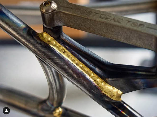

I make my own steel frames from scratch (including the dropouts and disc mount). I also work in a structural durability test lab so do have some experience of stiffness / resonance issues in non-bike applications - they can be a complex combination of variables, so not surprising that some builds are presumably ok for other people . Pace have lots of experience, but I personally wouldn't make a disc mount like that (caveat - I never use post mount anyway as the unfashionable ISO mount is easier to make and more flexible for hub gears and single speed)

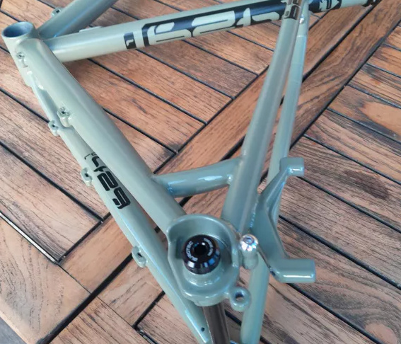

That central welded on brake mount does appear to be a recipe for flex or resonance under braking. Surely the load path is down(ish) a the front of the mount, so any resonance or on/off at the pad/rotor meeting is just going to be amplified?
A quick look at other steel frames and brake mounts, it seems even some with adaptors have a 'forward projection' - but they all are IS to PM via an adaptor. But all have a wider base than the Pace...
[url= https://live.staticflickr.com/65535/54260283460_b6427973f7_k.jp g" target="_blank">https://live.staticflickr.com/65535/54260283460_b6427973f7_k.jp g"/> [/img][/url][url= https://flic.kr/p/2qEN8SC ]Bfe 2025 Gunmetal - Detail Dropout 29er[/url] by [url= https://www.flickr.com/photos/coticltd/ ]CoticLtd[/url], on Flickr

The thing about the design that strikes me is the bracing for the rear triangle isn't connected with the "top" bolt but I'd have thought that's the location of peak load.  I guess there's a reason they've adopted that approach.

I can see Pace changing that mount for the next version, to me its obviously spindly at the front, so much so it would put me off the frame, I've had frames with post mount issues so it's now something I look more closely at, I personally think that's a terrible design and needs to be as thick as the rear section if it's gonna be unsupported like that, why make it that weak at the front when most of the braking force is going to it. It would probably be better if they flipped it. Look how the adapter is made then look at the post mount and where the material is.

You'd think the thicker arm of the mount would point forwards so that when the brake is used the thicker but would move / twist less than the narrower/longer section?
What size discs are you using and what does the frame claim to support?

Looks like an assembly error to me.
I've had flutter induced by the pads overlapping the rotor spokes when not spacing the calliper correctly. or using a 203mm rotor on a 200mm mount.  Easily remedied by adding washers/spacers under the calliper.
Being as you've got the cup washers on the wrong side of the calliper (they don't do anything to help align the calliper if fitted above it) I'd say the the pads are probably not sitting in the right place on the face of the rotor and are catching on the rotor spokes.  That's be what's causing your vibrations though who knows why it's more noticeable in the wet - it's probably the steep bit that's the main factor.
Posted : 17/01/2025 9:54 am

Looks like a poor design for a brake mount.

Being as you’ve got the cup washers on the wrong side of the calliper (they don’t do anything to help align the calliper if fitted above it)
You say this but I've never seen a calliper fitted with the washers below it.

@Speeder
Suggest you check your own setup if you are running the cup and cone washers below.
Posted : 17/01/2025 10:21 am

You say this but I’ve never seen a calliper fitted with the washers below it.
It's a bit of a red herring as it may or may not need them. The SRAM Manual say the that set up is correct but it depends what level the mount it welded at as to whether it sits in exactly the right place and it's up to the installer to get the pads in the centre of the rotor.  This may take any number of washers.  It's well worth some careful set up at build stage.
Manual
Posted : 17/01/2025 10:29 am

Imo, cup and cone above is usual now and ensures the bolt sits flat. The mounts still need to be perpendicular to the rotor. Cup and cone below was the old avid set up and was used take up any variance.

OP seems reasonable enough to me. The way that post mount is welded to the frame doesn't inspire confidence in me, the only disadvantage I can see to welding it on as per OPs other photo is that it may require more manipulation of the seat stay or the mount itself to make it sit correctly.

@someareset - what makes you think that either of those are correctly set up?  They're just tests done by mags not SRAM installations. I do accept they're probably correct as they are fork fitted which is a mass produced item and very likely to be to the exact standards. A frame may not. be.
Was it even considered that something could be set up wrong?

Also, from a stress/bending load perspective. First look at that makes me think "That's awful". Attaching a brake mount on a tube like that, the whole thing will move around unless the tube is at least a couple of mm thick, probably more. I'd start by doubling (or tripling) the surface area between mount and tube. Would be interesting to see how long they last before the weld starts to crack the tube.
AFAIK in that installation they are there to make sure you've got no bending load in the bolt, so go between bolt face and caliper.

My only thought was whether a non straight through +20mm caliper mount might have made a difference. You can get a +20mm mount that bolts to the frame and then the caliper bolts separately to the mount

@dc1988 - Tried the Hope L mount along with an E4 caliper.
In my case, it made no difference. That mount also pushed the caliper up even higher, which I believe puts more stress on the frame mounting locations.

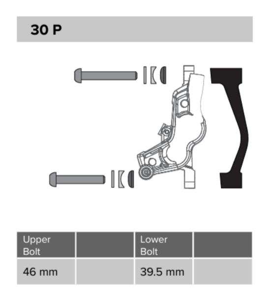

I want to clarify something. The OP's brake caliper, mount, and washers, are fitted correctly.
I'm reposting their picture on this page for clarity:
p5pb27690710
And an extract from Srams document "disc-brake-caliper-mounting-specifications-for-road-and-mtb.pdf"available here; https://www.sram.com/en/service/models/db-mthw-a1
Caliper fitment
The cup and cone washers go outside the bracket.
These brackets use long bolts, that pass through ovalized holes in the bracket. The caliper moves outwards, but also at an angle, relative to where it would be fitted directly to the frame with a 160mm rotor. The post mount brake standard is not radial mount.
You can see clearly from the silhouetted shape in that diagram, the mounting plane of the frame for 160mm rotor is NOT parrallel to the final mounting plane of the caliper for 180mm rotor. Ovalized holes, with cup and cone washers allow this to occur. Otherwise we would have a bent bolt.

Seems like a fair and informative post to me. That brake mount does look crap and I bet they change it for the next batch.
All that load on a base which narrows on its way to the frame looks like the opposite of what you want. I am obviously not an engineer.
