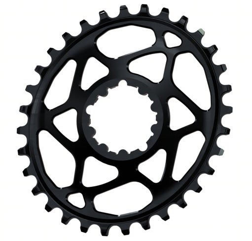

Rather than debate the theory and talk about Biopace, I thought this could be a thread that gave ride impressions on the new batch of narrow-wide 1x oval rings that are surfacing.
Seems like a reasonably cheap and simple way to test it all out.
These are the ones that I know about:
Absolute black:
Bionicon's B Lab:
Anybody running them?

Yes In running a 4 arm Absolute Black Oval - Running both either single speed or with a Internal gear Hub
The AB is propper lush, runs very smooth (smoother for me that the BETD One Key) Not tried any others

On my SS the benefit I notice is when spinning up to attack a climb - it's faster and smoother.
But I suspect there is a continuous JRA benefit, perhaps less noticeable.
The theory makes perfect sense to me - we evolved to step or run, not move our feet in perfect circles.

I've used goldtec but they don't play nice with clutch mechs, waiting for my AB ring
How are they different, that one works and the other doesn't?

chain growth is different between rings depending on profile
Posted : 16/12/2014 10:10 am
How do the singlespeeders cope with the chain growth?
Posted : 16/12/2014 10:19 am
Posts: 10340
Is there any chain growth for singlespeeders?
If the rings are symmetrical, then surely your feeding the chain back at the same rate as your pulling it?
Or have I got that completely wrong?
Posted : 16/12/2014 11:02 am
Posts: 920
Not clear on your question. The chain doesn't grow. At any specific location, chain tension does vary throughout the pedal cycle, I set the chain slack to be acceptable at that point. It works.
The rule of thumb is to be able to spin about 2 crank rotations by hand. Less than that and the chain may be a bit tight.
Posted : 16/12/2014 11:03 am
What does that mean?
so do you have to leave the chain slacker than you would normally to take up some slack at the worst point?
Posted : 16/12/2014 11:19 am
Posts: 920
It means you use the point of tightest chain as the benchmark to set the chain tension.
It's possible with some rings the overall chain tightness varies throughout the cycle, with others perhaps chain tightness at one point (e.g. top) is counter balanced with looseness at another (e.g. below). I'm not sure, depends on the ring design I would think.
Posted : 16/12/2014 11:27 am
Posts: 920
BTW even with a round ring, tension usually varies throughout the cycle. It's easy to observe if using a sprung tensioner, it moves.
The goldtec and AB rings are all about the same % oval so chain tension won't vary between them. The main difference between them is where the max radius is in relation to the crank, it's a bit later in the pedal stroke on the goldtec from what I can see, about 15 degrees past the others.
Yes slacker when min radius is at ~90deg to the chain run / stay, same max tension when min radius is aligned with chain run / stay. Makes no difference overall though, still tight on the top when you pedal )

Can anyone explain the difference between these modern rings and the old biopace ones that everyone says were rubbish?
Posted : 17/01/2015 9:17 am
PrinceJohn - Aren't they 90 degrees different. So where the biopace had their smallest radius, the new ones have their biggest radius and vice versa
Posted : 17/01/2015 11:08 am
Posts: 3544
Just installed my Bionicon 32T B-Ring today.. was going 1x10 anyway so seemed rude not to try it!
Not particularly noticeable on the 'ride around the garden' test, but will hopefully get out for a proper ride tomorrow. Not as ovalised as the AB ones either so not as pronounced an effect.
Posted : 17/01/2015 3:55 pm
Posts: 5389
So why does that make them better?
Posted : 17/01/2015 4:18 pm
The idea of the oval ring is that it effectively gives you a bigger gear during the part of the pedal stroke where you develop the most power. That being when the crank you're pushing down on is slightly past horizontal, around 1/3 of the way through the pedal stroke circle (starting from the top). They then give you a smaller gear through the part of the stroke where you don't put in any power, when you're feet are going over the top and under the bottom. Simply put, this means that you get much smoother power delivery and much less of a 'choppy' feeling as you pedal. To be clear, oval rings won't change how much power you can put out, they just even out the delivery. The old Shimano Biopace rings, as others have pointed out, were 90 degrees out. They gave a smaller gear during the part of the pedal stroke where you develop the most power - completely backwards to the current crop.
I use Rotor Q-Rings on my singlespeed and the road bike, couldn't go back! The chain tension is a little questionable on the ss, The chain wrap on the ring varies slightly as you go around, but it's a small enough difference that it still works. The only reason I don't have one on the XC bike too is that I can't find one with enough teeth for my archaic 26er!
Posted : 17/01/2015 4:45 pm
Have a look at [url= http://sheldonbrown.com/biopace.html ]this on Biopace[/url]. Idea is different to these oval rings and is meant for different application. Generally regarded as a bit of a fail though.
Posted : 17/01/2015 4:54 pm

I have a Doval 40t on the commuter. Works well. Subtle but smoother at bottom dead centre, especially when out of the saddle. Going to try a AB on the 29er next.
IMO the primary reason oval rings have taken so long to catch on is that biopace was a mess, and now 1x10 and 1x11 is popular it opens the door again.

Are BETD / Goldtec still making these. I've been looking and every time I check they seem to be out of stock. i got a onekey off Tazzy a couple or three years back and have ridden it nearly into submission, so time to get a new one.
Posted : 19/01/2015 12:36 pm
get a absolute black over goldtec, closer to qx-1, cheaper, thick/thin & likely to be in stock more often. loving my spiderless and seems to work the mech out less, ditched goldtec with type 2 mech as chain growth was too much
Posted : 19/01/2015 1:06 pm
I still have a direct mount B Labs 32T ring going spare if anyone is interested....
