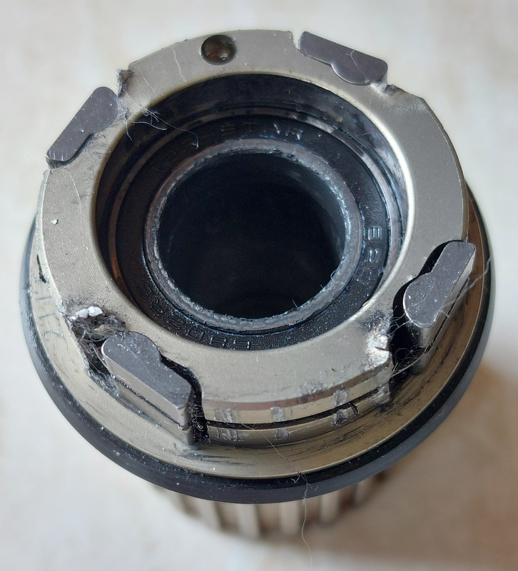

The (unbranded) alloy freehub on the lower end model rear hubs are not great. Warranty replacement was steel freehub so maybe no longer an issue.
There were issues with the e13 cranks and Shimano/e13 had a little blame-game going on. The common fix at the time was to ditch the e13 cranks and bung genuine Shimano crank arms on.

Re the mashed freehub... I could imagine that low cadence + max power through a low gear = max stress on the freehub. Even worse with a Brose or full fat motor. Lazy peddling based on low cadence and max power = broken bits.
FWIW, I changed some stock Shimano pawl based freehub to DeeMax and a DT Swiss style ratchet hoping the longevity is improved, as well as changing to a spinny style of peddling.
