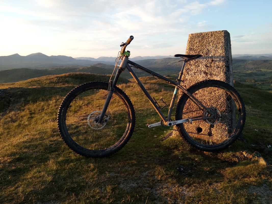

It's a heavy frame but nicely put together, the acid bath does corrode a bit. I'd go for the blue if getting another, it's got the internal protection and it's lush. I'm faster on the payoff up and down than on my Ariel 15X apart from rock gardens. Plenty of 27.2 droppers about, I got an underlever e ten for about £50 I think a while ago now. Geo is short by modern standards, but not short short. 250 quid, bargain!

I have a blue payoff which I bought last year from onza direct. You get 10% off code for signing up your email. I wanted an acid bath one but was put off by the ones on eBay which looked a bit rusty.
Comes with through axle and headset if I remember correctly.
It is a bit heavy but rides very well.
Try googling for other discount codes.
Downside is push fit bottom bracket.
Nicely finished frame. Gets lots of remarks.
