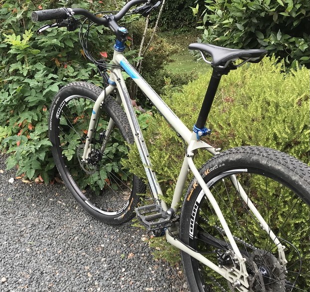

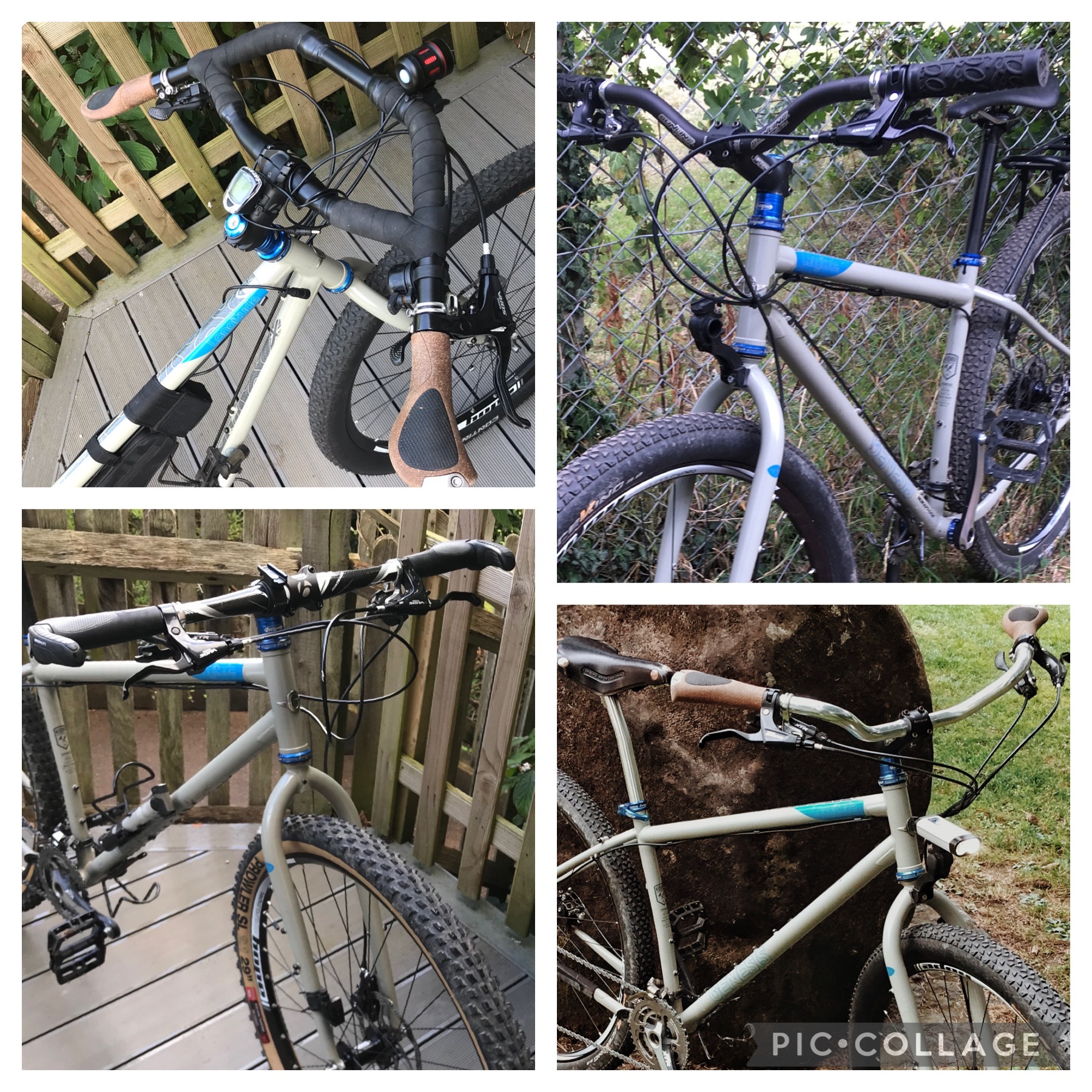

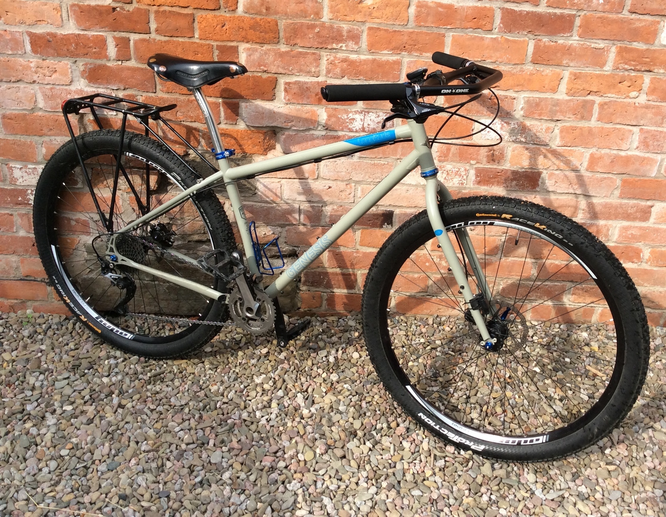

I run a doitall bike (well, almost) in the guise of a 2x10 rigid 29er with various tyre and handlebar/stem combos. Also 2 x saddles pre-fitted to their own seatpost.
1st thing was install new control and brake (BB7mtn) cables on the widest bars and longest stem combo (which happens to be the loop bars and 110mm stem)
So now all I need do to fit other bar/stem combos is remove (lock on) grips, loosen and remove control clamps, stemcap, then whip off the bars and stem in one go, replacing with the new bar/stem combo, slide controls and grips on, tighten and off I go. A leisurely 10 min changeover. Have been running a few setups over this last year or two as follows:
Bikepacking:
On One Geoff (backsweep + loop) bars on 95mm/10deg stem. Ergon GC1 Biokork grips
Road-transitions/gravel/light XC/towpaths etc:
Bontrager RXL carbon 620mm flat bars 5deg sweep on 110mm/10deg stem. Ergon GP3 bar-ends
MTB/general use:
Sunline V2 (25.4mm) 730mm high-rise bars on 90mm/17deg stem. RaceFace Good n Evil grips.
Town and towpath:
Raleigh North Rounders (25.4mm high sweep) using the 25.4mm MTB stem (above). Very springy and sitty-uppy. To be honest I prefer the Sunlines.
I’ve tried all combos on and off over the last few years and this year have stuck mostly with the MTB risers as I bought an old touring bike for local road use.
When going away on hols/car-camping I tend just to take:
-the rigid 29er
-MTB riser bar/stem
-carbon flat bars w/bar ends/110mm stem (which could be flipped for more aero, yet don’t bother as am slow anyway)
Tyre options as of now
- Continental Race King Protection (2.2”) most of the year round, they are light, quickish on all dry/dryish surfaces and only one small puncture in 3 years. These tend to be tyre of choice at all times. Have even ridden mud on them but it was interesting as am running tubes and about 30psi
- Schwalbe Tyrago gravel/road tyres (40c puncture protection) dull but smooth on the road for laden touring, and can handle rougher stuff at a pinch. Hardly ever fit them. If I had a more svelte 29er then would probably invest in some premium fast/hybrid or small block tyres (G-One Speed?) to complement the flat bars when on tarmac/paths longer distances.
- WTB Prowler SL (2.1) no real idea why I have these. Maybe I liked the weight, colour and the price? They are grippier than the Race Kings on XC but buzzy on road and path.
Saddles/posts
- Inline + Phenom (MTB)
- Layback plus Brooks Pro Special (road/urban/fireroads etc)
So a fair few options, feels sometimes like one bike = three bikes
Since added a retro handbuilt steel touring bike (again with 2x sets of bars ie trad sittyuppy bars + rando drop bars that I sometimes swap but it’s a pain to recable) Looking for cable couplers to complete it.
The doitall 29er gets by far the most use all round (no surprise there) but the tourer can munch tarmac and path miles so much more efficiently. I sometimes take that on hols if using as primary transport/touring as it’s a swift and luxurious ride.
If I had to have just one bike and cost was no factor then I’d go with a 29er hardtail XC bike + 2x sets of bars/stems and BB7s (or flat bars, barends and hydraulics)
Posted : 02/09/2021 8:20 pm

Also is just about doable for some XC forays between fire-roads and farm-tracks, but to be clear that combo is 90% about putting the miles in touring (rough-stuff and road) not XC/MTB
I’ve been into cycle-touring all of my adult life and appreciate how a leather saddle can be cool (temperature) and also it doesn’t grip my shorts like the Phenom does at times, so with the Brooks I can slide around a bit, make minor adjustments to seated position on long drags, staying comfortable. Hard to describe but a well-fitting leather seat is a nice place to be on long hot days (ymmv) and the extra weight isn’t an issue on a bike like this.
That post/seat combo didn’t work so well for MTB though, hence the inline post + Phenom for playing on sketchy stuff. Luckily I had a 27.2 inline post knocking about so teamed it with the Phenom for MTB etc…
Touring/long days on sketchy stuff OTOH is still an ongoing experiment.
^ Layback post + bars with a pronounced backsweep puts my CoG further back over the Longitude’s lengthy chainstays, lightening the front end considerably which gives a different, skippier ride over the gnarlier trails. Although I didn’t ultimately get on with the loop bars (also badly adjusted in pic) so may try an On One OG V2
Yet sacking off bike-packing plans for now (not enough free time) I find that the
1. Layback + flat carbon/barends
2. Inline + 25.4mm riser bars
Respectively cover:
1. Road/gravel/keep fit
2. MTB/utility/anything else.
Since adding a road-tourer I instead fitted the Brooks on that bike. So it doesn’t get swapped so much unless taking the doitall on hols, where both setups could be useful.
Spoiler: I’m lately thinking about ditching the whole doitall thing and instead choosing a lighter alu hardtail to complement the retro tourer. But, OTOH, I’ve been a fan of the ‘Mr Ben’ strategy and also enjoy tinkering. So tbh am worried I’d live to regret waving goodbye to it but situations sometimes change.
I *should* really sell the tourer and further upgrade Mr Ben to mid-fat-capable wheelset + dynohub as per original plan. Then it would truly be a doitall in every sense.
with each bar have AXS shifter and associated brake levers/hoses/calipers so at swap over time I can unzip the hoses and fit the calipers attached to the alternate bar…
That’s commitment!
