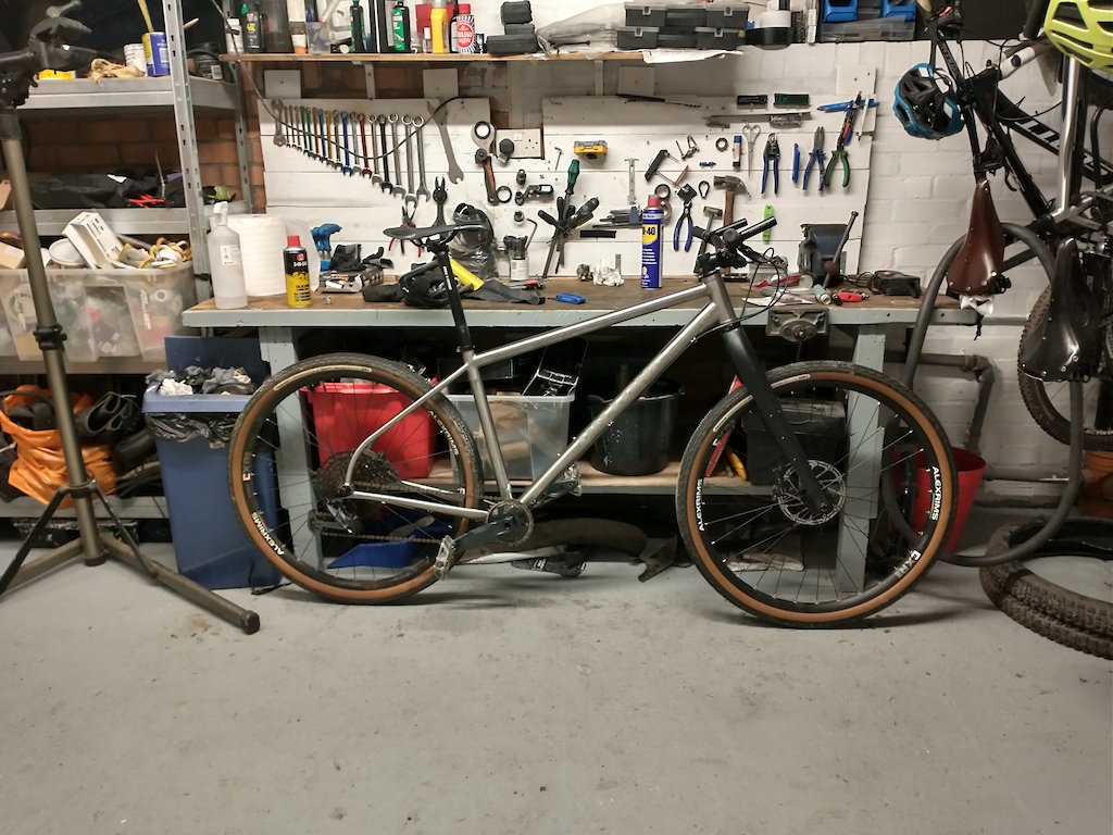

Hi,
I've bought a second hand on one vandal for commuting and the gears are a bit low.
I thought it would be perfect, however my commute mostly goes up a big hill at 5mph and down the other at 30mph and the current gearing of a 32 tooth chain ring and 11-50 cassette is a bit limiting.

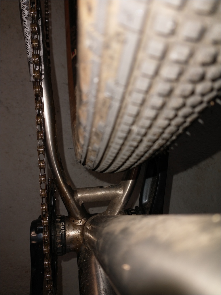

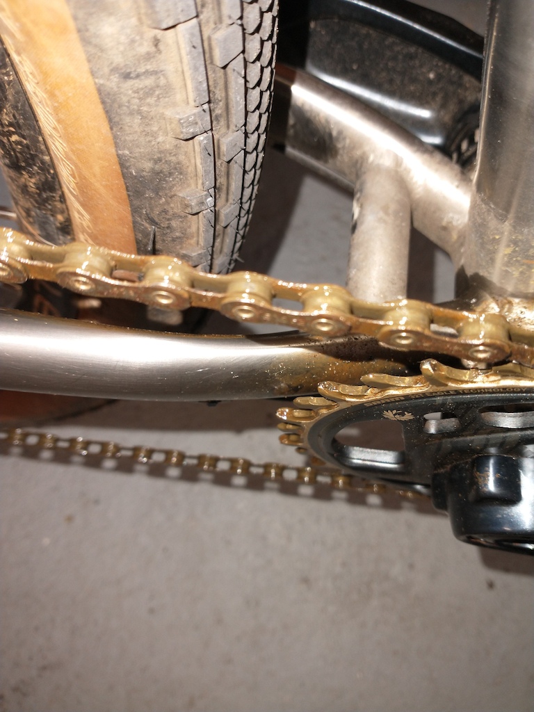

It looks quite tight for a 34 tooth and super tight for a 36 tooth chain ring. I think a 36 would fit if it was one chainrings thickness further out than the current 32.
Has anyone successfully fitted anything bigger than 32?
Is it worth trying to space the chainring out from the chain stay?
On my previous gravel/ commuter bike I bought a 46 to replace the 38 but never got round to fitting it. Any suggestions for getting that to fit?
Thanks for any suggestions!
Oh, previous owners chain rust moved with wd40+ finish line wet are responsible for the chain. A less rusty chain is on the cards as well

It's an on-one, thus all specifications and sizes changed on the whim of the person who packed it. The only way to tell what fits yours today is to try something.

Lovely looking bike. It's designed to be an off-road bike, so suspect 32 might be the maximum, certainly doesn't look space for anymore.
I'd be interested to know if a double chain ring is an option on that frame or is thst prevented by seat post angle?
A double would let you keep the 32 and possibly have a bigger chain ring further out, but you're then into new front mech and shifter.

On one have said 36, which looks really tight.
