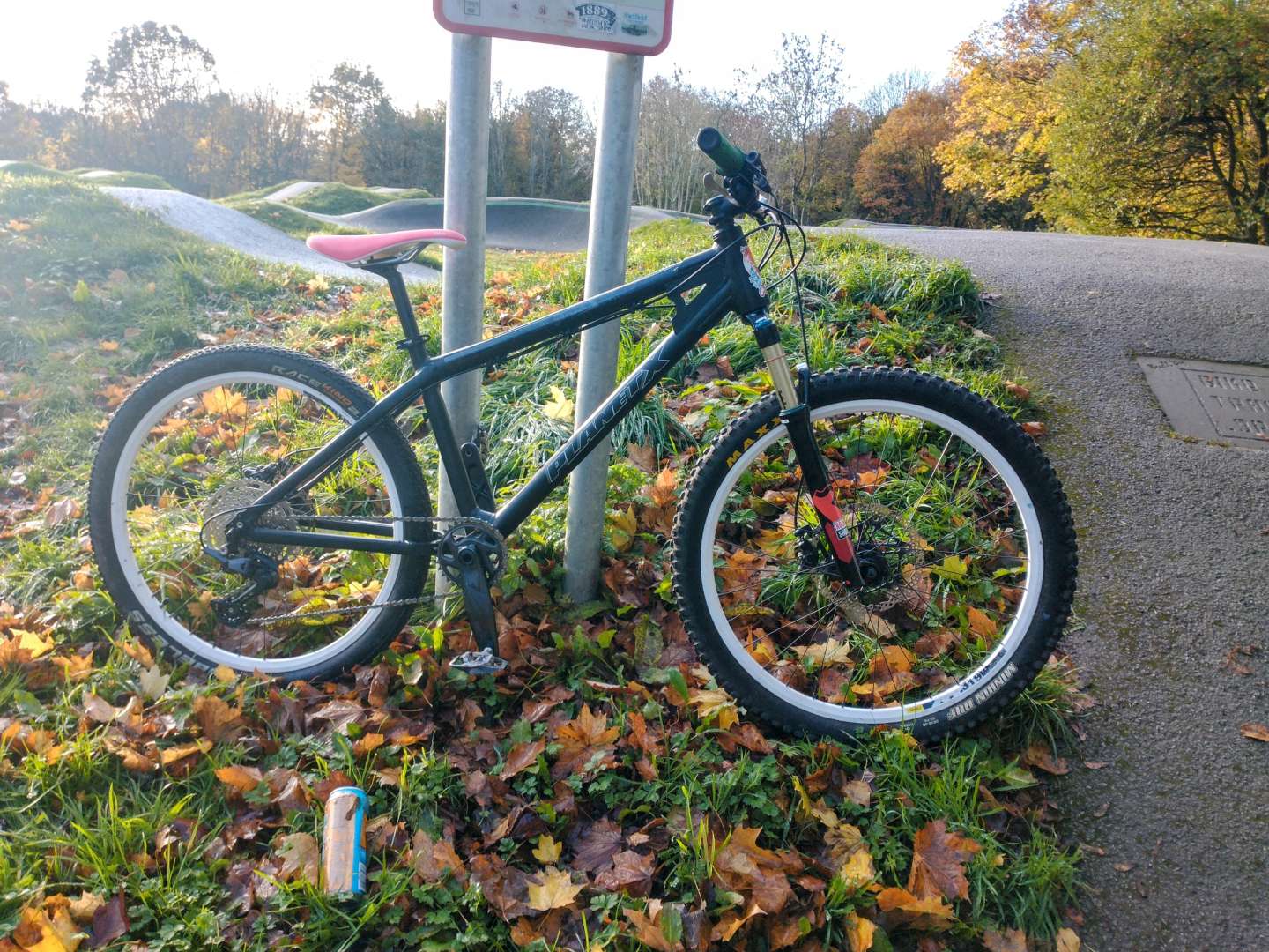

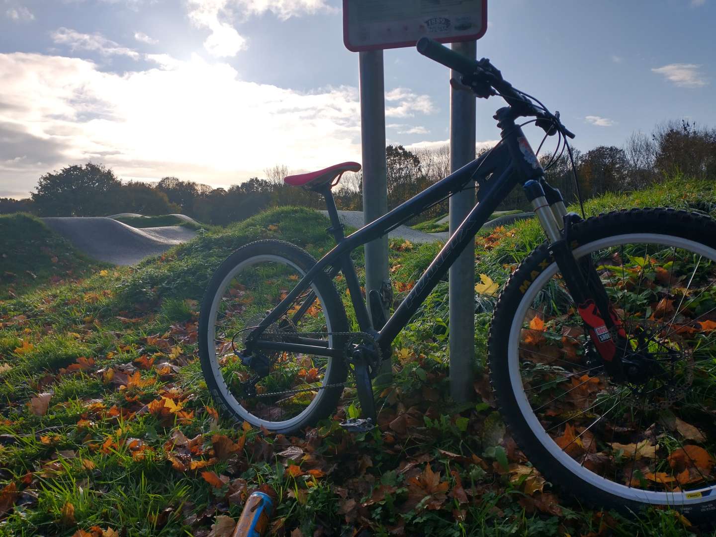

Posts: 8924
I'm also a terrible jumper but I've built a 26Cotic BFe for this purpose.
Not a 'proper' jump build, it's got Marzzochi 33s, two brakes, a780mm low rise bar and a dropper, although it is singlespeed, but that means that it rides fairly well to the top of stuff like those new sections at Glentress for example but is still decent on a pump track
Anyway, it's brilliant. A Stiffee would be great too I expect. I nearly did this build on an old Chameleon but then found a BFe going cheap

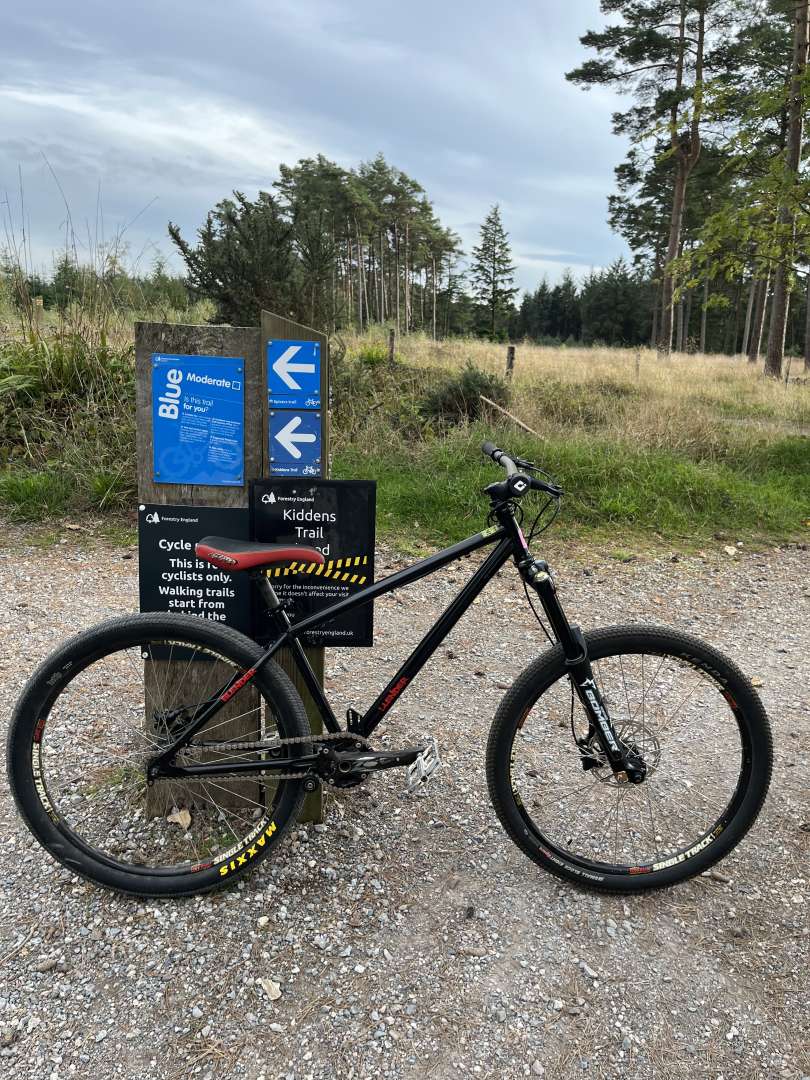

Posts: 3320
 IMG_6563.jpeg I have a Charge Blender that does DJ, pump-track and Dadcountry duties. set up single speed and built for about £100 including fresh powder coating and old parts laying around.
It’s alternated between a rock hard 100mm Marzocchi Dirt Jumper 1 and a 150mm Marzocchi Z1 that’s also set up rock hard with slightly too much oil to give it 100mm travel but a bit more comfortable and higher bar height.  It’s great fun.
Something like a Blackspire Stinger is the tidiest way to singlespeed one, I tried a single speed tensioner on the rear but it was a pain to set up and looked ugly
it will probably go back to the DJ1 when I get a bigger rotor adapter as the Clark’s brakes are terrible.
The Stiffee should work fine as a fun DJ bike.

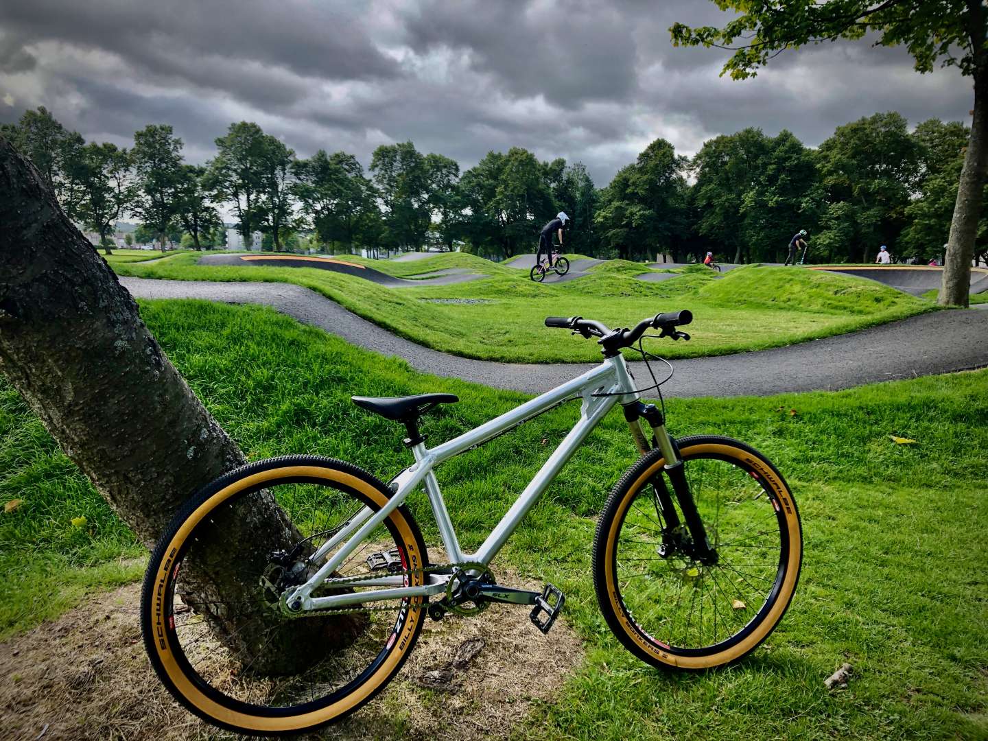

Posts: 3691
Posted by: tall_martin
I'm tall, there don't seem to be many long or big dirt jump/ BMX bikes for sale near me.
Think you're taller than me, but at 187cm (XL G1 etc) I bought a Planet X Jack Flash 26er frame a few years ago for similar purposes. Didn't fancy anything smaller/shorter given my preference for big bikes. Built up mostly from existing spares apart from tyres. Used the same SS kit including Blackspire Stinger.
Sold it now as I simply wasn't using it, despite best intentions.

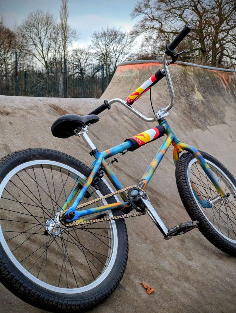

Posts: 8842
I'm 6'2 and my BMX looks like this...
22 inch wheels. It's a Fit Series 22. Also look out for Wethepeople Audio. They do come up for sale and they're not expensive.
I had a Transition PBJ and after running both for a while I sold the PBJ. The BMX is just so much faster and more fun to ride especially on twisty little pump tracks. I loved the PBJ but the Fit kind of ruined it for me. It felt like a barge in comparison.
If you must go 26" a DJ frame is far nicer than an old 26 trail or xc frame. The top tube won't be anywhere near your nuts for a start. It'll have horizontal dropouts so you don't have to mess with ugly tensioners. It'll hopefully be built for purpose and you won't rip the headtube off.
I've offered this before but anyone near Sheffield who's 22" curious can test ride mine at a pump track of their choice. Charnock is probably the best.
