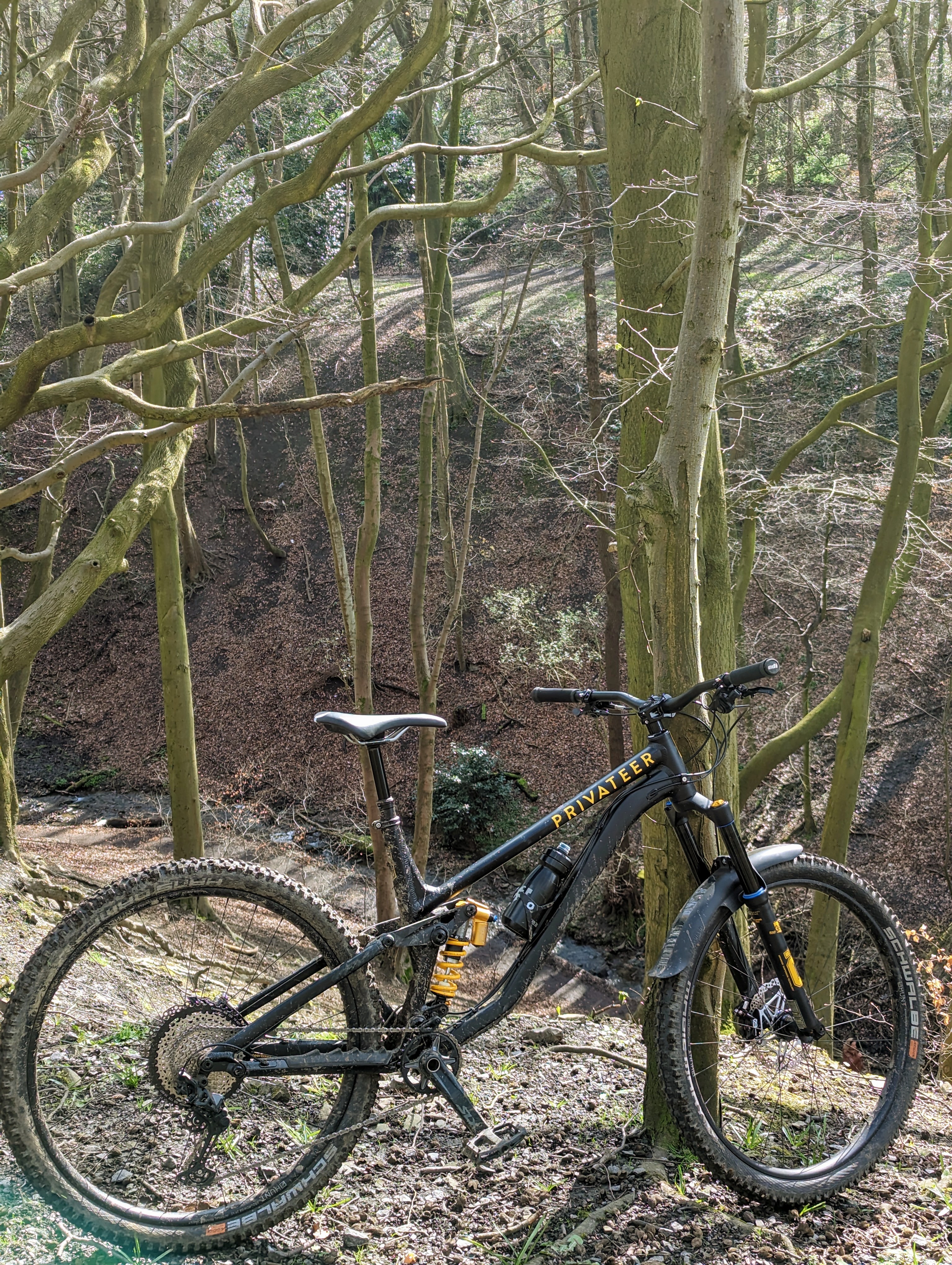

I ran the STX22 with no issues when others had lots of issues years back, just chucked an Ohlins TTx22 coil on and its so good! Got a deal on the coil which pushed me towards it over the air.
