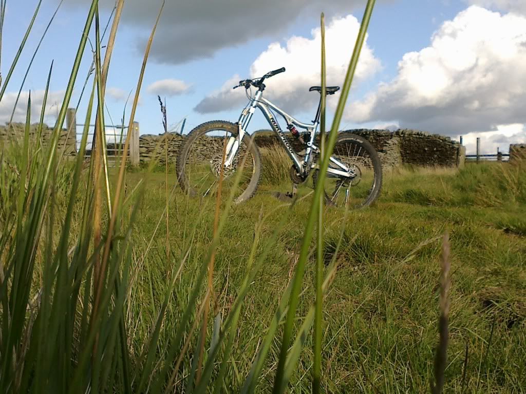

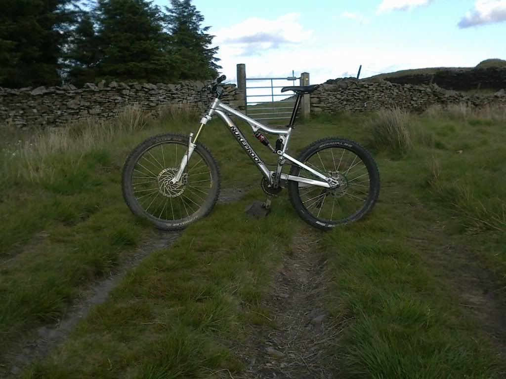

Got any more (closer/non-arty 😉 ) shots of it built up?
Impressed with the speed of your build Trout, especially as some ppl must have had the frame on order for months (delivery dates got pushed back), yet unlike Psychle's Mojo, they didn't have all the bit ready to slap on it asap, when it arrived - that would drive me mad.

Zippy there are a few shots here.
http://s199.photobucket.com/home/amticoman/index
Posted : 01/06/2011 11:46 am
Posts: 14595
ahhhhhhhhhh
Cheers Troutie, I quite fancied one, but worried it was quite heavy & probably overkill for 140mm forks, but that look great.
