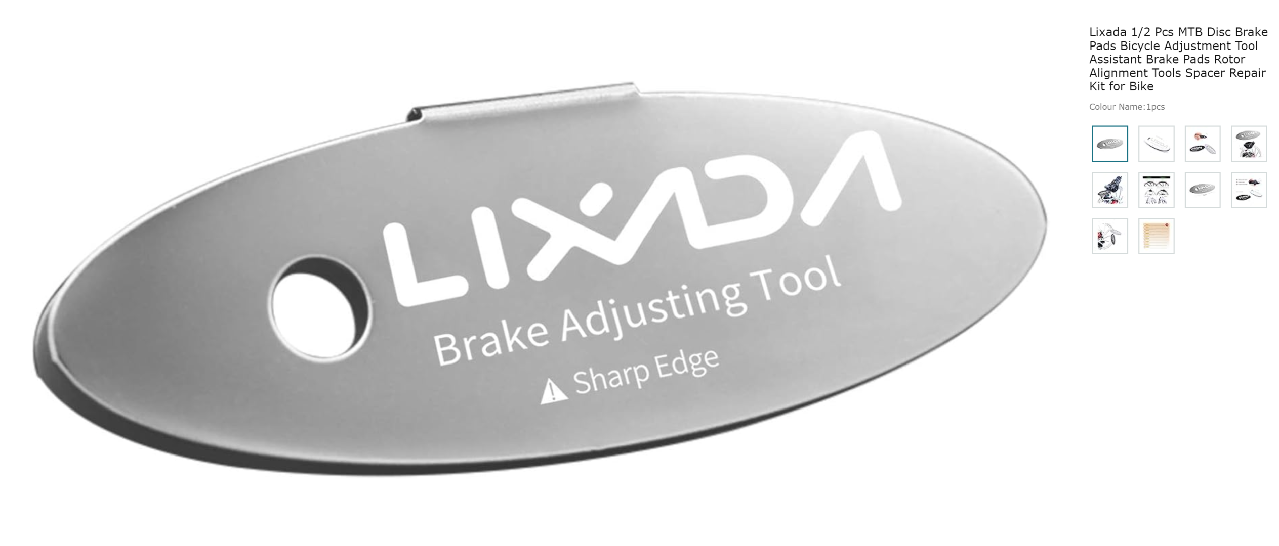

Use one of these on the rotor while you're doing the "squeeze and tighten" thing.
https:  //www.amazon.co.uk/Adjusting-Bicycle-Mounting-Assistant-Alignment/dp/B07FPH77VQ/r?th=1
Posted : 23/09/2025 6:43 pm
