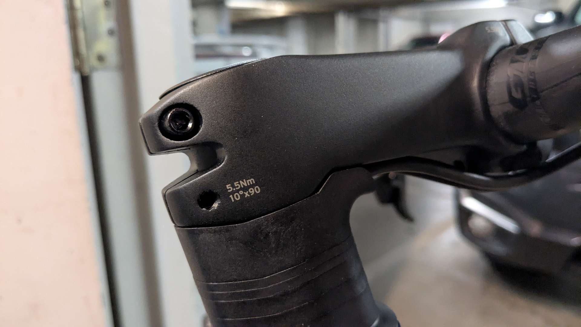

During long rides, I'll often eventually get numb hands.
Before I go down the bike fit/new stem/new seatpost/new frame 🫣 route, I've got some scope to move saddle back or forward a smidge.
ChatGPT suggests either approach may work! lol.
So what would your vote be ? Back or forward?
(I'm assuming if I move the saddle back, I'll have to drop the seatpost slightly, or raise it a little if a move the saddle forward)
[This is in relation to a new drop bar gravel bike]

Posts: 1844
You could do the unthinkable and flip the stem.
Posted : 04/07/2025 6:49 pm

Posts: 1003
Going shorter reach and higher bars will both help - maybe try one at a time and see which is best? So slightly shorter stem, more spacers under the stem (if poss), or flipping the stem (which is effectively both shortening the reach and lifting the bars so might do the trick on it's own)......
Posted : 04/07/2025 8:30 pm

Posts: 1786
Hmmm, that's gonna look ugly with the gap below the top spacer...🤷
Posted : 04/07/2025 9:08 pm

Posts: 1759
Posted by: vlad_the_invader
And this perfectly illustrates the madness from bike and component manufacturers in the roadie world:-  Loads of spacers under the stem to compensate for a stem that drops the bars too much !
They seem to still think we're all 22 year olds with the flexibility of Stretch Armstrong and Morph, knuckle-dragging arms longer than Mr Tickle's, and want a stem longer than the rudder on an oil tanker.
I absolutely hate that the 1st thing most people have to do with a new bike costing thousands is spend a couple of hundred quid more on a new stem, new bars, and re-cable gears and chop + bleed brakes.
(Shout out to Shand who fitted the right stem, bars and seat post for me from the get-go on my Stooshie)
Posted : 04/07/2025 9:30 pm
Posts: 1786
In fairness, I'd much rather have a few spacers I can switch around than a steerer cut too short...
Posted : 04/07/2025 9:34 pm
