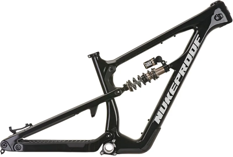

Hi all,
Can't find anything online about it, wondering if anyone knows the post insertion length on a Large Nukeproof Mega 290C from circa 2024.
Got a 180mm Bikeyoke in there at the mo, hoping to move to a 210 / 230 OneUp but just want to double check insertion depth.
Thanks!
Posted : 15/04/2025 9:12 am
Posts: 3754
I don't recall seeing any figures for it.
You're better off dropping a standard seat post in and marking where it comes too.
The kink in the seat tube can interfere with the actuator too - I have a OneUp V2 180 dropper in my Medium 290C and I have about 25-30mm from seat clamp to top of the dropper collar (if that makes sense....).
Seat tube length on the geo charts is 440mm for the Large.
So probably about another 20-30mm past the bottom of the seat stay where it crosses the seat tube.
