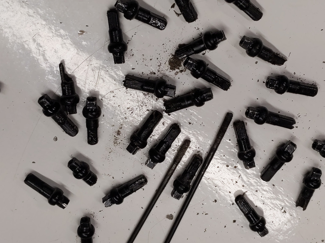

Being the idiot I am, I used to regularly cycle through sea water and not wash my bike. The nipples on the Spank Oozy 345 wheelset corroded and started falling apart. A while back a wheel builder told me they were a waste of time to fix because wheel-builder-reasons but I spent a lot of money on them so intend to fix them myself now. I'm a noob at this though.
Wheelset are Spank Oozy Trail 345. Spank chart says spokes are (straight pull) 2.2/1.8/2.0, and nipples are 'Alloy DSN Nipples' and explains "Longer nipples with 4mm square drive head"
Here's a pic:IMG-20220305-212153
I've not measured them yet. I keep meaning to. But anyway. I think they're mostly gone so might as well replace the whole lot.

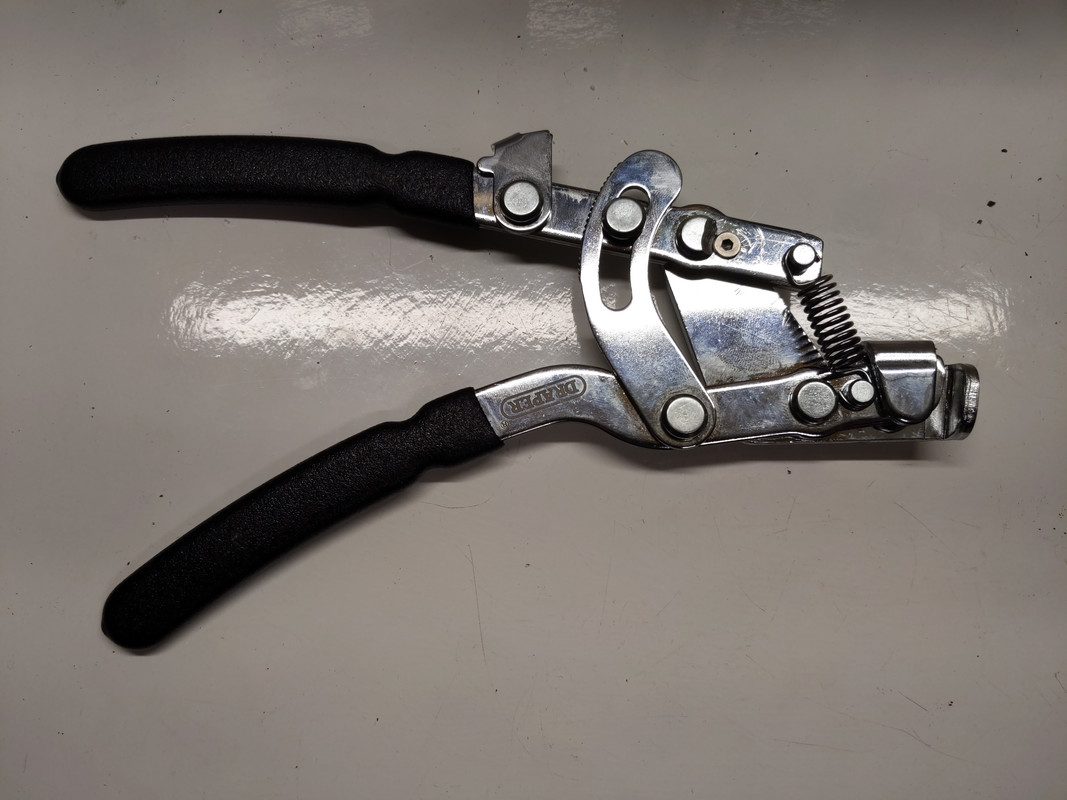

Here's a video on youtube for a DIY spoke holder.
I bought a cheap (Draper branded) cable pulling tool for £10 and sawed some of it off, and drilled and screwed two parts together so it acts like the £40 Park Tool jobby.
IMG-20220309-222203
It's OK, does the job, but not overly comfortable, and combined with using the Park Tool Y shaped tool (for the square driver) is a bit fiddly.

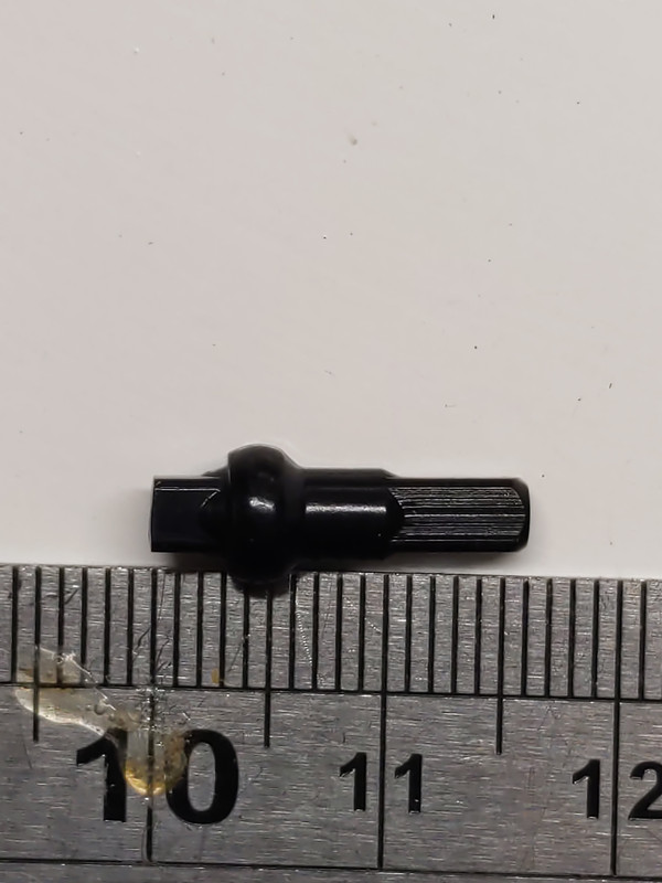

Here's a pic of the old nipples.
IMG-20220309-222016
The nipples look to be 16mm. The Spank chart lists them as DSN nipples - would that just mean Double Square Nipple?
IMG-20220307-215432
So if I were to go the route @bearback mentions, using washers (2mm deep) I'd go for 14mm nipples?
