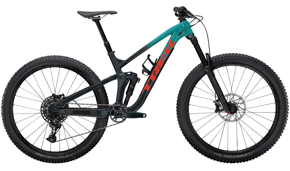

170 Front 160 Rear
HTA: 64.6 High 64.1 Low
STA: 76.1 High 75.6 Low
Reach: 20-30mm longer aparently
Internal Frame Stage (Carbon and Alloy)
Still got the lame Super Deluxe with Thru Shaft
I fully expect to see these EVERYWHERE, a very popular choice round these parts!

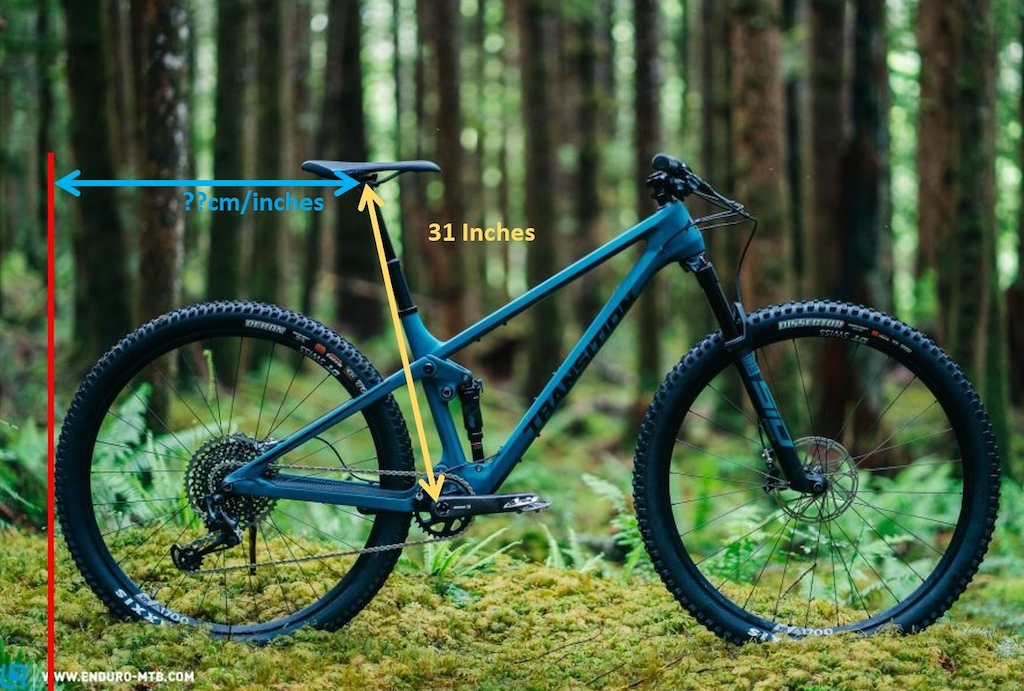

P.s. I measured the effective STA on my Remedy (XL) and it's 3 degrees steeper than Trek claim.
Posted : 13/08/2020 4:18 pm
Posts: 6980
Trek say the Remedy's seatangle (effective) is 74.2/74.7. I struggle to believe that's actually 77.2/77.7
Posted : 13/08/2020 4:40 pm
Posts: 221
I haven't measured the actual angle on my XL Slash, but I'm 6'1/187cm and with the seat at pedaling height my bum is about 5cm in front of the rear wheel axle. The Fox dropper post will only just allow enough seat angulation to keep the saddle level on flat ground.
Posted : 13/08/2020 4:46 pm
Posts: 2571
P.s. I measured the effective STA on my Remedy (XL) and it’s 3 degrees steeper than Trek claim.
Its time to kill of effective seat angle and adopt something less random and open to intepretation.
Define the seat height and then the offset between the centre of the bb and centre of the saddle rail.
Posted : 13/08/2020 4:47 pm
This. People are now so often comparing apples to oranges, and ruling bikes due to the misunderstandings that arise from doing so.
