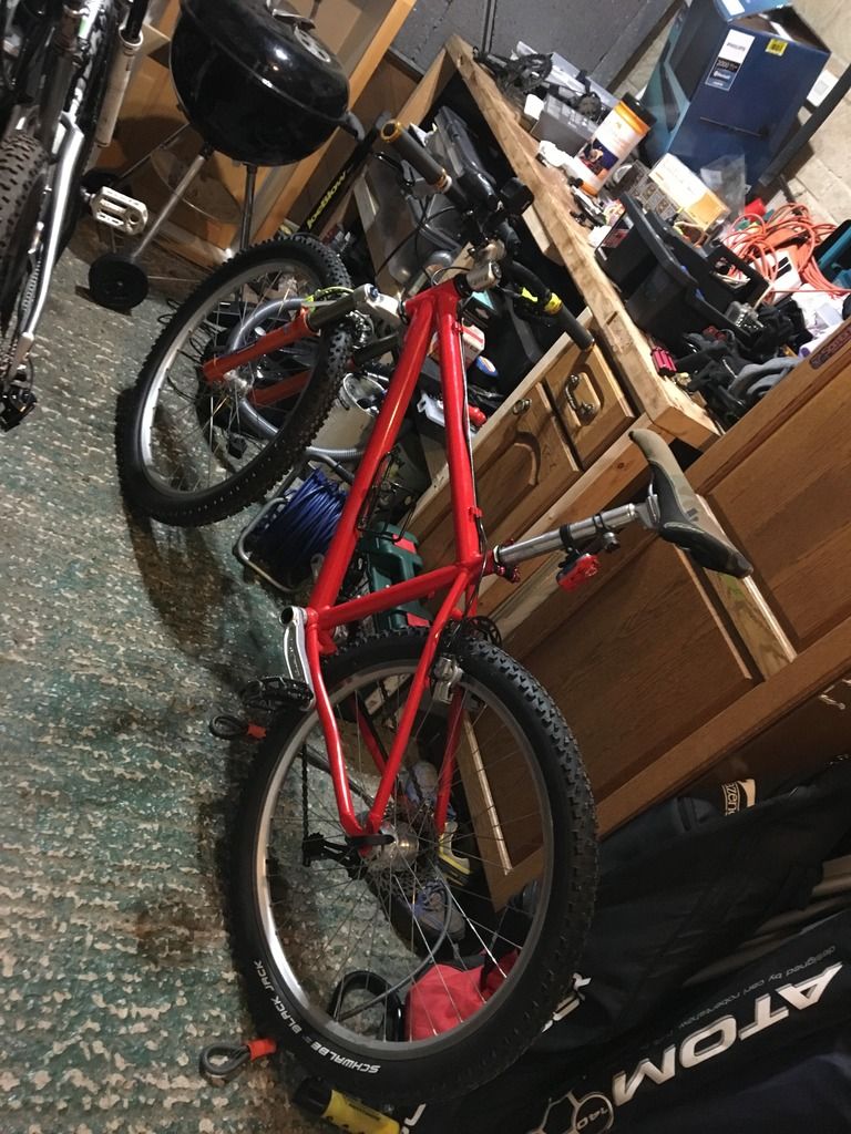

Decided last year to build up a little hardtail after finding a frame really really cheap on eBay (won it for £12). Decided to build it up with the type of parts that were really good the last time I stopped biking for a while in my youth. So it's got what I think are '99 Marzocchi Bomber Z1's, Magura hs33's and wheels built up around Magic D521 rims.

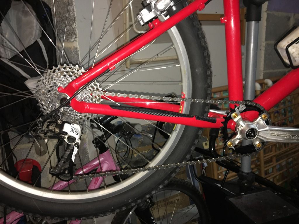

I've got a new handlebar and stem to replace the really old ones that came with the frame (25mm diameter bar and kore stem) but I decided the gears could be less retro - 1x10 with a race face triple crank, 32t oval chainring and the old x9 derailleur from my main full suss bike. 11-36 cassette from that bike too.
Aside from the main bits all the other bits are fairly new. Tyres I wanted something that would roll ok on the road, but be ok for hard dirt - like say the local pump track. So fairly cheap and cheerful - don't really need to be that good.
Took it out for a road ride today - can't off road bike until at least Feb really unfortunately. Really enjoyed myself though - haven't ridden a hardtail in years and it felt so quick.

Also going to swap out the 32t oval chainring for a 34t round one I've just put on the full suss (also now 1x10) as I'd like a bit more commute top end speed. Figure the 32t will give me more help at Cwmcarn next time I can take the fs there.

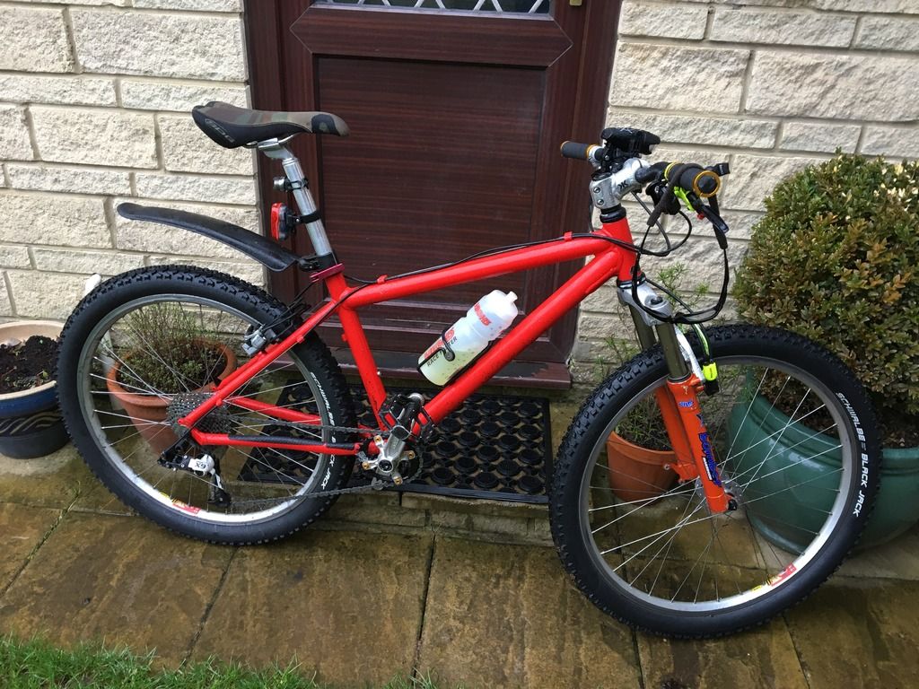

Update on this bike.
Now got Deore discs front and rear which combined were a bargain £30 delivered from eBay. Brand new and boxed, but old stock so they aren't the current version and have very retro looking rotors.
Frame hasn't got a disc mount so using a tensile solutions rear disc brake mount that has antorque arm to the brake stud and then is held on via the quick release lever and another small screw into the dropout.
Thought it have a go at weighing it with some luggage scales - appears to be between 28 and 29 lbs. Iy has a fairly light frame but everything else is probably quite heavy. D521 Mavic rims / the Bomber Z1's / Rsp plummet dropper etc etc.
Forgot to mention it also got a wider handlebar from my FS bike and a slightly longer stem. Rides much nicer now. Just got to finish setting up the dropper and service the forks.
