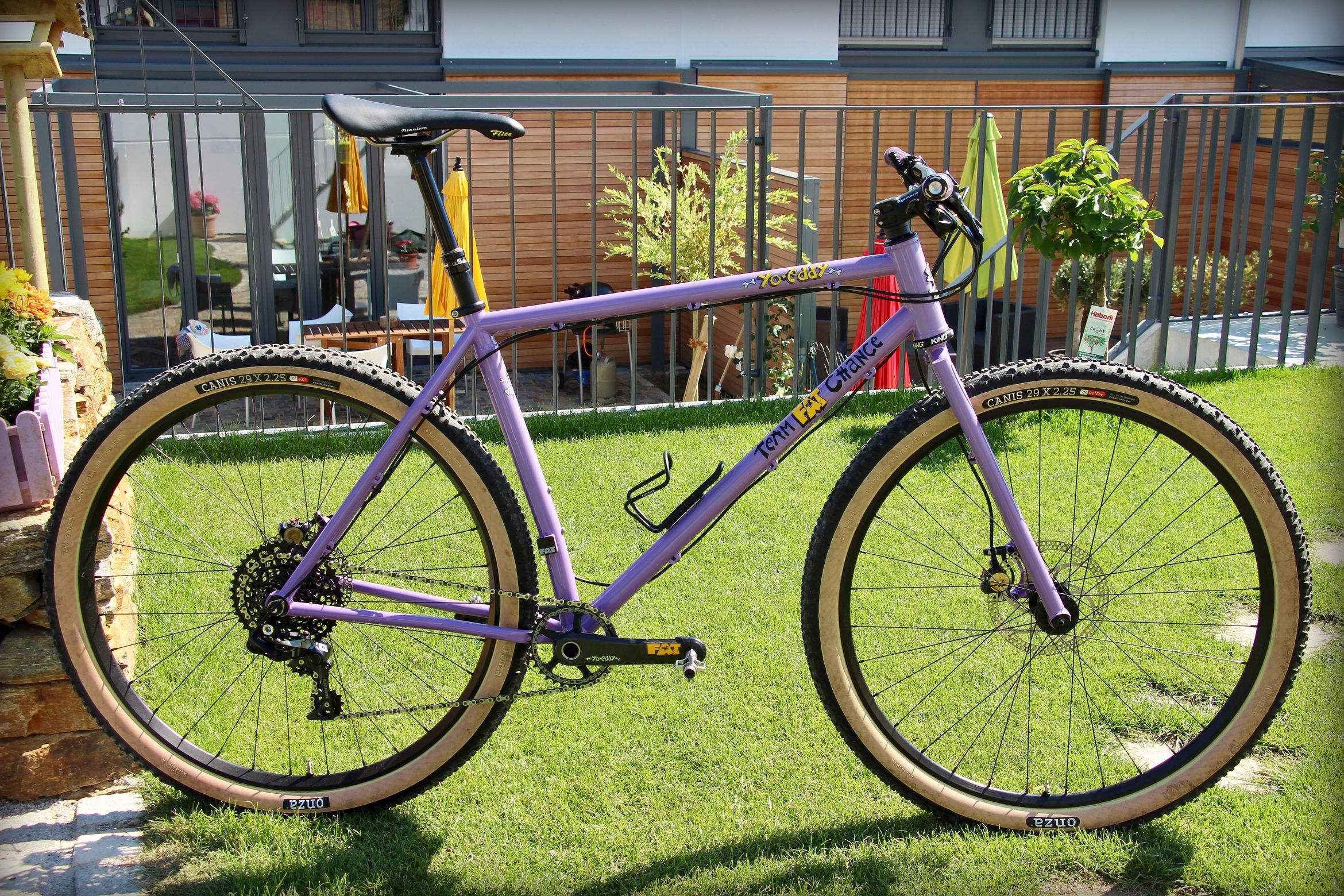

I suppose I just think all MTBs should look like this:
[img] ?fit=crop&h=400&w=700&dpr=1&q=50&sharp=10&fm=pjpg&auto=format[/img]
Posted : 29/12/2017 12:39 pm

Personally I much prefer the look of this...
To this...
Posted : 29/12/2017 12:42 pm

Or even... this:
Posted : 29/12/2017 12:43 pm
