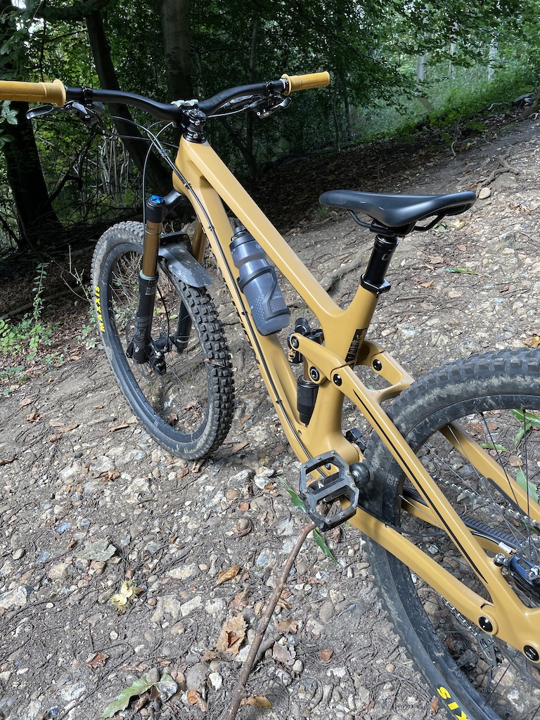

Here’s my new Sentinel, just got it built up last week and took her for a first ride!

If it was mine I couldn't resist colour matching the fork decals.
Posted : 23/09/2021 9:58 pm
Posts: 677
The fork decals are massively f**ed from a few offs but apart from that I kind of like the way the colours go already. What would you have, gold-ish fox logos like this?

First impressions are very positive!
I read someone describe how they were overshooting landings their first time on a Sentinel and I definitely had that experience too, it really boosts jumps nicely.
Downhill it is great, that head angle has a noticeable affect on stability and confidence in steep sections. One other fun thing I found out riding back from the trails on the road is that it was extremely easy to track stand with a slack head angle!
I thought I’d be looking to switch to a coil shock and I’m only one ride in but so far I’m really happy with the X2. Not sure if it’s the shock or the suspension design (probably both) but it has a really nice plush feel off the top and then a lot of pop off jumps too. I didn’t miss the Ohlins coil I’ve come from although I will say my first ride was not especially rowdy.
I was pleasantly surprised by climbing and traversing. It’s not an XC whip but I was expecting a lot more compromise here than I found. It was very easy to spin up the hill and perfectly fine zipping along on flatter sections, it probably helps that the build is a little lighter and that I’m on that air shock. I didn’t find myself flicking the X2’s climb lever except to try it out.
The build was almost entirely with parts donated from my Jeffsy, I only needed a new BB, headset (they take the same size but I was running an angle adjust) and a new dropper (because the sentinel can take more drop). I weighed it at 14.8kg (32lbs 9oz) with pedals and a tannus insert in the back.
One thing I’m going to keep an eye on is pedal strikes - I’m running a 175mm crankset and I know they’re specced with 170mm. I’ll see how this goes - The Jeffsy actually has a slightly lower BB on paper so maybe I’m already used to it!

At 6”1 I was between a L and XL. I went with L because it was more similar in fit to my previous bike and because I wanted to maintain some agility. The ETT did seem a little closer pedalling around the garden but it disappeared as soon as I set out on a ride and I’m happy with the sizing.

Are you using short offset forks as per Transitions builds? On their website they are quite dismissive of using a 'regular' offset, as its all part of the SBG concept.

Are you using short offset forks as per Transitions builds? On their website they are quite dismissive of using a ‘regular’ offset, as its all part of the SBG concept.
Yes. Happily my previous bike also used a 44mm offset fork - a part of what pushed me to go ahead was how few new parts I’d need to put it together!

Quick question: assuming you have the rear brake on the right, how are you routing the hose? I have a new hose kit sat here with the idea that I’ll cross it over the downtube and then be able to tie it together with the dropper cable up front. I’m a bit torn though, I think my current routing is cleaner on the downtube but messier in the cockpit and the other way would look weird on the downtube but cleaner in the cockpit.
I’m sure there is a more first world problem than this, I just can’t think of it right now.
