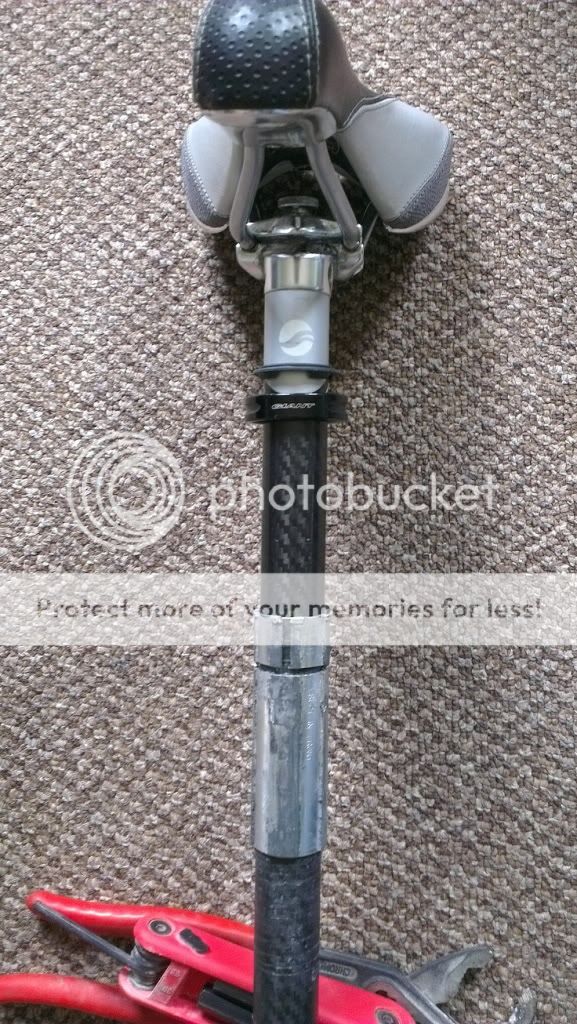

I just bought a lovely new road bike, but I need to drop the saddle down for my wee short legs.
The bike has an aluminium frame with a carbon fibre seatpost. the seatpost is jammed into a sleeve that sits within the actual frame. So I've removed the seatpost and sleeve from the frame easily enough, but they are as one! How do I separate them without getting too violent/damaging something?

I think the 'sleeve' will be a shim, designed to make your seatpost fit your seat-tube. Just lather it in grease and whack it back in. if you've managed to remove it once, you can remove it again if needs be - much easier once it's all greased up. If you remove the sleeve, you may find you have a seatpost which slips down constantly.

You're on the money with that description! The guy I bought it off did mention the 'shim' and that it would be tough to move. You're right, getting the post and shim out is no problem, but they really are well jammed.
I'll have to get some grease tomorrow - any recommendations for type and application? they really seem welded together!

Finish Line white grease. I have bought two tubes in my (long) lifetime of farting arond with bearings, other moving bits and bits that don't move.
It almost lasts forever.
Might be worth sticking up some photos just to make sure we're not giving you duff advice.

Is there a lip on the shim, something you can tap off with a suitable drift?

hot water.

Screwdriver in the shim slot.
Be prepared to replace, or just buy a seatpost of the correct size.

Assuming that you manage to get the shim off you need to use a carbon compound rather than grease when you reassemble it all. If you uses grease you'll never get it out once it is in.
Posted : 09/07/2012 7:30 am
As above, don't use grease on carbon, it can swell and delaminate the carbon, that might be why the post is welded to the shim, carbon paste is what you want

Guys, thanks so much for the advice - my brother-in-law barged in this morning and did it with brute force and grips (in the picture). Still thinking of adding some of that carbon grease for future.
