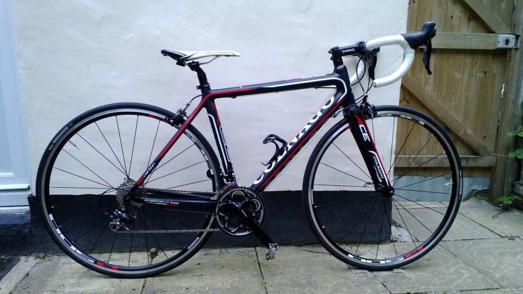

First impressions, it's pretty, it looks delicate and its light! So i put it together and sat on it. Hmmm, seatpost too long so out with the hacksaw.
Right, got the bars parallel with the saddle as told on here, fitted the 10mm inserts into the SDI's and stuck some mtb spd's on and off i went.
Quickly realised the stem is too long at 100m so i'll be shopping shortly.
Riding on the hoods is odd, because the stem is too long i felt i wasn't in control enough with the braking - conversely being in the drops was quite comfortable strangely enough. Which is important as that was the only way i felt confident in traffic!
Gears - 50/34 and an 11-28 cassette seems to be about right, heading up my local climb and never felt like i was running in too tall a gear (which was one of my worries). Still not au fait with SDI systems, kept braking on the front when i changed into a larger cog on the rear but i suppose i'll get used to that. I suspect it's because i'm reaching too far due to the stem. I had to ram the saddle all the way forward as well due to the stem, but i think that will change when the stem does.
The frame seems to fit me fairly well, with the caveat of my extremely short legs of course. Top tube length seems spot on, my chin appears to be just forward of the steerer tube any way.
The ride is surprisingly smooth for a bike with 23c tyres, never having ridden carbon before its a pleasant feeling.
It does seem to wind up its speed pretty quickly as well, something i'm going to like!
Still needs some fine fettling, new stem, maybe an inline seatpost but so far i'm pleased with my purchase 🙂

Ride that stem for a few weeks before you buy another... 100mm isn't very long, it's not going to adversely affect the handling of the bike.
You might just need to adapt to the position a bit...
Posted : 09/08/2013 3:03 pm
Its not that, i can't reach the controls comfortably - or safely in my opinion. A Deda stem is less than £20 so i'm going to plump for one and see how it goes, can always go back to the 100 later.
I just don't feel safe at the moment.
I find my 'perfect' hand/arm position is just behind the hoods so if i reduce the stem length then the hoods will fall right under my hands in that 'perfect' zone.

70 mm stem will make the handling mega twitchy, go for an inline seatpost or move the saddle forward a bit...
Posted : 09/08/2013 3:42 pm

100mm stem certainly isn't that long for a road bike, I'd say if you feel like you need a shorter stem, you probably should have bought the next bike size down.
As for the inflexibility thing and getting used to riding on the hoods, and in the drops, it will come. You'll probably actually find in a short space of time (assuming you do have the correct sized bike) that the 100mm stem makes sense quite quickly. In fact most roadies run 110mm+ stems anyway.

An inline post is possibly on the cards, depends on how this new stem goes. I'll change one thing at once at try it for a while.
I really didn't like the 100mm stem though.
I'm 5'2" but i have a long torso and short limbs for my height so whilst the top tube feels 'right' in that i'm over the front of the steerer tube, my hands are 'just' having to reach too far to be comfy or safe.
The 48cm frame was the size reccommended by a couple of bike shops and CRC's support people, the next one down was 42cm which would have been way too short in the top tube i think.

I'm wondering how 'compact' those compact bars are, and I suspect that the FSA compact bars are even smaller, which would bring the hoods a bit closer still.
That seat looks to be a 'tall' seat; the distance from the rails to the top of the seat is larger than something like an SLR saddle.
It's hard to say without seeing you on it, but I suspect a shorter stem and lower bars would be a more suitable position; part of your struggle to reach the STIs is because you are behind them rather than on top of them.
Oh, and lose the dustcaps!

Just chatting with the wife and even she says that the bars on that bike are big.
Here is her bike, now sold, just look at the bar and stem set up for how compact bars can get:
...and you need tape on the forks where the STI cables sit or it will rub. The best way to avoid this is to run the right hand cable to the left hand frame stop and cross them under the down tube.

Word of warning - don't keep the seat pushed right forward long term to make up for an overly long stem, I did that and buggered my elbows up (burning pain running along the forearm bone to the elbow). Think it moves too much weight onto the arms, though I am a bloater 8)

I'm thinking that with a shorter stem i'll be able to drop the bar height somewhat. I didn't find the bars that big TBH but then again i know nowt about road bikes.
I'm going to get me some helitape before it goes out again as well.
The saddle should - hopefully - move back somewhat when the new stem is fitted. It will take a little time (and cash) to get it dialled but i've got 5 bikes and only one has been a perfect fit from the off.
Posted : 09/08/2013 4:38 pm
Shorter stem, then rotate the brake levers - but not the bars round so that the tops are level (yours point up about 5 degrees). What is teh bar width? Narrower bars can increase reach (or use a longer stem). Pro's are riding with 400mm rather than 420-440. I can't be sure, but I think you've moved the saddle far forward to reduce the reach. Set saddle so that you're in the right position above the BB (knee over pedal spindle is a good start), then choose stem to match reach.
And obviously, unless you've just climbed an HC col, all photos should have the chain on the big ring.

Was going to say 48cm should be spot on at your height, but just looked at the geo chart. I'm 5ft10, would normally ride a 55-56cm frame, 54 at the smallest, but looking at Colnago's geometry I'd want a 52cm frame in that bike! The 45cm would have shortened the TT length by 12mm, as well as giving you another 3cm of standover clearance.

is the saddle height in the picture your riding height ????????? 😥
if so, then that's the completely wrong frame size 😯
Posted : 09/08/2013 4:51 pm
As i said, i have a long torso and short limbs. My inside leg is just 26.5" yet when i'm on that b.ike my chin is in front of the steerer tube.
If i went any smaller with the frame it would be way too small.
All my bikes have the saddle pretty much in line with the bars, whether that be the mountain bikes, the hybrid or the singlespeed roadie bike.

Tempted to agree that,looking at the Colnago geometry, you could have gone one size smaller. But fear not. Once you have set the saddle (an inline post is a distraction here - get the saddle in the right position on that steep seat tube), and fixed the reach with a correct stem, you'll be able to slam that (shorter) stem and remove those spacers. Frames can fit +/- a size, so you'll be OK.
Just as long as you have decent standover height.
Incidently what length are the cranks? You should probably be riding 165mm.

bars and saddle level like that is normally the reserve of the tourer. Puts me in mind of the old 10 speed racers you used to get for Xmas. Frame was always massively oversized (he'll grow into it... ) and the saddle almost on the top tube.

Sizing road bikes when you have got short legs is a real hassle, I know...
I ended up always buying bikes based on the way the reach worked out and ignored what they looked like. The current fashion, and it is a fashion, for sloping frames and lots of seatpost showing makes no difference in terms of performance, and if you are not so tall, you are better getting a good stretched out low position rather than messing with too small bikes with problems like too much toe overlap.
Crank size is another red herring; it really doesn't matter, you get used to whatever crank size you have; I started on 175s, moved to 170s, rode 165s and now use 172.5s, and none of the changes have made any difference.

Crank length is 170mm. Standover height doesn't bother me TBH, i'm used to not having much with such short legs. I've tried female specific frames in the past and found them way too cramped. To be fair, they don't really design bikes for people like me so i've always had to make myself fit as best i can.
The bars will get dropped as i get used to the bike, that's how it came.

Your saying you need a shorter stem as the reach is too long, and the seat is really low on the frame. I'm afraid the frame is just too big for you. The bars and saddle should not be level on a road bike, maybe on a long distance tourer. I know a couple of people your height and they ride bikes with 650 wheels so they don't get issues with toe overlap on such a small frame. I am assuming this was an internet purchase, a descent bike shop shouldn't have sold you a bike with a setup that looked like that. Hope you manage to get something workable out of it.

This, especially as you're running the saddle forward on it's rails, blatantly looks too big in every dimension. Trying to match bar/saddle height, because that's what you do on a mountain bike isn't the most solid logic.
The model below would have only been 12mm or so shorter in the top tube. You'd have 30mm more standover. Even then it sounds like it would be big.

The bike has gone back i'm afraid. The new stem arrived and whilst it brought the reach to exactly where i wanted it, i then found i couldn't get the bars low enough due to the taller headtube.
I contacted the sellers (CRC) and had a chat with the nice chap who agreed that they would take it back.
I'm gutted TBH as it's such a lovely bike, if CRC had a 45cm i would have snatched their hands off.
Hopefully i will get the refund and go shopping again.
I have a fitting/bike test at Edinburgh Bicycle Co-op in Manchester next week for this bike :-
