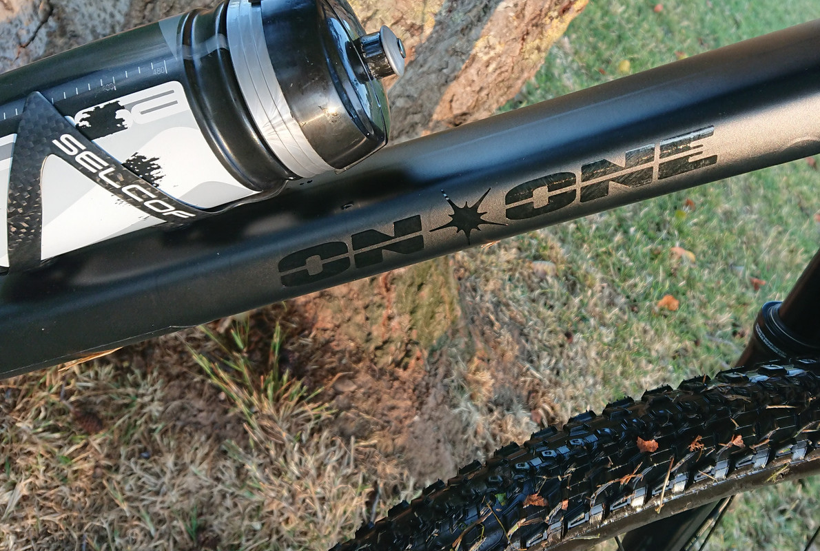

I took my finished build for a first spin this morning. It has been more than a decade since I've been on a mountain bike. I recently put together my old Titus Eleven, but just sitting on it felt very awkward and couldn't get any confidence. On the other hand, the Whippet felt just right.
DSC-2867
I couldn't stand the HUGE decals so I wrapped the frame in vinyl and re-applied some more understated decals.
DSC-2868
A few thoughts: grease on the headset cups? I've read that grease and carbon don't mix, but I can't imagine instaling the headset bearings without any. The Park PPL-1 I use claims no carbon damage, so I just went with that.
Suspension? After some playing around, I am now convinced a rigid fork would be enough for my riding. In fact, I had ordered one from Aliexpress, but am now a couple of weeks post ETA and no idea of its whereabouts. Plan B was to snipe a fork on eBay, but the few I found went close enough to the price of a new Reba RL 100mm.
Handlebar width? My previous MTB had something like 500mm handlebars, the ones I put on the Whippet are 780mm! The circus show feel is somehow diminished after experiencing them on some mild bridle paths, but I am certain I will cut them down some.
