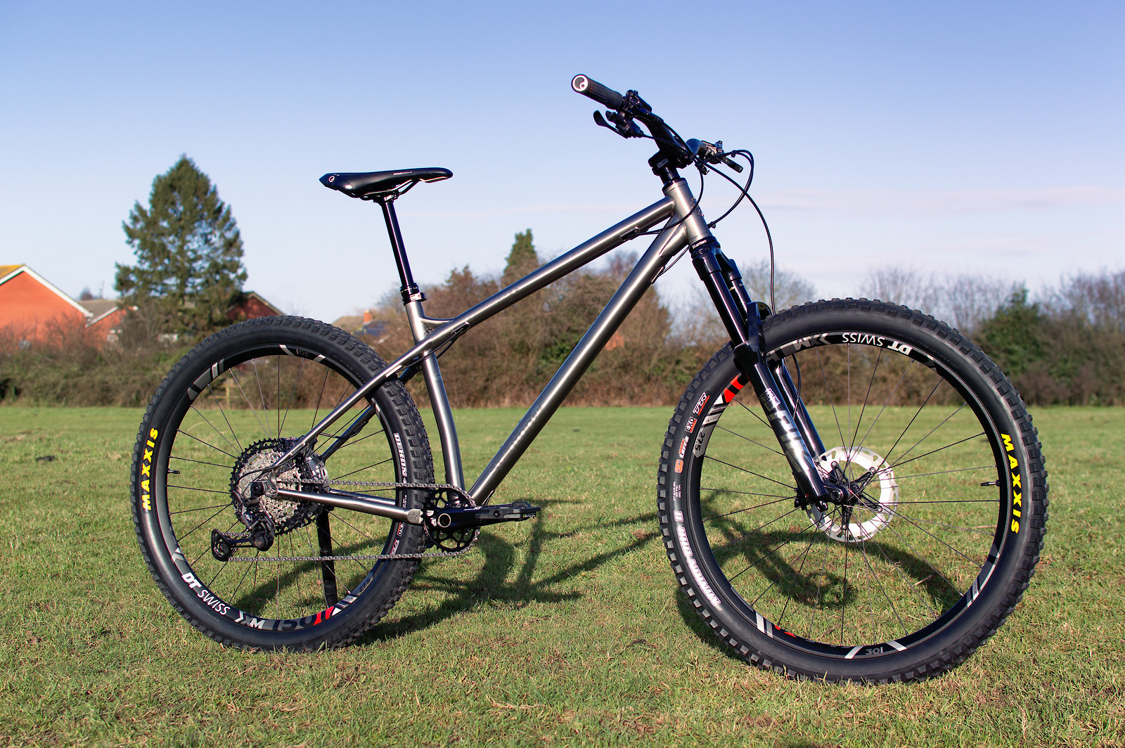

replace my Mk3 Titanium fully rigid Stooge
Big ask to replace such a special bike! My MK4 is about as close to a forever bike as I've ever had.
