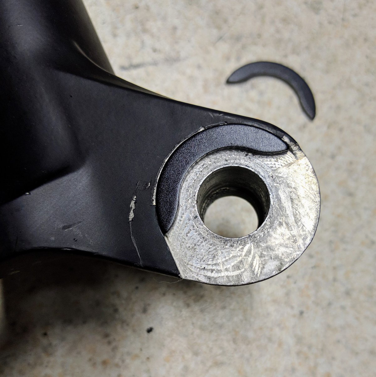

With the Fox 38 you’ll need to check if your hub has Torque Caps and it so, if they can be swapped for normal 15mm axle thingies.

Your current hub might have torque caps, which only work on Rock Shox forks. A lot of hubs are easily converted, just swap the end caps for standard ones. Guessing you might have Hope hubs, which is a really easy swap.

If it's torque can, it will fit snugly in the Lyrik dropouts. If not, there'ss about 3mm of space around the end cap. Pic below shows a RockShox fork with a stick on adapter for non torque cap hubs, about that much space
