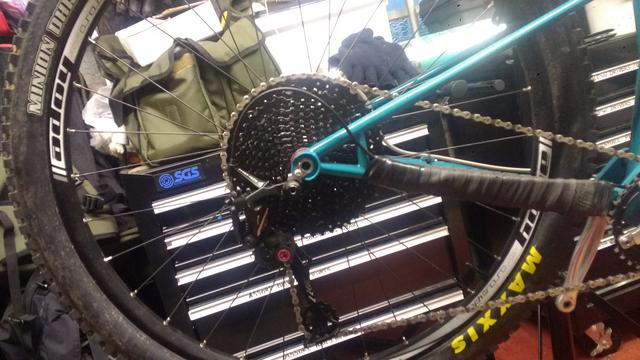

OK so things aren't set quite the same as in the pictures, as both myself and the LBS will have fiddle with indexing/b-tension since and the chain is a full SRAM PC-1130 chain (116links i think) I didn't remove any links, and it was supplied by the shop that I bought the Box Drivetrain from so knew it was going with a 50t.
I would've assumed that the LBS would've picked up on the chain being to short,even if i didn't.

Box have been in touch and asked for some pics in highest/lowest gears so I'll get that done, see if I'm missing something obvious.

Put some pictures up of the current set up as it looks miles out in the other pictures.  Somebody else might spot something that you haven't.

MMm..ok I think you lot is onto something with the chainsize, im just stripping & replacing the whole cables just in case and i'm looking at the angle of the derailleur cage when its sitting idle and its nothing like where the its sitting on my hardtail. And also i've found the box for the Sram pc-1130 chain and its only 114links, one thing I would say is Box's own 11speed chain has only 116links
https://www.chainreactioncycles.com/box-one-11-speed-chain/rp-prod178799
I've just ordered the PC1130 with 120links so we shall take it from there and see what happens.

Ok so I 'think' I've got this sorted. A new 120link chain, replacement cables and new shifter. Basically what happened was running the chain too short put way to much tension on the drivetrain and borked the shifter and constantly mullered the derailleur hanger out of alignment (I purchased a hanger alignment tool). I possibly could stand to loose a link, but I'm loathed to fiddle with it further until I can actually ride the damn thing.
So it shifts,but it wasn't the easiest to get indexed and was quite fussy with b-tension but I imagine that's similar to other 50tooth set ups. The shifting isn't as crisp as my SRAM GX 11sp/Sunrace 46t... you seem to need to make quite positive, sharp thumb movements with the shifter or you get half shifts. I need to put miles in now.

Sorry last one is a bit shit, but you get the idea of chain length. I don't think i'd want it longer.
Brief shakedown ride this afternoon, and yeah it does shift but as I stated above I feel i have to be much more conscious of how im pushing the shifter lever moving to the larger cogs, you need to be accurate and defined with your thumb movement or you shift too far/not enough. The clicks just seem vague compared to SRAM. Coming down from larger to smaller cogs seems to be much sharper. And ive played with cable tension/b tension till im blue in the face
It's hard to know if its a chainline issue or just a feel issue with the Box stuff.
