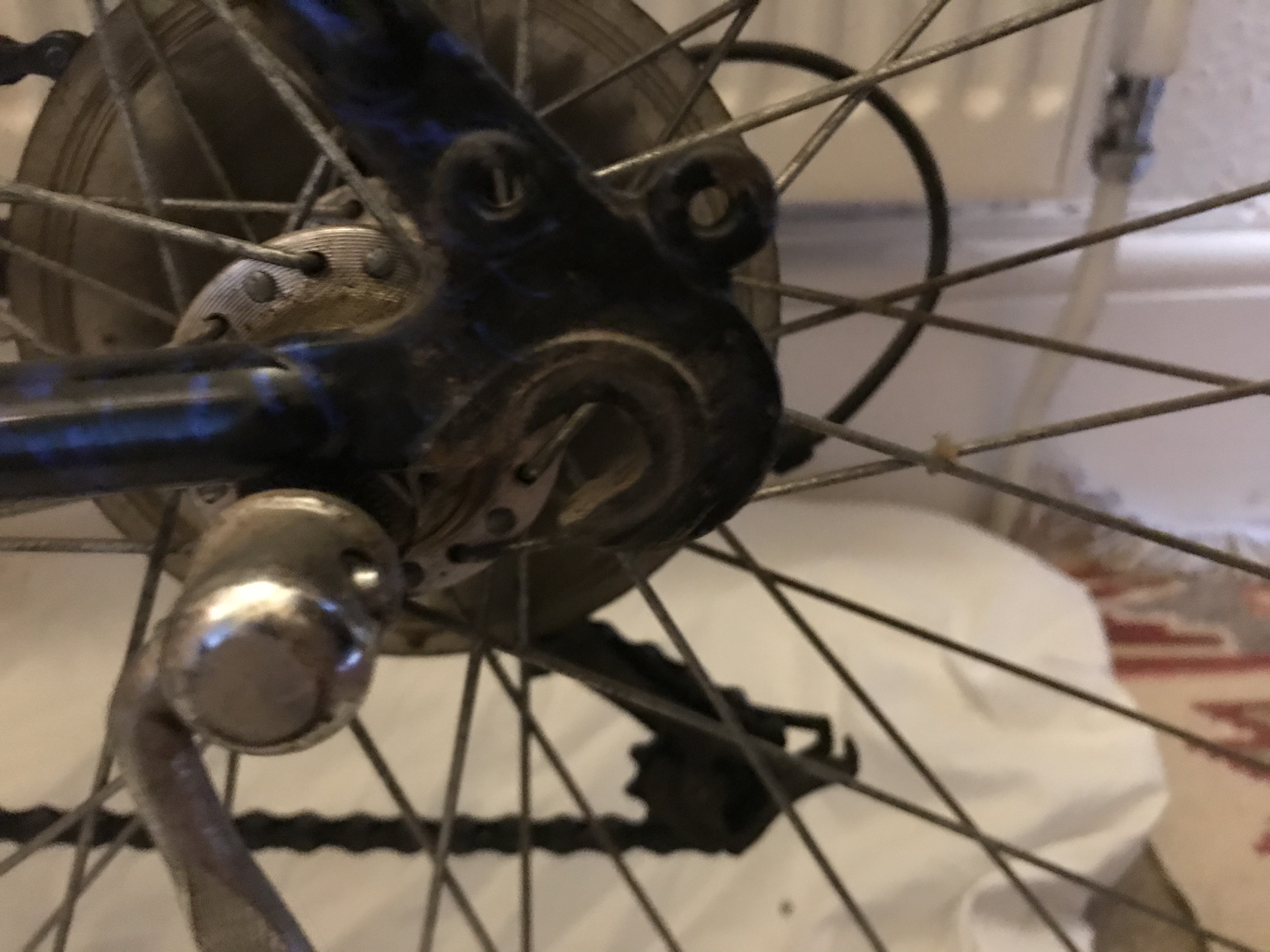

So, the question is, what to do with it? Thought about cleaning it up, singlespeeding it, replacing tyres before deciding next move?
[URL= https://thumbs2.imgbox.com/8a/4e/3ecdS7mZ_t.jpe g" target="_blank">https://thumbs2.imgbox.com/8a/4e/3ecdS7mZ_t.jpe g"/> [/IMG][/URL] [URL= https://thumbs2.imgbox.com/cb/95/c1ZeRyef_t.jpe g" target="_blank">https://thumbs2.imgbox.com/cb/95/c1ZeRyef_t.jpe g"/> [/IMG][/URL] [URL= https://thumbs2.imgbox.com/76/f3/azJZPXut_t.jpe g" target="_blank">https://thumbs2.imgbox.com/76/f3/azJZPXut_t.jpe g"/> [/IMG][/URL] [URL= https://thumbs2.imgbox.com/34/3a/4DBP34sE_t.jpe g" target="_blank">https://thumbs2.imgbox.com/34/3a/4DBP34sE_t.jpe g"/> [/IMG][/URL] [URL= https://thumbs2.imgbox.com/ae/1c/jujbXctp_t.jpe g" target="_blank">https://thumbs2.imgbox.com/ae/1c/jujbXctp_t.jpe g"/> [/IMG][/URL]
Question: is this style dropout enough adjustment for SS without a tensioner?

That'll singlespeed.
It will probably be fine but you might have to go up down a tooth.

You'll need a tensioner with those dropouts. They're the same as vertical ones but on a slant - unless you seat the axle properly it could come out. Not like the old style slotted horizontal drop outs.
Turn those handlebars slightly too as they look a bit droopy.

You’ll need a tensioner with those dropouts.
You won't*.
*Based on my own experience on more than one bike including a polo bike that took more abuse than mist bikes do.

^Thnks everyone for (even conflicting) input, appreciated. I will give it a go without tensioner first.
