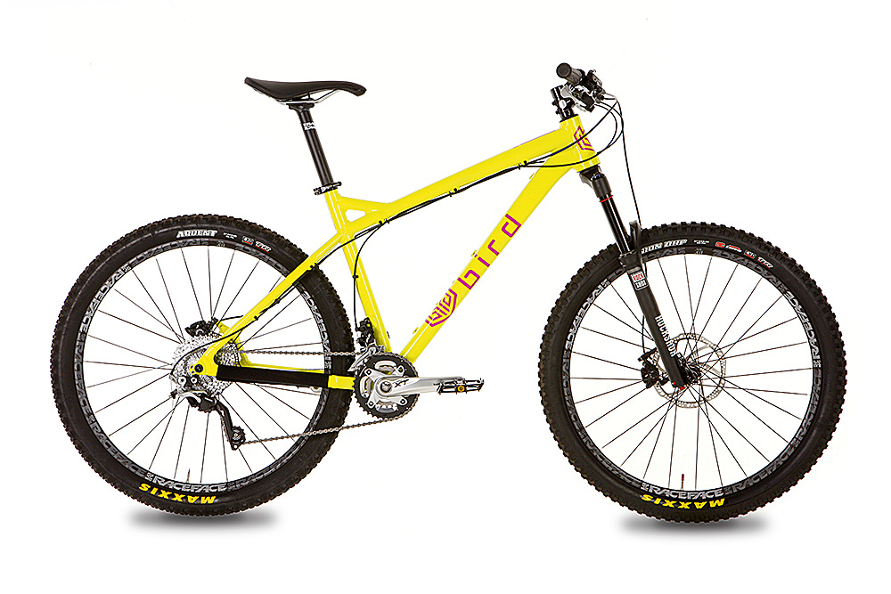

Bird Zero.3, it'll come with the tubeless tyres set up already so that's one less faff.
Forks are x-fusion velvet
This, but lower spec

BTW that's a great looking bike!
Posted : 04/12/2014 11:09 am
Thanks mogrim, bought through cycle to work too, so great price. I'm very excited!
