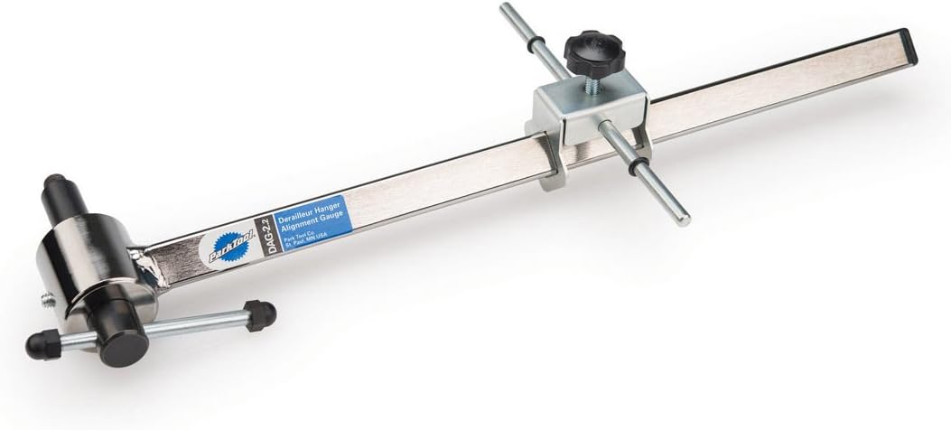

GRRRRRR i can't for the life of me get 12 consistent gears out of this setup
It's all Shimano which i don't generally run... but that said, the Trek was Shimano and worked sweetly.. I've checked and re-checked the B screw, indexed and indexed it... I can move the 'skip' higher or lower, but DAMN i can't completely remove it from all gears, i generally end up with gear 7-8 not existing unless i go back to them in reverse clicking.... it's not a disaster in any way, but it is a minor irritation that's for sure !
I may need to get a gear hanger alignment tool i think.
Posted : 28/11/2022 7:48 am

Gear hanger alignment is your first port of call. I had this with deore 11 speed with the new style mech and the hanger needed a tweak and it was instantly perfect. Before that I had what you had. I think there’s a cheap ish lifeline one.
Posted : 28/11/2022 7:52 am
Posts: 4588
GRRRRRR i can’t for the life of me get 12 consistent gears out of this setup
yep, hanger alignment issue most likely.
Posted : 28/11/2022 8:07 am
Cassette loose?
Posted : 28/11/2022 9:10 am
Posts: 6980
Another vote for hanger alignment here, and/or the mech is slightly twisted. I had the same issue, got the alignment bang on but it took a new mech to sort it even though the old one looked fine
Posted : 28/11/2022 9:46 am
Yeah it's a weird one as the bike was brand new. It's not been right since day 1.... I'll get one ordered up.
Posted : 28/11/2022 9:50 am
Posts: 2430
It's not rare for brand new bikes to have misaligned hangers. Or bent mech arms. Depends on which gorillas preparing and boxing them up.
Posted : 28/11/2022 9:57 am
Posts: 2571
-Check the cassette isn't moving on the axle.
-Hanger alignment, even new ones can be wonky.
-Shimano mechs are bent from new to improve the chain alignment, so be careful with that one.
Posted : 28/11/2022 10:11 am
Eldest_OAB's rocky had a touch too much paint at the dropouts - we cleaned up with sandpaper and the hanger sits in better.
Posted : 28/11/2022 10:30 am
Confirmed at LBS Rotec Cycles this morning as a bent hanger... We did have a little try at straightening but it wasn't going to fly and risked breaking, which as i can't get one before the weekend, wasn't a good plan.
So i've ordered a new one, but with postal delays i may not get it in time, so will suffer with 'most' gears most of the time for now 🙂
