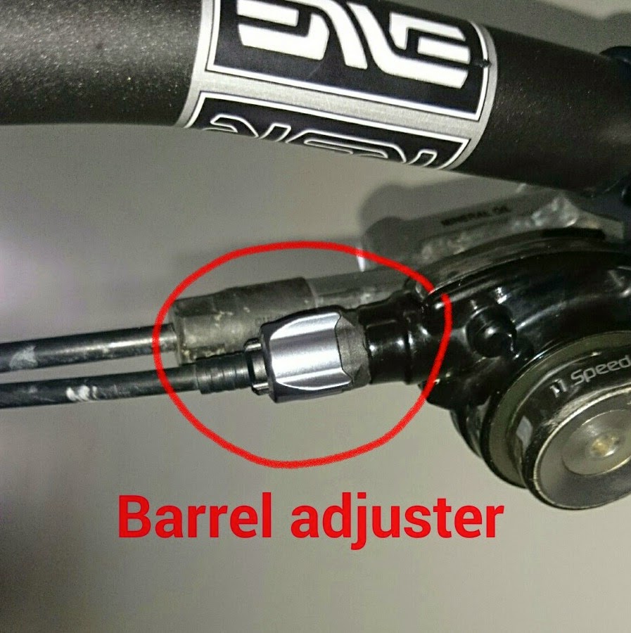

Thanks for the tip - will try... but can you let me know what one the barrel adjuster is? lol
Never messed with rear mechs as of yet!
Posted : 18/09/2016 7:12 pm
Posts: 1353
Is the barrel adjuster on the derailleur or on the shifter?
Posted : 18/09/2016 7:40 pm
Posts: 382
I'm not sure if there's an adjuster on the X1 rear mech, there will be one on the shifter though so try that.
Posted : 18/09/2016 7:52 pm
[s]This image might not work as it's a long link, copy and paste the text between the square brackets into your web browser and the [/s]X1 barrel adjuster [s]will be[/s] revealed!
Sorry, missed the X1 bit, as toofarwest says, at the shifter end. Shimano put it on the derailleur
