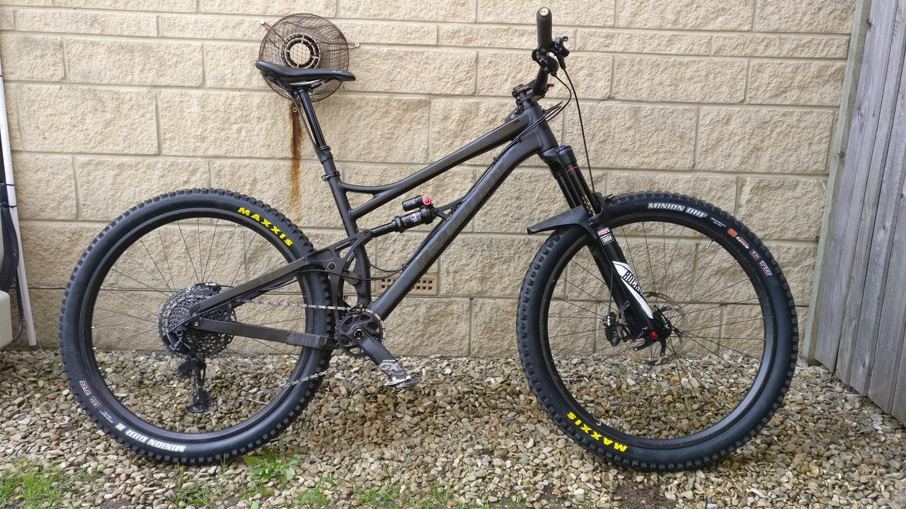

Hi guys, before you all tell me to go in a diet I am currently cutting weight. However I still want to lose some chubbyness off my new steed as it's a bit heavy for my liking. Current set up
Frame - evil the offering (this won't be changeing-it rocks!).
Fork - 150mm Lyrik
Dt350s on dt ex471s
Maxxis dhf front dhr11 rear. 2.5 and 2.4
Sram gx eagle groupset
Shimano dx spd pedals
Saint front brake slx rear.
Reverb dropper
Charge spoon
Renthal 31.8mm sram and bars 50mm stem 800 bars.
Any Thoughts on where the most bang for buck weight saving will be?
I was thinking maybe changing the rims for ex481s lighter tyres, carbon crank and xtr pedals but I have no idea if there is a more cost effective place to pull weight out of it?
Other idea I had was sell the Lyriks and fit a pike?
Help from experienced weight weenies much appreciated-

That looks a pretty sorted build why do you need to lighten it?
I’d spend the money on a holiday or a PT and getting fitter...
However, if money is no object...
Don’t bother with xtr pedals only spdsive broken, I stick to xt level these days
Carbon rims, lighter hubs and tyres are where you’ll save most weight but at a serious amount of £££ plus you will most likely be sacrificing some durability over your current setup

DT 350/EX471/Comp spokes = 1940g (assuming 32h)
DT240/XM481/Rev spokes = 1730g (28h build. I have 28h on a Liteville 601 and no probs at all)
According to DT spoke calculator. A decent weight saving & 481's are really good. Just confugured on actionsports.de and the 32h 240/481 build is 649 Euro's and 1791g.

What does it weigh & what do you want it to weigh?
New 29" Pike is only available up to 140mm travel, so won't work on that bike.
Posted : 04/02/2019 8:29 am
 geex
Are the tyres DD or DH casing? Do they have tubes or tubeless?
If so fit exo tubeless (but don't run daft low pressures)
Swapping the charge saddle for a S/H SLR 135 will save 120gish
Swapping the lyrik to a pike will save 150g (and perform worse)
The rim swap you're considering will ADD weight. not save it.
what does the full bike weigh?
is the frame heavy?
Posted : 04/02/2019 8:36 am

Cut the bars down to 780mm. Saves weight, costs nothing. 🙂
Posted : 04/02/2019 8:39 am
As above really, its a pretty sorted build for a purpose. You are going to have to spend pretty big to get anything more than a couple of hundred grams saved in one area.
Are the renthals carbon or alu?
Plenty of lighter options than GX Eagle, but big money to replace it all/move up SRAMs heirarchy.
A DT swiss XMC 1200 wheelset is 1500g in 29". but is £1800.
Saints are pretty heavy brakes, but there's only ~100 grams to be saved by going really light.
Tyres arent the lightest, but for that sort of riding, i wouldn't go much lower.
Switching to XT pedals would prob save a chunk to be fair, even to the trail ones.
So yeah, throw 3k at it & you might save a couple of pounds.
edit, just read a couple of reviews and XO1, E13 carbon rimmed spec is 29lbs (and 8000EUR), whats yours at?

Pick the bike up, then take the saddle off and pick it up again. Realise that you can’t really tell a 300g weight saving and get on with enjoying the bike.
With a build like that, any significant weight drop is going to lead to performance or durability issues or be hugely expensive. Or more likely, all three.

That's a very similar build to my Offering. You're in the territory of deminishing gains. You'll need to swap out everything for a little bit of a gram difference, that you won't notice until you've done it all.
That's gonna be expensive.
It's a 29er Enduro Bike, it's not gonna be a lightweight XC bike. If you get your head around that, you'll forget about the weight idea and just love it.
However, the big ticket items on there are the GX cassette and crank, the wheels, and the bars if they're alu. The rest is gonna be tiny gains. You're looking at +£1000 for those parts, and saving less than 1000g, is it worth it to you?

Based on current spec I cant see how you can make any significant weight savings that you would notice, if your running Tubes then Tubeless is a cheap and good upgrade. What kind of riding are you doing?

is the frame heavy?
yep. Great to ride but evil's carbon ain't exactly light.
In my opinion you're on a hiding to nothing as it's never going to be a light bike, we did say on the other thread it's plastic but it's not light. If i were going to change anything though...

Change the gx cassette for a better one, possibly cranks too.
Then your brakes - different front and rear would upset me personally.
Swap to some light pedals if you're bothered about weight, the mallet dh are big platforms and 150g lighter, xt trail are 200g lighter but don't have much of a platform, eggbeaters have no platform but weigh sod all.
Much else and you're going to be ditching performance in favor of weight.
Posted : 04/02/2019 9:13 am
Change the gx cassette to x01
Change wheels to dt swiss 240 and a chinese carbon rim probably 27mm id.
Total of both of them 500g ish cost around £1k. So a total of £2 per gram.

Need to know how heavy it is in current form really. I have over the years spent big making some hefty bikes lighter. But there was always massive compromise. Consequently I constantly broke stuff. Yes they climbed a bit better but actually I think it made the bikes worse going downhill. So it’s always a trade off. I like my bike weight to be sub 30lbs, that has always been the number I have aimed for. But reality it means nothing. My Mojo Hd4 weighs 13.5kg...which tickled my OCD perfectly. Made bigger all difference when it was covered in 5lbs mud at Barry Sidings the other week. I find tyres make the biggest difference to any bike. Not just weight but rolling resistance. As soon as I can refit my rock razor the better😂

Here's a picture of my Prime. To make you feel better, it's 33lbs, which is 14.96kgs.

Doesn’t change the fact I’d like to lighten this bike.
You never stated how much the bike weighs... Don't get me wrong, it's possible to lose weight, but it won't be cheap and it also risks compromising the intended performance!
I have gone the other way on my recent Offering build...
I used to run carbon cranks, not any more, too many warranty issues so I'll take the 120g weight penalty that alloy cranks give. I have run lighter tyres, saddles, wheels etc. too before, but they just compromise performance to such a degree, I'd rather the extra weight!
As it stands, my Offering, as pictured, is 31lb on the nose. I have since changed the shock to a Float X2, adding another 120g, and whilst it's 1lb heavier than I was hoping for, it is quite simply the fastest bike I have ever ridden! And it's still 2lb lighter than my Wreckoning was too, so...
yep. Great to ride but evil’s carbon ain’t exactly light.
For the unbelievers, the Offering is a good chunk lighter than previous generation Evils for its intended use. The frame inc. shock is bang on the same weight as the shorter travel Following MB frameset, and a full 1.5lb lighter than the equivalent Wreckoning! Yes... A Yeti will be a bit lighter still, but it'll cost 20% more and it won't be as fun to ride!
