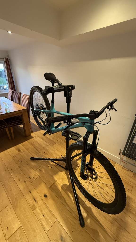

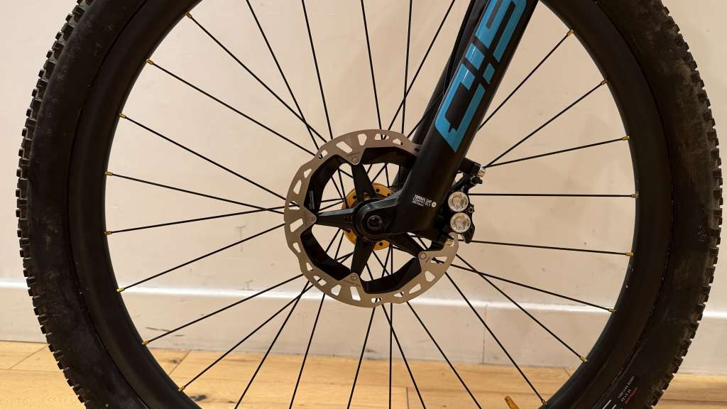

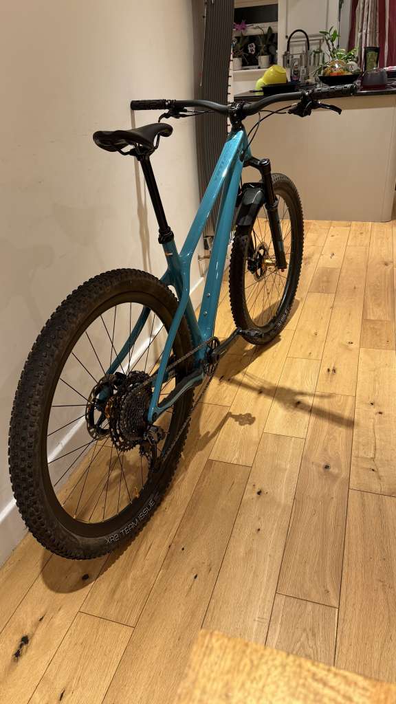

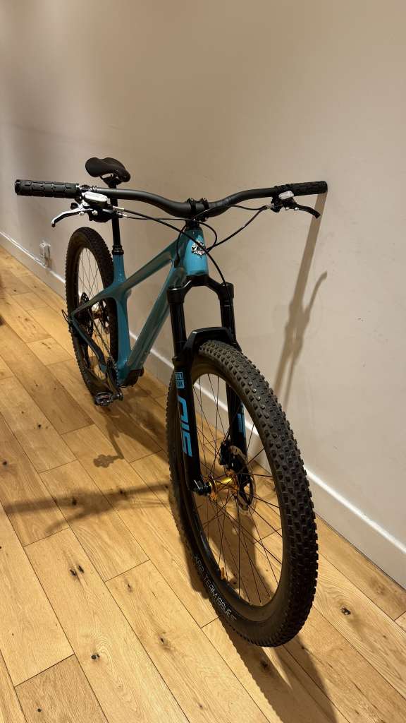

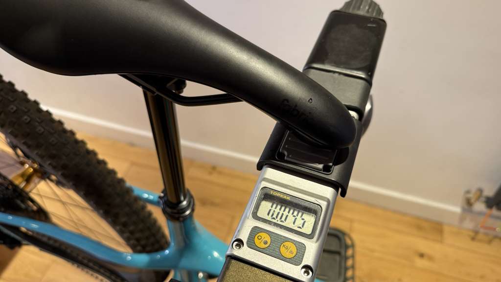

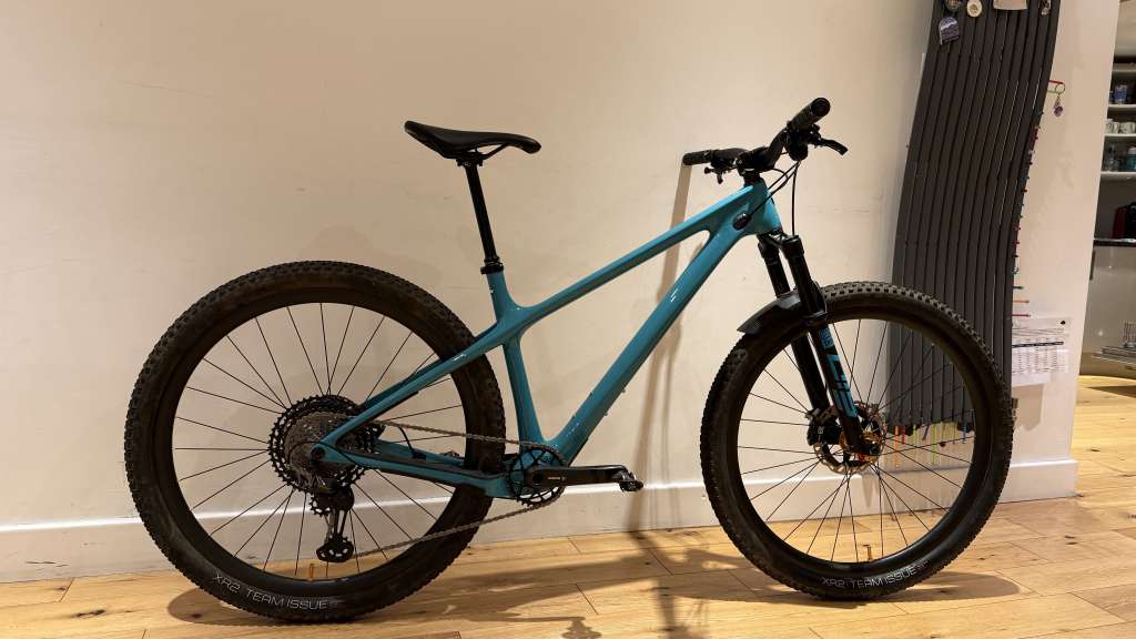

I’ve been hankering after one of these for a while and managed to snag a pre Christmas bargain on a frame and fork.
Just a smidge over 10kg for a 130mm hardtail is okay in my book.  If it turns into a keeper, I’ll swap the HS and BB for some CK, but these are what it came with.
First ride tomorrow.  The XR2s may be a little ambitious, but I can swap out wheels from the other bikes if needed.

Tidy but have to mark you down for the skirting board in the first picture.
A few marks on that that need cleaning/ re painting.
Bike looks great though.

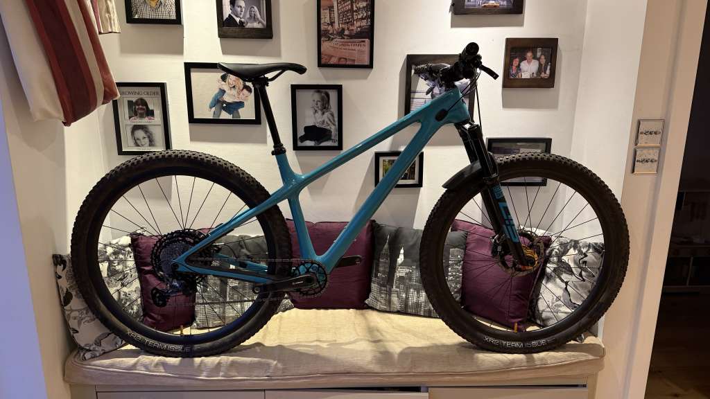

Better?

…was my first question when buying it.  But, yes.  130mm SIDs. Checked with the buyer and the bikeshop who did the work under the advice of SRAM.  130mm measured on arrival and they do fully compress.

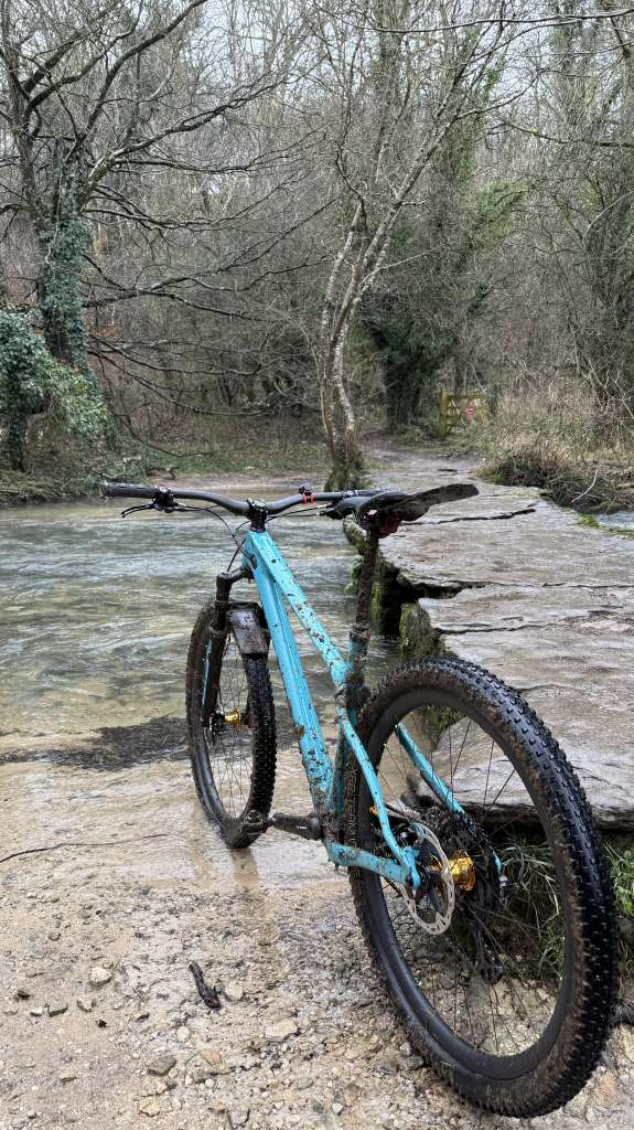

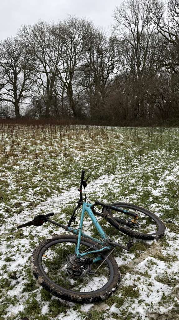

Well, it’s comfortable, capable, fast and fun!  Like a Chameleon, but without the piledriver feeling.
The XR2s coped surprisingly well, but were totally overwhelmed by the recently logged section.  Mud doughnuts and sliding everywhere.
Definitely a keeper (sorry Titus)…oh, and I’ve cleaned, sanded and painted the skirting board…you b4stards.
IMG_8363IMG_8366IMG_8364

Lawn needs sorting in that top pic....

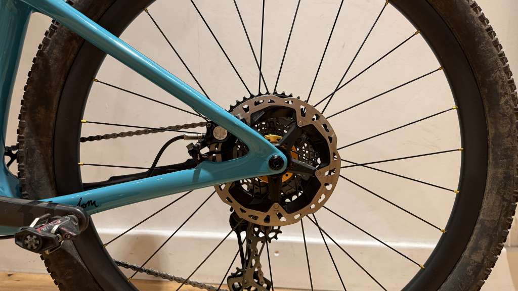

  • Large Turq Frame
  • SID fork adapted to 130mm
  • XTR drivetrain with a 10-51, but with a SRAM X1 crank (lighter, cheaper, no special tools  and easier to get chainrings) with a Wolftooth 34t Chainring
  • Chris King, Nextie, CX-ray wheelset (1.4kg)
  • Hope Tech4 E4/X2 (E4 wont fit in the rear of the YETI -grrr) brakse with XTR 180mm rotors

The XTR drivetrain saves over 500g vs GX AXS, the SID over 300g vs a 34, the wheelset over 350g vs a DT 1700 and the tyres over 500g on what's most commonly specced.   The fabric saddle will be swapped with a lighter one soon which will drop it under 10kg.  Mine was also weighed (as per photo) without pedals as that how I (and manufacturers) have always weighed bikes, but most folks don't.

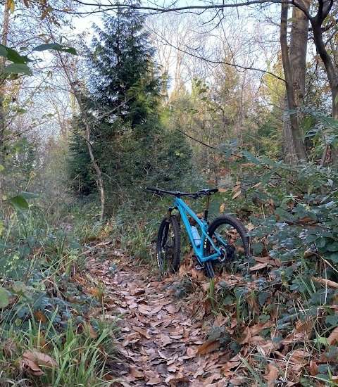

Nice!
I'm about about 2 years in with mine and couldn't be happier.  This one runs Fox 34 120mm Factory SC, XT/R 12sp, DT XMC1200 wheels, 125mm dropper, 60mm stem, a flat-ish Next bar and 2.4 Rekons... about 10.5kg with pedals.
I'm an XC kinda rider and so this build is a touch more capable on rougher trails with a tiny bit lost on uphill and flat, compared to my last 100mm skinny hardtail.
IMG_0387 (1)
