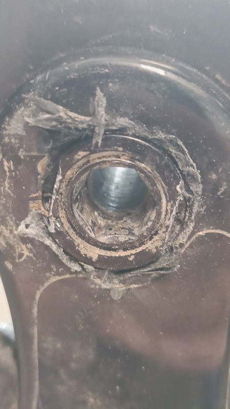

Bearings appear to be fine. I packed mine with stodgy grease prior to the build to protect against water ingress and there doesnt appear to be significant wear from use either.

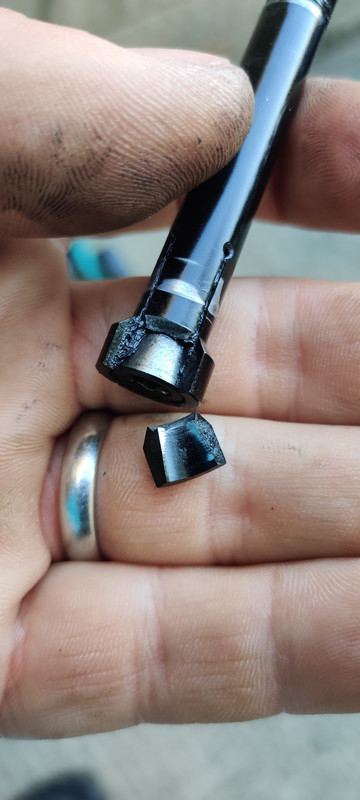

My shock linkage clevis bolt did fail early on and as I've said, the torque on the pivot bolts seems to need a bit more than specified to stop them creaking.

Yep, mine is excactly the same. Did you get a new one from Bird? I've filled in a form for warranty, again. I should probably tell them about the shock bolt too
Posted : 19/11/2021 3:59 pm
Posts: 7915
I just emailed them that picture and asked for another one, which they were kind enough to supply. I then knackered the new one by not realising my life-line torque wrench doesn't do torque in reverse!

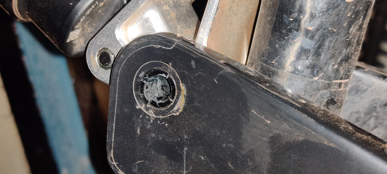

I've just finished changing the bearings for the second time in less than a year. This bike does get some pretty rough treatment, but I'd like a bit better longevity than that. The Enduro BO bearings haven't lasted noticeably better than the originals. I'll be trying stainless max compliment bearings next time.
I have broken a second pivot bolt, again at the bottom of the link / top of chainstay. The replacement from Bird is slightly different. On the old setup the inner expansion bolt the wedge taper went all the way to the threads. On the new one it steps in a bit. Photo on Insta here:
And the serviced Fox DPX2 has a horrible rattle sound, which apparently may be the glide ring in the damper, so that's going back to the service centre. 😤

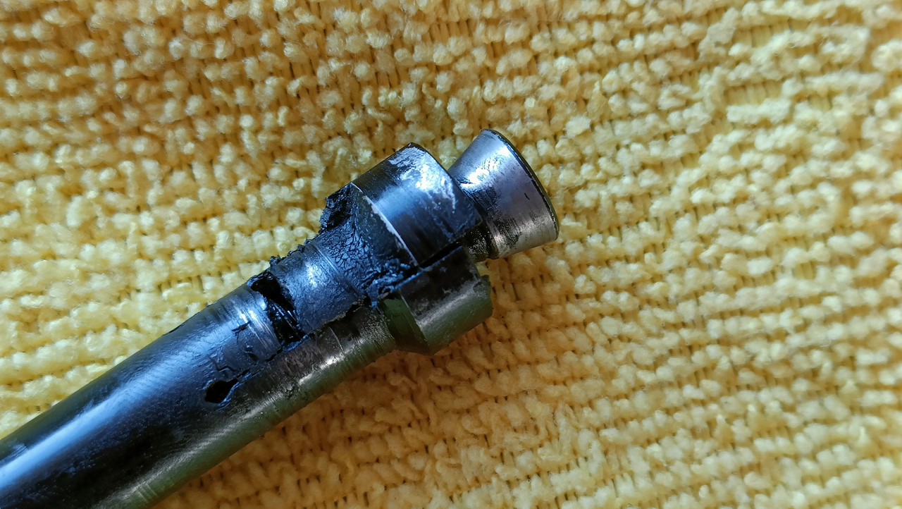

Timely, because Wednesday saw me blow the 4th pivot axle in the same location. It's the rocker link/seat stay pivot. Whats a kicker its that they're presently out of stock.
blown pivot
Last time, I took the bike to Bird for them to look at, they changed the axle to a collet with a different taper, but it's lasted the least amount of time.
Further investigations by them after I drop the bike to them next week. I hope they find the cause because its not fit for purpose if it breaks pivot hardware every month.
I can't deny it isn't a pain in the arse to drive it to them, or be without a bike in good riding weather, but they're treating me fairly and its appreciated.
In the meantime, all my bearings are ok with the exception of the Horst link bearings, which were a touch rusty, but not so bad they couldn't be saved with more grease.

That broken pivot bolt is now replaced with a steel one which seems to have solved the problem entirely.

Well funny you should ask... In response to your post I thought I really ought to get a move on and get it stripped down, cleaned up and listed properly. The trouble was the blasted thing decided to throw some more quirks at me.
The pivot 'nuts' are not bonded to the frame parts at either the main pivot or the swinglink/chainstay pivot. The nuts have very small flat sections that are meant to brace the torque when. When trying to undo the main pivot the nut just span in the frame, chewing up the carbon.
In same ways I am fortunate to have a spare chainstay and pivot hardware from the first round of warranty replacement shenanigans. With this in my back pocket I unhappily set to cutting the chainstay off the pivot.
I then also discovered another broken collet bolt at the swinglink/chainstay pivot. I have broken three of these now. Experience has taught me to have a spare in stock.
The only pleasant surprise from the rebuild was that all the bearings were in good shape. I will be including a set of spares with the frame when it is listed.
So now the frame is cleaned up and rebuilt and as good as new. The trouble is that in my opinion it really isn't good enough. I could not recommend this frame to anyone, and it will be listed for sale on ebay. I haven't tried the alloy one, but I hope it is better. I am happy I have new frame and don't have to persevere with this anymore.
