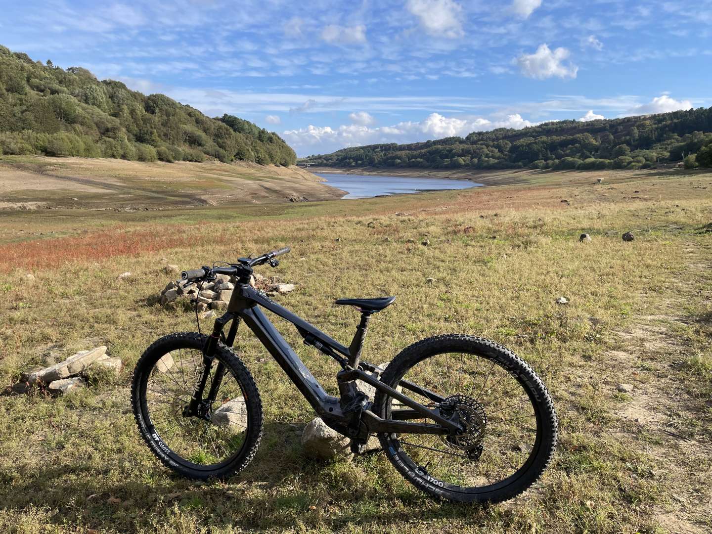

So courtesy of the PSA thread and Rockhopper70's lengthy search for a new eBike, I ended up buying a new Canyon Neuron Onfly CF7 in their sale myself, and have subtly upgraded it with a few of my own existing parts... After fully ignoring Canyon's size recommendations (thank god, cos at 1m78 they have me firmly on a medium, and this is a Large and I wouldn't really want it any smaller!) I ordered the cheapest one knowing I was going to customise it. Got hold of a Merlin special "paint defect" Fox 36 knowing I already had the correct shorter air shaft to go on it, and resurrected my old X01 mechanical Eagle groupset and Mavic Deemax's etc... I had bought a cut price Ohlins TTX2 shock to go on it too, but sadly due to a peculiarity in Canyon's frame design the Ohlins shock doesn't fit (so if anybody wants a half price brand new 210x55 Ohlins TTX2 shock give me a shout!), but never mind...
So how does it ride...? Really rather bloody well actually! Being honest, it doesn't feel like a 140mm travel bike, probably more like a 120-130 bike, at least with that stock shock, but that's no bad thing for what I want anyway... I have a 150/160 full fat eBike too, and I wanted something lighter and more responsive for flatter more local trails, and the Bosch SX motor is awesome for that too. The geometry (at least after ignoring Canyon's sizing chart) is bang on, it's really well balanced with an almost perfect 1.8:1 Front to rear ratio (I've measured wheelbase myself @ 1275mm and chainstays @ 453mm, which gives 1.815:1 which ironically is identical to my Mondraker Crafty!) and a Head Angle a touch over 64deg.. The 200mm drop seatpost is a superb touch too, never had the clearance for anything longer than 175 on a bike before and really appreciating the full 200mm drop!
All up weight as is including pedals is 20.5kg (so under 20kg exc. pedals as everyone weighs their bikes)... It feels lighter I'll be honest. Definitely feels closer handling and weight wise to a conventional MTB than it does to a full fat, yet with 600W peak power still (accessed at a ludicrous 108rpm cadence!) it'll drop many full fat ebikes on the trails still (at least as long as they haven't been derestricted and before the 400Wh battery runs out!) and it's a lot less draggy above the 15.5mph cutoff too...
Oh, and as complete luck would have it... First ride out on it it ticked onto 0% range just as I arrived back at my car, after 24 miles and just over 1000m of climbing! 😂 And for anyone still in the "eBikes are for lazy people" persuasion, check out those HR zones... 👍🏻

I'd look at normal person-powered bikes all the time thinking, 'That's a nice-looking bike,' but rarely do I look at an e-bike and think they look that nice; however, as e-bikes go, that is tidy-looking!
Posted : 16/09/2025 6:34 am
Posts: 3610
Nice, especially like the Mavic yellow hubs and the single yellow spoke.
Posted : 16/09/2025 6:45 am
Posts: 824
I like that. Definitely one of the nicer looking eBikes. Good to hear it rides well and you're happy with it too.
Posted : 16/09/2025 9:18 am
Posts: 8842
Nice bike. Looks fast.
no wonder he wanted to fit the ohlins, wouldve worked nicely with the yellow!

Cheers! It's one of, if not the least, eBike looking eBikes that I've seen myself too. A lower torque motor and 400Wh battery are much easier to hide than their full fat counterparts for sure, but from a few metres away, you've really got to know what you're looking for to spot that it's an eBike at all from a side profile at least...
