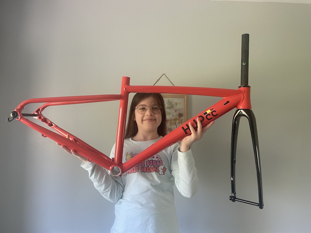

Sophie has out grown her 24 inch wheel'd road bike so the bike fairies dropped off this Hup Straatrace 37cm frame this morning. Colour is more orange than red which is a bit disappointing but hey ho.
Will be getting a 1x GRX 810 groupset minus the crank and some Elite wheels (whenever they get delivered).  Got spare wheels so will put them on for the time being.
Frame is 1390 g
Fork uncut 450 g
Specs say 30mm max tyres but it fits 32 mm without any issue and could go a bit bigger.
We need to think about stem length though.  34cm Hup bar
bought from Kids racing.

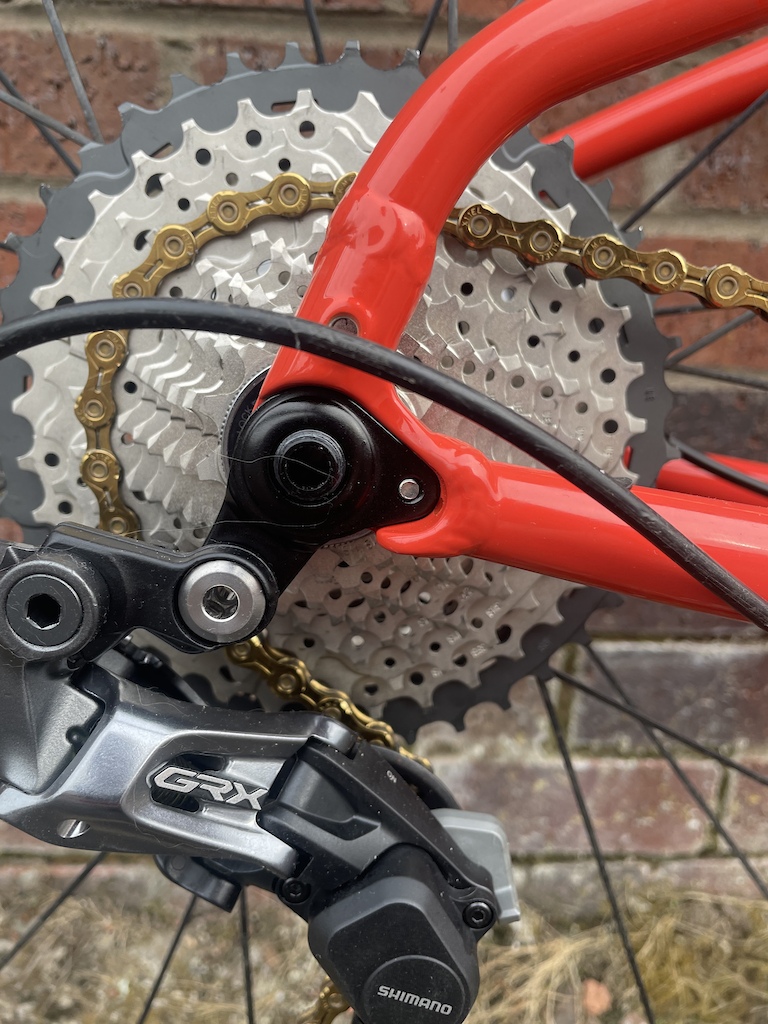

 poah
Posts: 6494
almost finished.  brakes are being a pain though.  clearly road levers only want to accept shimano barbs by the looks of it.  barbs that were fine with the MTB levers not happy in the road lever.

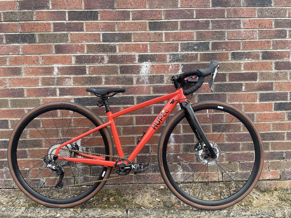

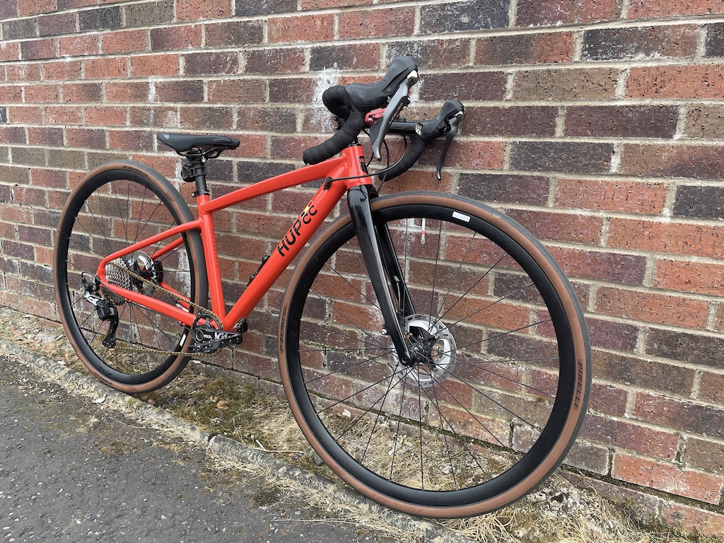

 poah
Posts: 6494
Finished - just have to wait on wheels coming so spare alu ones till they arrive.
Tyres are Pirelli P zero race TLR with ridenow TPU tubes.
Posted : 12/04/2025 5:47 pm

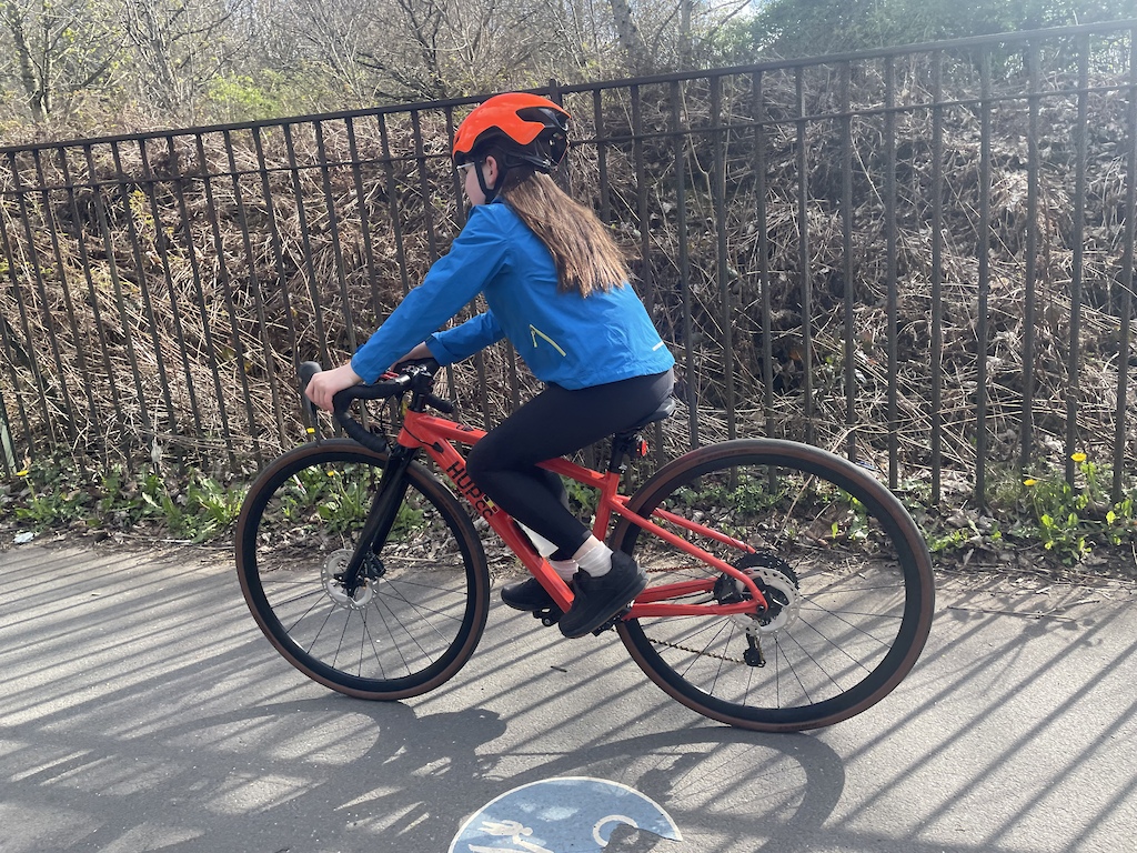

Posts: 10213
That looks cool - are they 700c wheels or something smaller? Whats the cassette / size of chainring on there?
Is Sophie pleased?
Posted : 14/04/2025 7:20 am
 poah
Posts: 6494
700c wheel
11-40 casstte
26t chainring.
super happy
