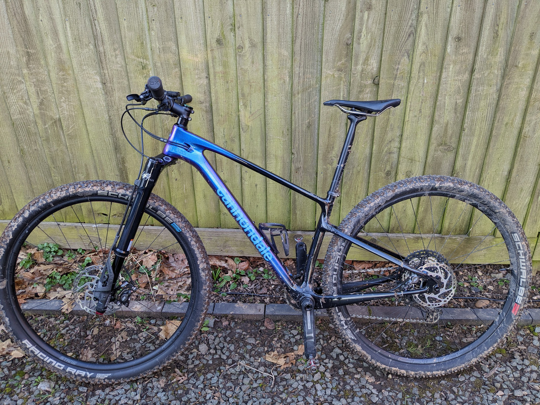

That looks lovely - enjoy! It's weird that both Scott and Cannondale have gone for a very similar paint job - nice flake front end fading to black. I'd normally be slogging through the mud on my steel singlespeed at this time of year, but the trails are so dry I've been out on the Scalpel - again, the pic doesn't really do justice to the paint.
