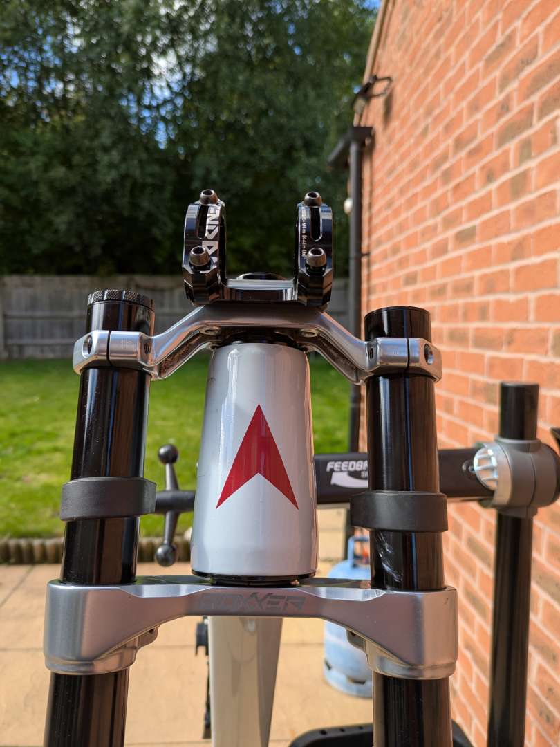

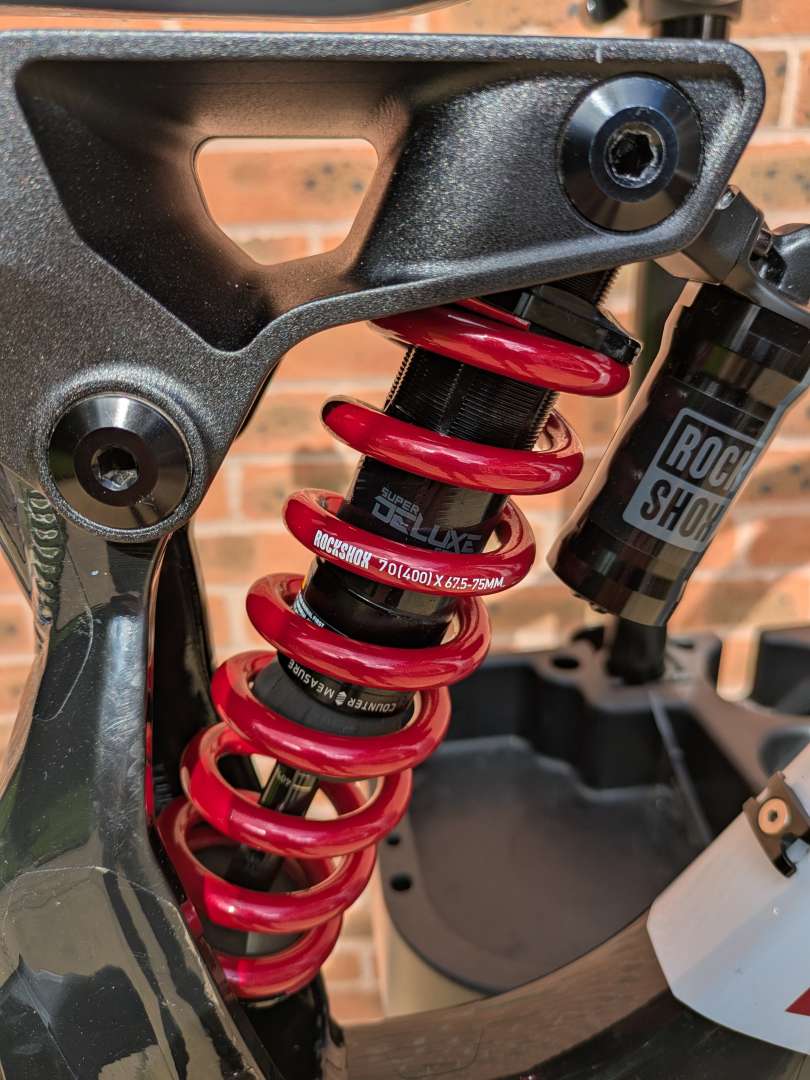

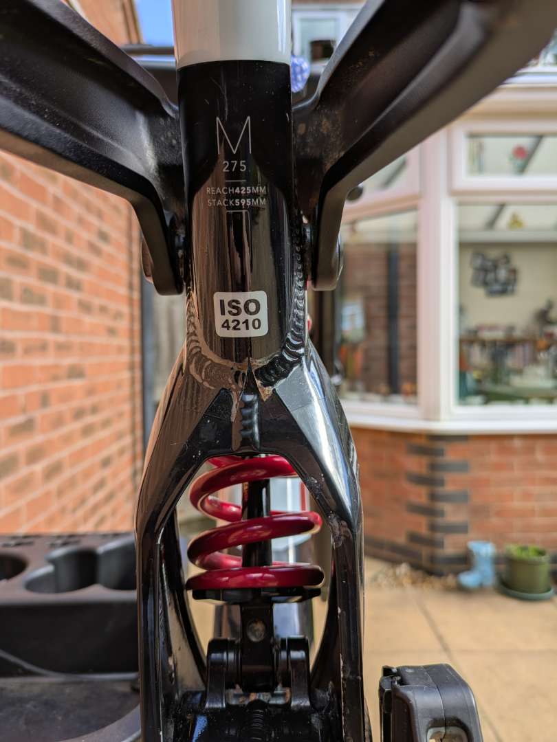

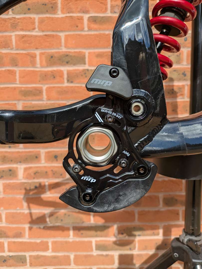

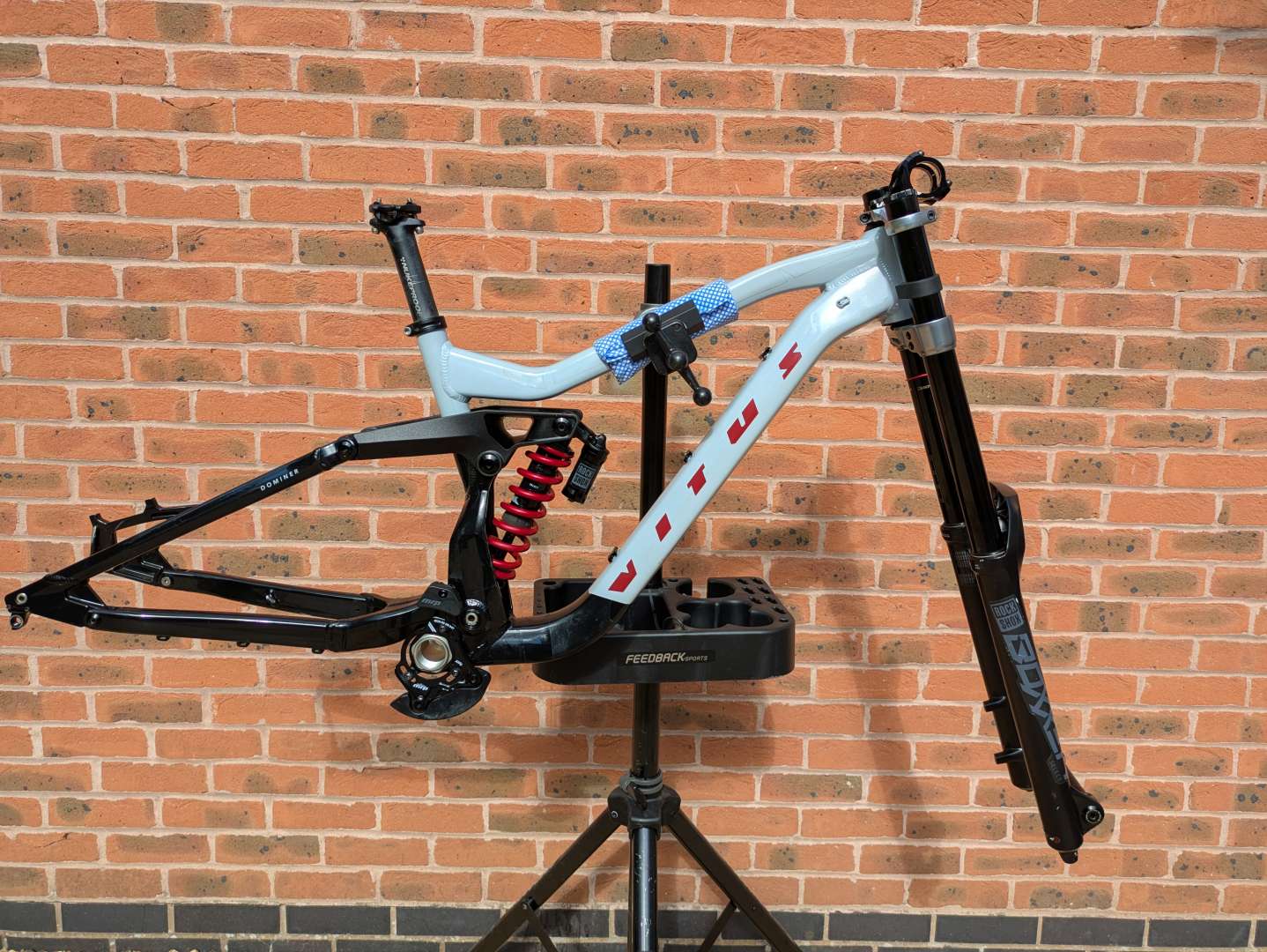

Posts: 3754
So we haven't done much to the current bike other than maintenance and messing with fork & shock settings to get a better ride.
It's still riding well and going strong.
It is getting a bit small though.... the joy of kids growing lol
So we decided that by the start of next race season it'll be too small and we'd need something bigger.
I'd enquired about a couple of frames on Pinkbike & a couple of other site but was being messed around so decided to avoid (especially after being scammed over some wheels).

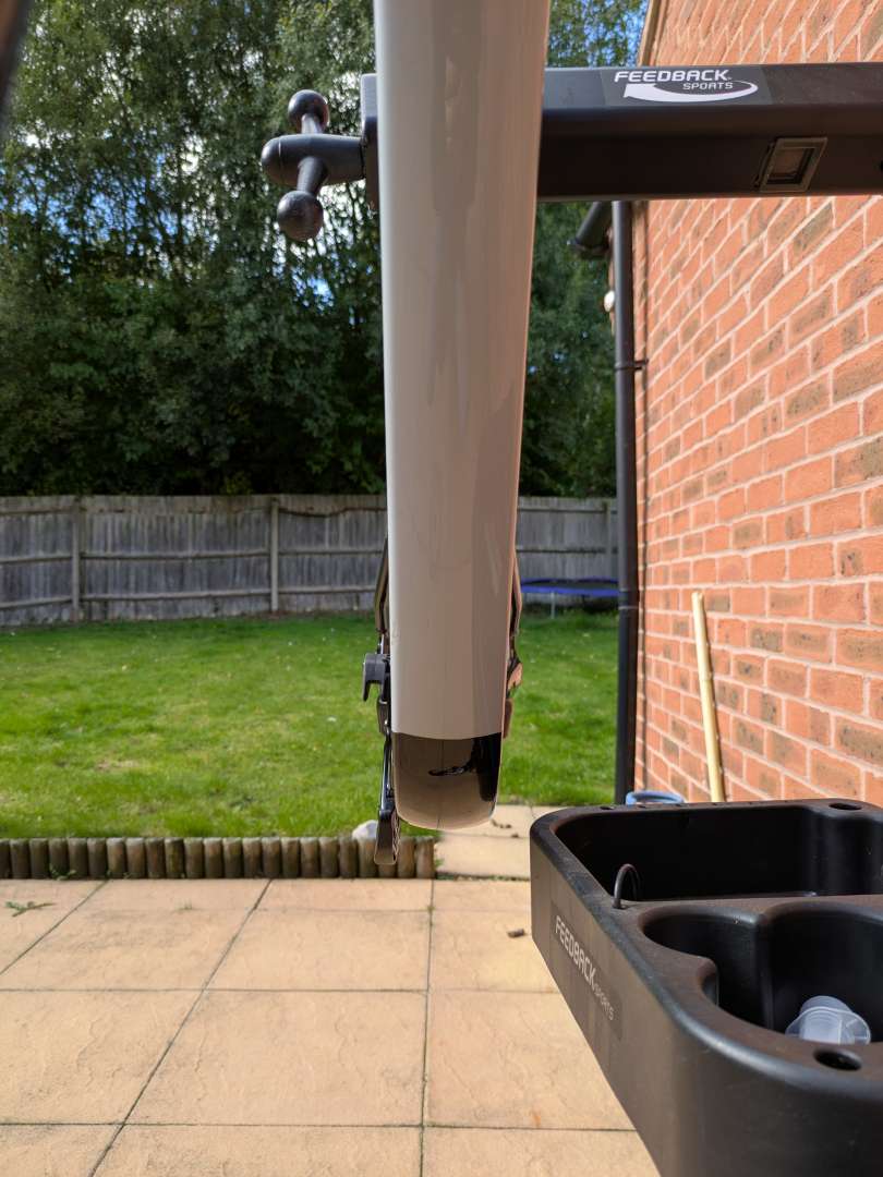

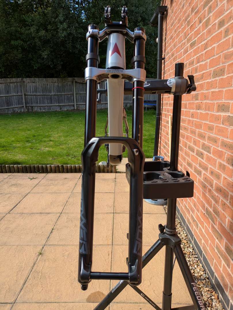

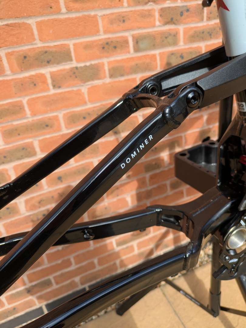

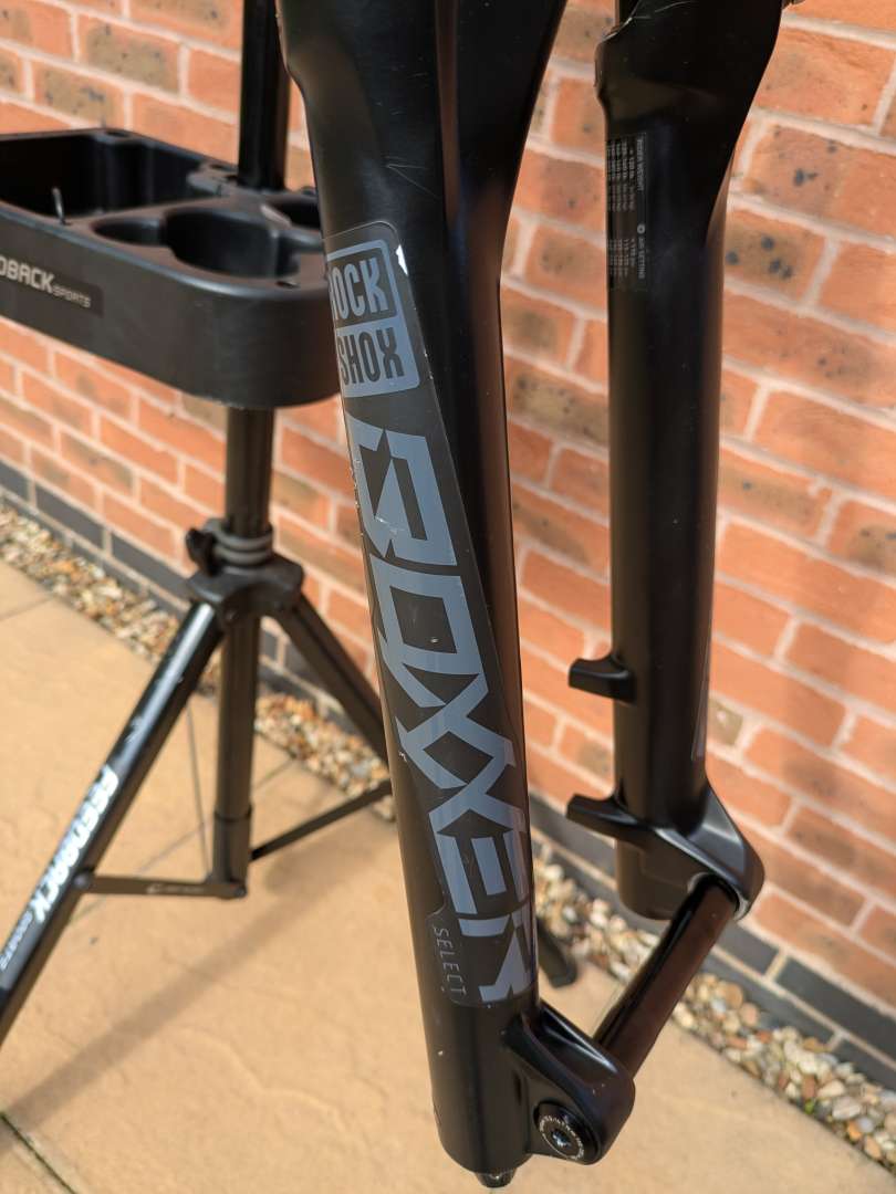

Stile Cop race last Sunday had a few people selling stuff and came across a 2022 Vitus Dominer frame with shock and forks for a not too bad price. I kept looking at it throughout the day and must have bored the seller with umpteen questions.
Well at the end of the racing I decided to see if I could strike a deal.
After a bit of haggling we came to an arrangement, and we now have next seasons bike sorted:
Super clean, invisiframed from new and any stone chips have been touched up.
I've ordered a 275lb spring for the shock, so hopefully that'll arrive fairly soon.
Plan is to swap most of the parts off the current set up and sell that as frame, forks & wheels.
She's going to do the last 2 races on the Commencal and then we'll strip it down and build up the Vitus.

Looks nicely looked after. You going to check/service all the bearings before racing it?
Posted : 23/09/2025 12:49 pm
dirkpitt74 reacted
Posts: 3754
Yeah will give it a good looking over and check bearings.
Will get some spares too.
Posted : 23/09/2025 1:02 pm

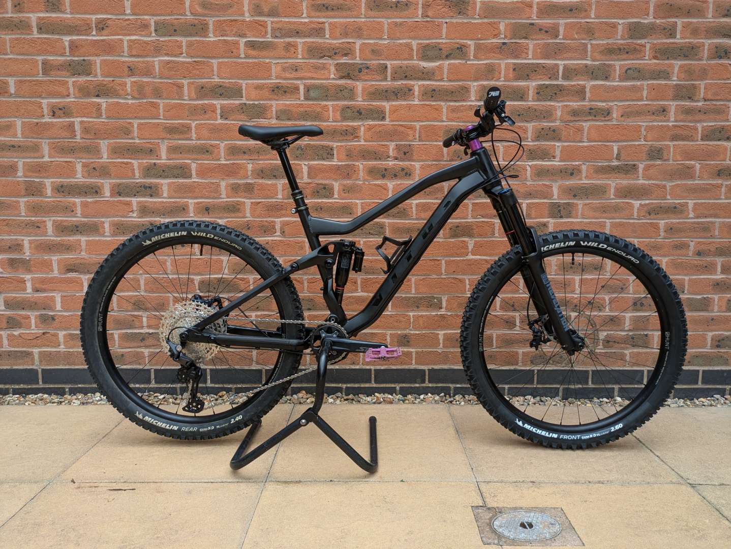

Funnily enough I built her a Sommet (160 Enduro sled) earlier in the year to replace the Escarpe she'd outgrown.

Vitus made decent bikes. The escarpe and the more enduro one I forgot about looked like skinny versions of this. Quite simple (in a good way) so should be easy enough to keep running through a season or two
The alu Sommet and Escarpe share the same front triangle. That Dominer front triangle looks suspiciously similar/the same as well!
Those Sommet black on black frames were warranty frames (before the closing down sale) dished out to those who snapped the rear ends of Escarpes (fairly common). A lad I know got one that way! The Sommets have a heavy/stronger rear triangle and don't seem to be as prone to snapping as the Escarpe.
