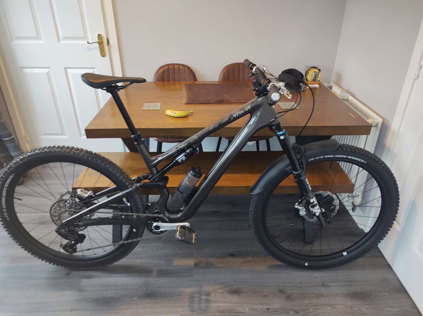

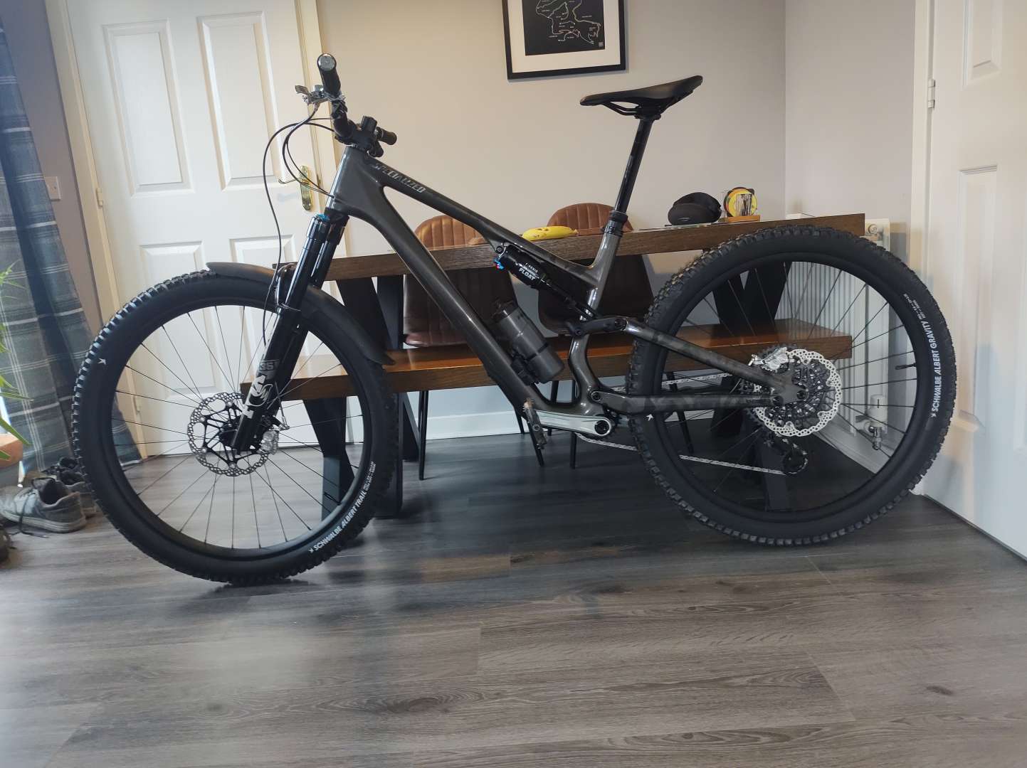

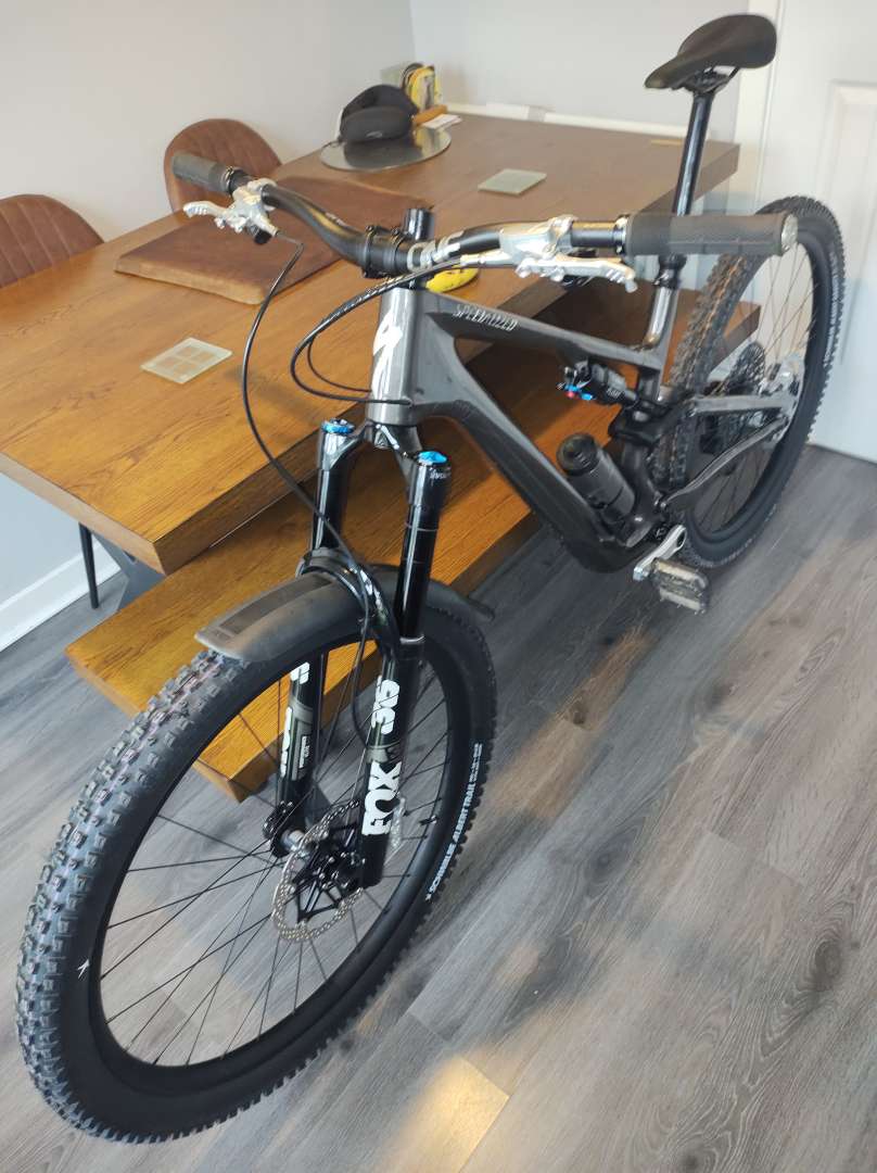

New Bike Day for me last Friday.
Been busy riding other bikes so only just got round to posting this up.
Stumpy15 Expert with a few bits swapped out.
Not a massive fan of SRAM brakes so despite the Mavens feels ok on the test bike I tried I went with my go to brake of the moment the Hope Tech 4 V4 .

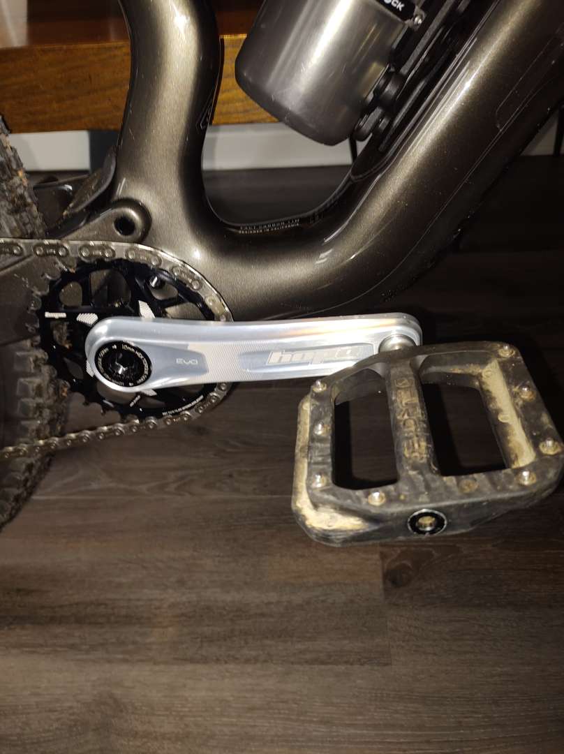

The BB is pretty low on it and after having a few pedal strikes on the test I went for a shorter crank. Hope 155 mm and lowered the gearing from a 32 to a 30.

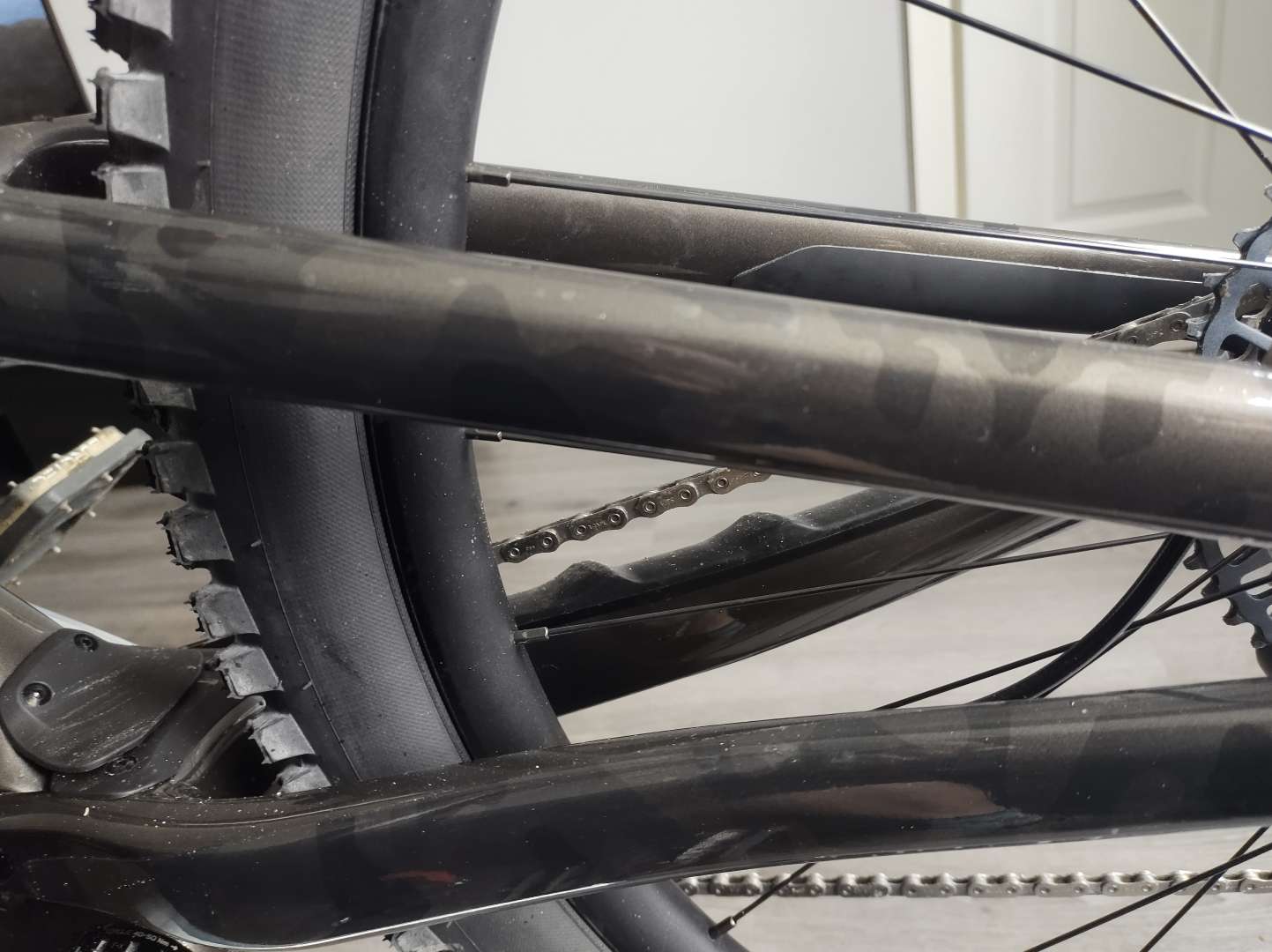

Not 100% sure if I'll stick with the 30t as the chain is pretty close to the chainstays. If it turns out to be a bit slappy I'll jump back up to a 32.
Also had to have a new BB to fit the crank so went with a Hope for that too.
Had a tyre swap to Alberts, Trail Utrasoft front , Gravity Soft rear.
Fitted my bar of choice the One-up carbon.
Slapped a Dyebros frame protection kit on it and then gave it a Gtechniq ceramic coating treatment.
Not going to ride it until later in the week to give the ceramic time to bond to the frame properly.
Just had a very quick spin round on it and taken it off a jump the junior division of the local Endurobros have built at the back of our house to get me started on setting the suspension up.🤣

Posts: 2154
If I'm being picky, the trainers on the floor need tidying away, and the curtain to the left of the door is not hanging quite straight.
Nice bike.

Posts: 182
V. nice. The bike, not the banana.

Posts: 1671
Solid looking table and bench. Decent banana, would have preferred it a bit closer to the bike.
Other than less strikes, do the 155 cranks feel different? Or is it not really noticeable?
Posted : 09/06/2025 4:46 pm
Posts: 17762
Posted by: Tom83
Not really much different to me but I do have 155's on my Eeber so I'm used to them from that.
Rode my Enduro bike this morning which has 165's then when I jumped on this it didn't really feel that different. It's more noticeable switching from 155 back to 165 for some reason.

Posts: 8691
Nice bike, is the genie good or a novelty?  Sounds like a good idea on paper
One gold star to whoever left you a decent amount of steerer to play with.
Posted : 09/06/2025 5:23 pm
Posts: 17762
Posted by: Rubber_Buccaneer
I'll let you know after I've played around with settings.
The test ride left me confident I could get it working well for me but time will tell.
Got a bag full of Genie spacers as well as end stroke ramp up spacers to experiment with.

Posts: 8848
All the grey leaves it a little cold looking. Needs more contrast in fittings. Same for the bike.

Posts: 14293
Posted by: singlespeedstu
Have you got the BB in the high or low set up?
On my G3 Levo, I put the -1deg headset cup in and left the BB in the high setting and happy with how it rides. Obvs slightly different geo to your bike, but similar

Posts: 17762
To address a few questions.
What's a Dull Mens Club? 😉
BB is in high with the headset in slack. Test bike was in middle headset and high rear.(My Levo is fully slacked with a longer fork)
The 155 cranks have totally removed any pedal strike problems and don't seem to have affected the power to any great extent.
