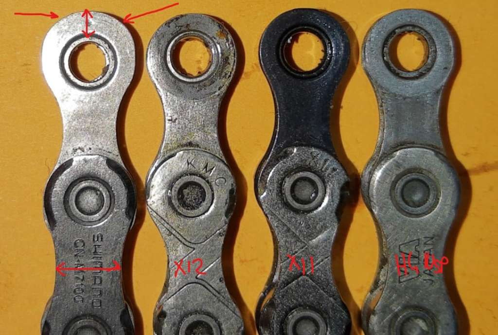

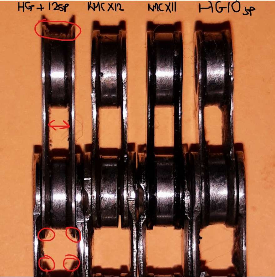

chain comparison:
chain3
Chain4
yon can see the difference here - which is why when it is mucky some people run sram 12sp chains on shimano to get more mud clearance - longer inner plates and slightly narrower rollers - both of which are sized/shaped to mesh with Shimano tooth profile.
Chain1
should really use a chainring that is stated as 12sp shimano compatible.
Posted : 17/03/2024 10:08 pm
