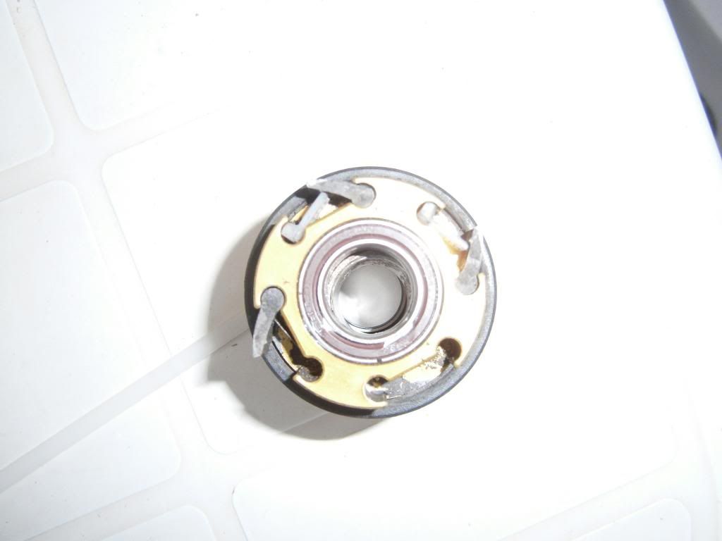

With the new clutch mech I now have a stealth bike.
Bound to cost me money I recon.

Pawls and springs? Shouldn't cost a lot to fix.
Posted : 01/02/2013 7:36 pm
Posts: 119
Snapped paw springs or loads of crud
But easy and cheap either way

mine did that about 3 yrs ago, with the same diagnosis of doom and gloom. pawls and springs were fine and are still fine 3 yrs later though it went back to its usual volume after being dismantle and reassembled.

Just take the freehub off and take a look.

Mine did the same, took apart regreased and all good. Now been running for 7 years with 1 regrease.

You should have a look at that. If there are little bits of broken spring floating around they will cause damage
Posted : 01/02/2013 8:00 pm
Posts: 507
Not just damage, possibly a long walk with a freewheeling bike too.
Posted : 02/02/2013 8:16 am
Yep, a few quid for new springs now, or potentially having to send your wheel back to Hope to get a new ratchet fitted to the hub later.
Disassemble now while it's easy!

Mine went quiet had a look in and I was only running on 1 pawl. Have a look in there, may save a loooong walk.
Posted : 02/02/2013 9:40 am
It's nice and simple to check. Hope sent me free replacements when mine went (and more free reoplacements when those went in rather short order!)
TBH it's worth removing the freehub from time to time and giving it a clean anyway, the "seal" between the shell and hub is pretty poor, more of a shield than a seal. Helps keep everything ticking over nicely.

I don't know if Hope changed their supplier, but their springs don't seem to last long.
I put in some pieces of foam instead and its been running fine.

Happened to me in France last summer, (no Hope dealers in Aveyron) 2 springs broken and 1 pawl missing completely. Previous owner said it had just been serviced by LBS. Aren't cable ties BRILLIANT!

Hope recommend oil, not grease. As do I.

2 snapped springs and one paw missing.
A little bit of 3in1 and now back to 110 decibels.
