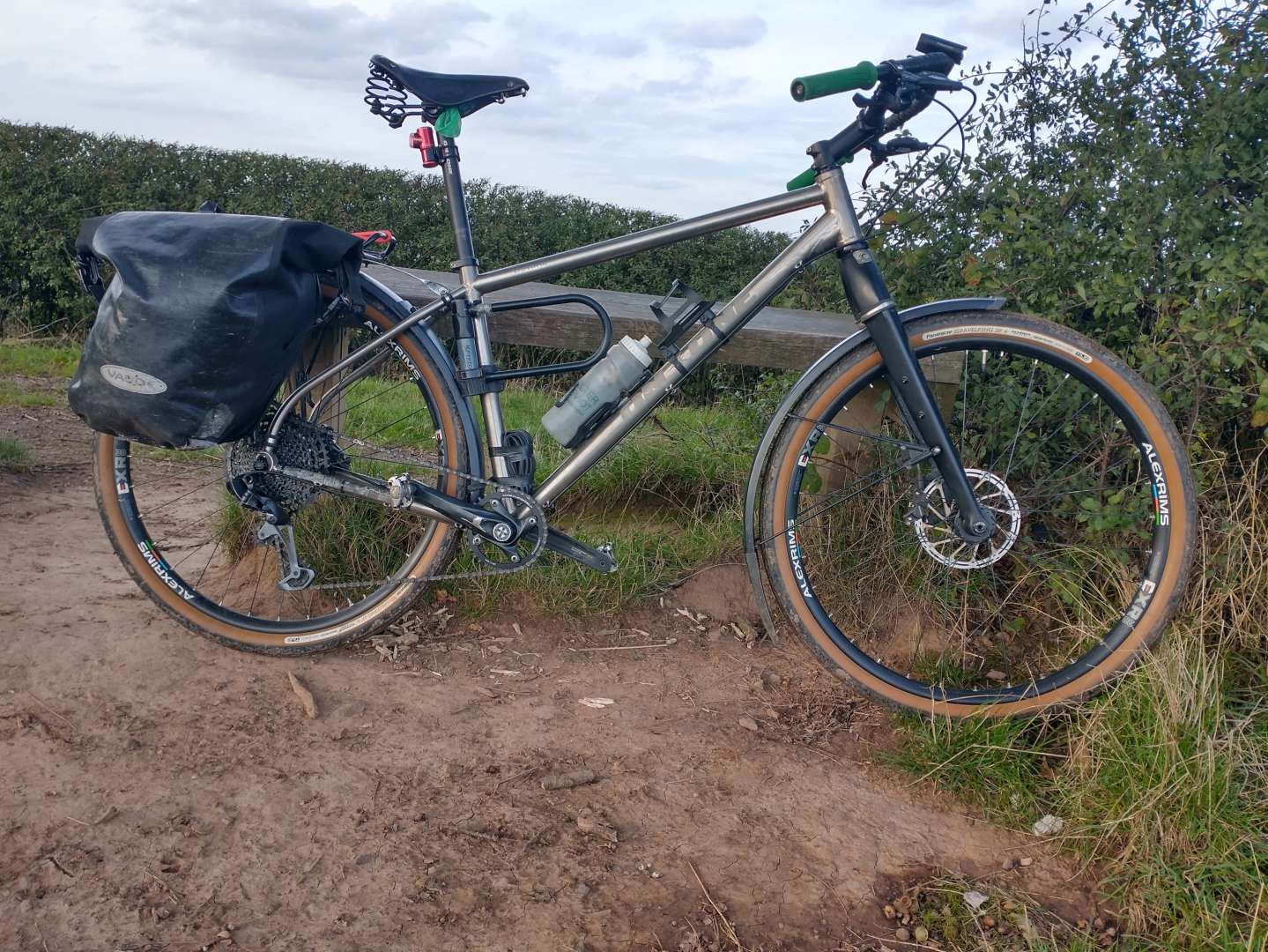

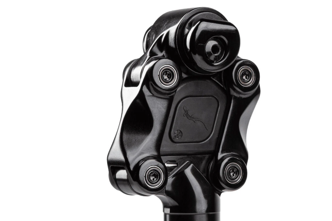

So, I could just extend the post a little more... The problem is that my post (Cane Creek Thudbuster) has a minimum insertion limit of 100mm, which is very large for its length (345mm). If I ignored that recommendation and went to 90mm, all would be fine, and it would still have more insertion than normally recommended. Plus, I'm under 80kg, and the Thudbuster has a weight limit of 150kg!
What worries me is the frame. It looks like the below, so the top-tube is a fair distance from the top of the seatpost. Currently, my post is perhaps 5mm beyond the bottom weld of the top-tube. Is it OK for the frame to have any less insertion?
That would be my solution. From the frames perspective if most posts are only 'give' it 80mm, 90mm should be ok.

Main thing is that the end of the post is below the bottom of the junction of the top tube and seat tube.

If there's more than 50mm in the frame and it's below the bottom weld of the top tube I'd just use it.*

So, I've raised it so the insertion is 90mm, rather than the recommended 100mm (which is still way more than the 63.5mm Thomson recommend for their 330mm x 27.2mm posts).
But... it is no longer below the bottom weld of the top-tube-seat-tube junction. It's just above it. It is, however, 5mm below the small internal hole in the seatube, which goes to the top-tube. I'm hoping that will be fine... It is 853 steel tubing, and I'm average weight.

It is a tricky one - with it being a Thudbuster, the heavy bump loads will be at reduced leverage due to the compression of the post.
You do have 90mm insertion, but it is slightly crappified insertion due to the large amount of exposed seat tube above the top tube. The first frame I made cracked there and I now build with the minimum possible seat tube above the TT, and also double the thickness with an external sleeve. I presume you have a butted seat tube, so it would be good to measure the wall thickness.

Alpkit exorail
Ah, damnit, that would be perfect, but unfortunately not compatible with the Cane Creek clamp...

More serious suggestion than bling pedals is could you lengthen the seatpost?
I did wonder this. I thought someone may make some sort of compression plug like thing for exactly this purpose, but my post seems to have an internal lip at the end that would prevent this anyway.

The older thudbusters had more normal clamps and seem to be longer - see bikeinn
Yea, it's annoying
It seems like the only (aluminium) suspension post Cane Creek now make short is the Thudbuster ST in 27.2mm
The Thudbuster ST in larger diameters is longer, as it the eeSilk+ and Thudbuster LT in all diameters...
