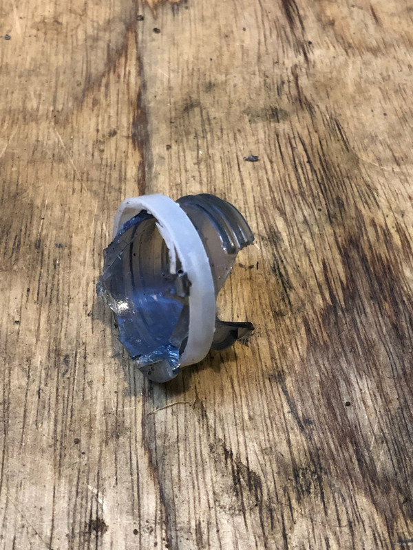

I've been living in fear of my ghetto 9p tubeless inflator exploding ever since I made it. There's a lot of stored energy and I always wondered what would happen if it went boom. But it's seated numerous tyres over the last decade, so it's had a good life. Anyway, today it started slowly leaking air due to a tiny crack in the cap, so I couldn't get it above 100psi. I was grateful it hadn't exploded so I popped to the shop to get a new bottle (for the record, a Co-op sparkling mineral water bottle for 49p).
Got it home, drilled some holes, pumped it up. On the first attempt, the tyre didn't seat. Damn. More pressure needed. I was aiming for 120 psi but at 110psi... BANG! It made me jump but it didn't kill me or anything. I don't think there's even any mild tinnitus. Something whipped up and caught me on the hand though, which is kinda sore.
What I think is kinda interesting is the way the thing broke. I don't know where the initial rupture was, but the top cap split, the top part of the bottle sheared off, the main body of the bottle split in many directions, and there's a separate (not connected) hole in the bottom of the bottle.
So, at least I didn't die, but I think I may have been a bit lucky. It wasn't as loud as it could have been, but something hurt my hand and I suspect if I'd been in a different place I could have been hurt. On balance I'm more scared of the same thing happening again so I might invest in an airshot type thing.
Sidenote: In retrospect, my 2021 bottle was a lot thinner than the one I bought a few years ago. I supposed we should be grateful that less non-reusable plastic is used in today's bottles but my experience today suggests it's not as good for ghetto tubeless.

Yeah, I did that on my old one. I couldn't find my duct tape so I didn't bother this time round 😐
However, I'm not sure that the tape would actually prevent the plastic from stretching. Duct tape can be stretched a bit - I'd have thought the plastic might split before that amount of stretch.

A 2 litre PET bottle should hold 120psi. The picture appears to show that the neck area has gone - faulty preform, I'd say. I'm more worried about the cap blowing off than the bottle exploding. Mine is about 5 years old and still going strong. 1.5L bottles are stronger, FWIW. They are often blown from the same weight preform as the 2L. However, you don't see many in the UK. As long as you use a bottle which contained a carbonated product you should be fine up to 100psi.

Really you want your tank to be capable of withstanding 1.5 times it's operating pressure.

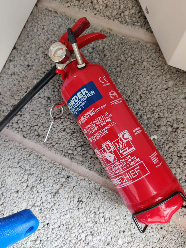

Little lockdown project. From this;
To this;
Total cost was £13 plus an old innertube and took about 30 mins.
The extinguisher is tested to about 370psi and pressurised with powder to around 270psi (if memory serves correctly). So tubeless at 180psi or below shouldn't be a problem IMO.
Extinguisher here;
https://www.screwfix.com/p/firechief-dry-powder-vehicle-fire-extinguisher-600g/91740?_requestid=726409
Works better than my tubeless pump to be honest. Mainly as it stores more air.
Posted : 13/03/2021 11:03 pm
The extinguisher is tested to about 370psi and pressurised with powder to around 270psi (if memory serves correctly). So tubeless at 180psi or below shouldn’t be a problem IMO.
Except you've just drilled a randomly sized hole in a random place on the pressure vessel so those ratings now count for sod all. It's probably fine but I wouldn't rely on those figures for anything now.
I have a big (5l?) CO2 bottle, I used the test port to fit a schraeder valve for filling and converted the horn connection to accept a quick release schraeder head. No drilling required, just a lot of converter pieces!

Why drill it? Pull the handle or put a band around it and you can fill it via the outlet. Just needs a T and a isolate valve. But yes way better than a pop bottle.
