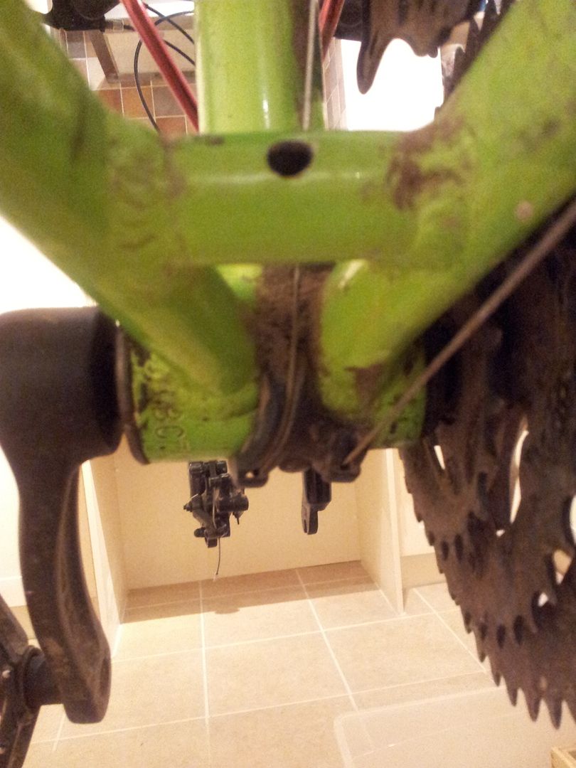

Component breakdown:
Saddle clearly too large for an 8yo bottom. Replacing.
Seatpost passable. Would like a lighter one but not high on the priority list.
Seat clamp: the bolt is a little rusted but this is a QR clamp that still works. Unless someone has a purple anodised one for the right price, keeping.
Shifters: clearly had water in, seen better days. Currently 3x7 but I'm going 1x and my son wants a trigger not grip shift, so replacing.
Brake levers: mechanical, bit too big for little hands to be honest.
Bars: more iron-lead alloy. Replacing.
Stem: wrong shape, huge. Replacing.
Forks: heavy coil RST Capa forks. Replacing.
Bottom bracket: destroyed, replacing.
Cranks: until I discovered a shorn thread I would have converted this from triple to single, but needs replacing now.
Front mech: literally a piece of rust that started to disintegrate as we took it off. Redundant.
Rear mech: buried under all the grease and grime might be a usable mech, will leave in something to clean it with.
Brake calipers: unlike the newer Blasts which have reasonable brakes, these look rather "industrial". Replacing.
Pedals: not pimp, pedals should be pimp. My son wants purple ones.
Wheels: a bit weathered but the hubs and freewheel seem fine. Will attempt to run tubeless to keep the weight down.
Rotors: I genuinely can't believe how heavy these are, and they're rusted. Replacing.

Okay does anyone know if there exists a bottom bracket cable routing guide that takes an outer?
you can get stick on/ziptie ones. I used those on Lewis's blast for the rear brake and mech. I didn't put them under the BB though

Spent the rest of my lunch with a 6mm drill and drilled out the cable guides so I can go full outer for the gear and route the hydraulic brake cable. Hopefully my Wilko special round file managed to get the big lumps off!
Still need to find something to hold the rear mech outer under the bottom bracket. Quite tempted to model something from Sugru...

How about a ragley cable mount under the bb?
They look good but only need one, so a tenner is a bit steep. 🙁
Posted : 06/03/2017 9:39 pm
Posts: 3754
How about using a small P-Clip under the bottom bracket?
Posted : 06/03/2017 11:15 pm
Posts: 97
Bash should be with you today. 😉
I just went ghetto tubeless, with a BMX tube. Much easier.
Was there a cable guide under the bb originally ?
If so, just use a cable clip with the nail swapped for a self tapper into the hole left by the guide.
Posted : 07/03/2017 12:45 am
Posts: 3754
Yep, there is a cable guide underneath:
[img] [/IMG]
Posted : 07/03/2017 7:05 am
Posts: 1862
A nylon p-clip is just what I need. To the bat-hardware store!
Posted : 07/03/2017 7:45 am
Posts: 1862
You try to shop local... hardware store had neither 1" gorilla tape or any P clips.
eBay to the rescue, a pack of 6mm metal p-clips with rubber sleeves ordered. Will report back.
Posted : 07/03/2017 10:42 am
Posts: 1862
The 6mm metal P-clips with rubber sleeves arrived today. They fit really well to the bottom bracket mounting hole, and look like they'll hold the shifter cable well. Once it's all fitted I'll post some photos, and if anyone wants one then I've a few left over I can put in the post for the price of P&P.
Posted : 09/03/2017 9:36 pm
